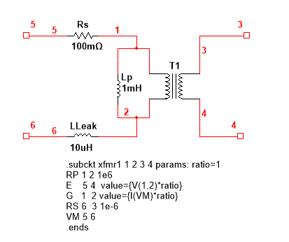

Do you mean this?
I'm afraid I wouldn't know where to start. For one thing, that's a single primary to single secondary. I'm not sure how I'd put a center tap and then add the external components (leakage L, parallel L, series R).

The equivalent circuit in post #880 has some errors, the one in #885 is correct, may be jackinnj will post an equivalent circuit and SPICE code for the tapped transformer later, in any case, it will be much more complicated...Do you mean this?
I could take a readymade simulation and put it to use, but I'm afraid it's far beyond me to take jackinnj's basic transformer circuit and adapt it to be a CT choke.

If it's an ultralinear transformer, you have two such units with their primaries connected in series and their secondaries in parallel. Here's a PP 6Bq5 example. Let's guess that the Z impedances are 4,000 and 8 ohms, for each such that the N ratio is SQRT(Zp/Zs)= 22.3. One primary Ratio is 13.4, the second is 8.9:
