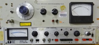

To take it a little further.... I use these oldies but goodies to measure the C of capacitance of semiconductors: It is similar (if not exactly the same equip) used to get the data curves, such as those shown below:
As you can all see, the C drops towards a plateau as the Vds increases and this directly helps with lowering the distortion from those C's. In the example the 2H and 3H drop by 10dB going from 12v to 18v.
However, when the C's are matched the cancelation can be almost total. In fact the 100X more expensive analyzer shows it into its' noise floor.

I sure do love that old equipment! Micro-micro amperes! Wow, sounds like picoamps.
Bob

We have a PAR410 in one of our labs, never used it. I suppose it's designed to measure C-V curves at 1MHz, right?
