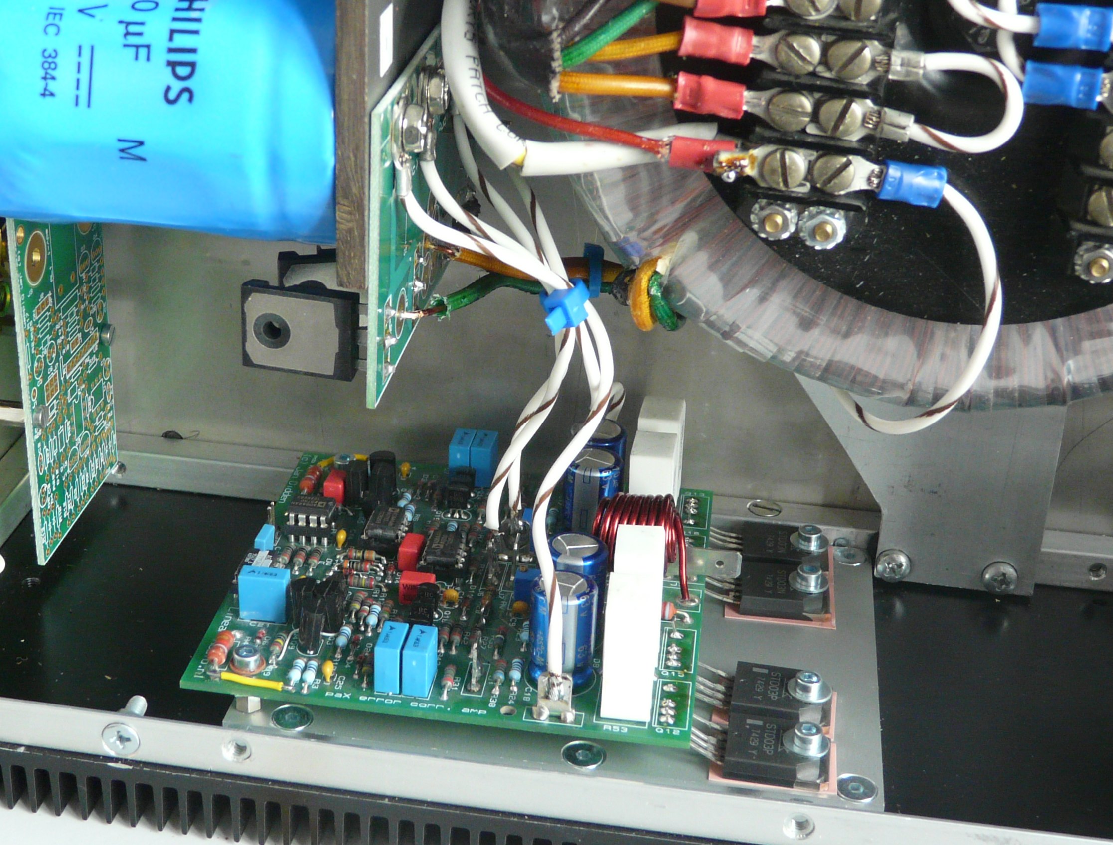

I have concluded that the best engineering solution is to co-locate the filter caps on the same PCB as the amplifier. This way you can keep the tracks short and the radiating area as small as practicable.

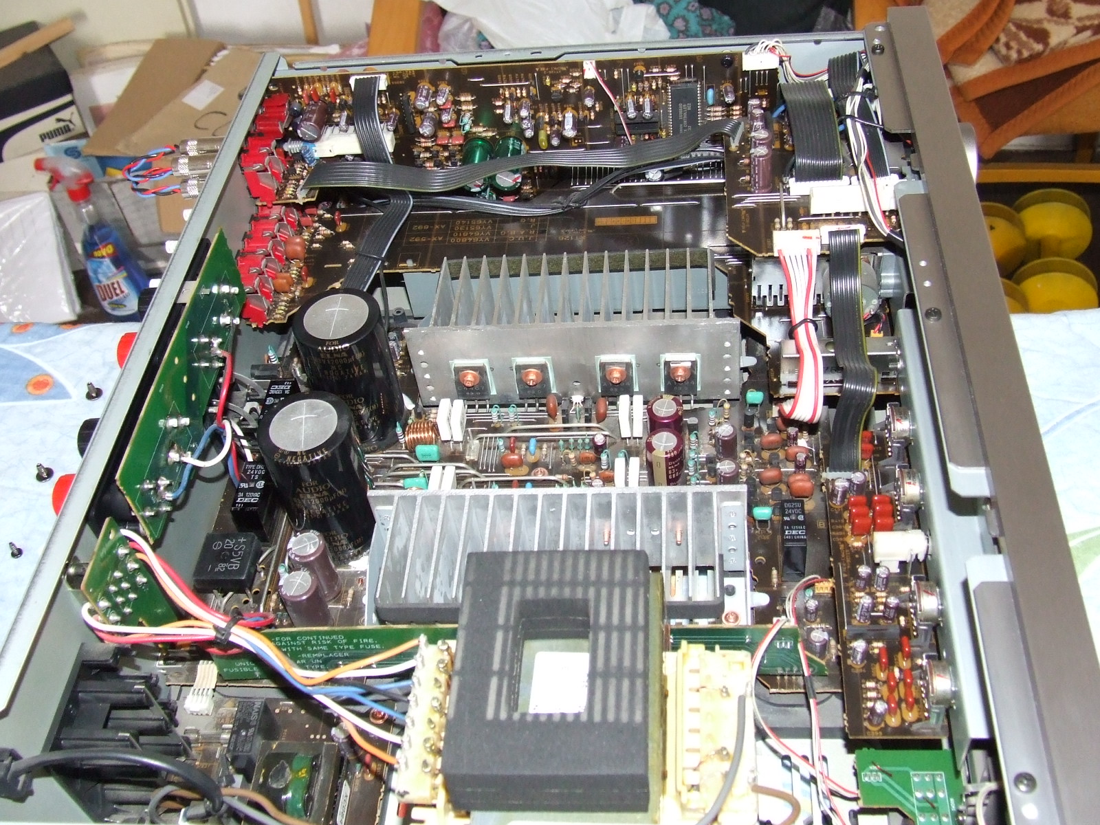

Like the problem is solved in Yamaha AX592 integrated amplifier. Test report quote:
... the A-wtd S/N ratio remains some 10dB ahead of the norm at an incredible 93,7dB....

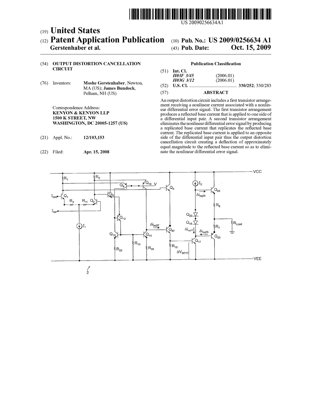

Cancellation techniques are getting a lot of attention now. Here is another circuit topology that is similar to many used for audio but with a cancellation technique added to it:
