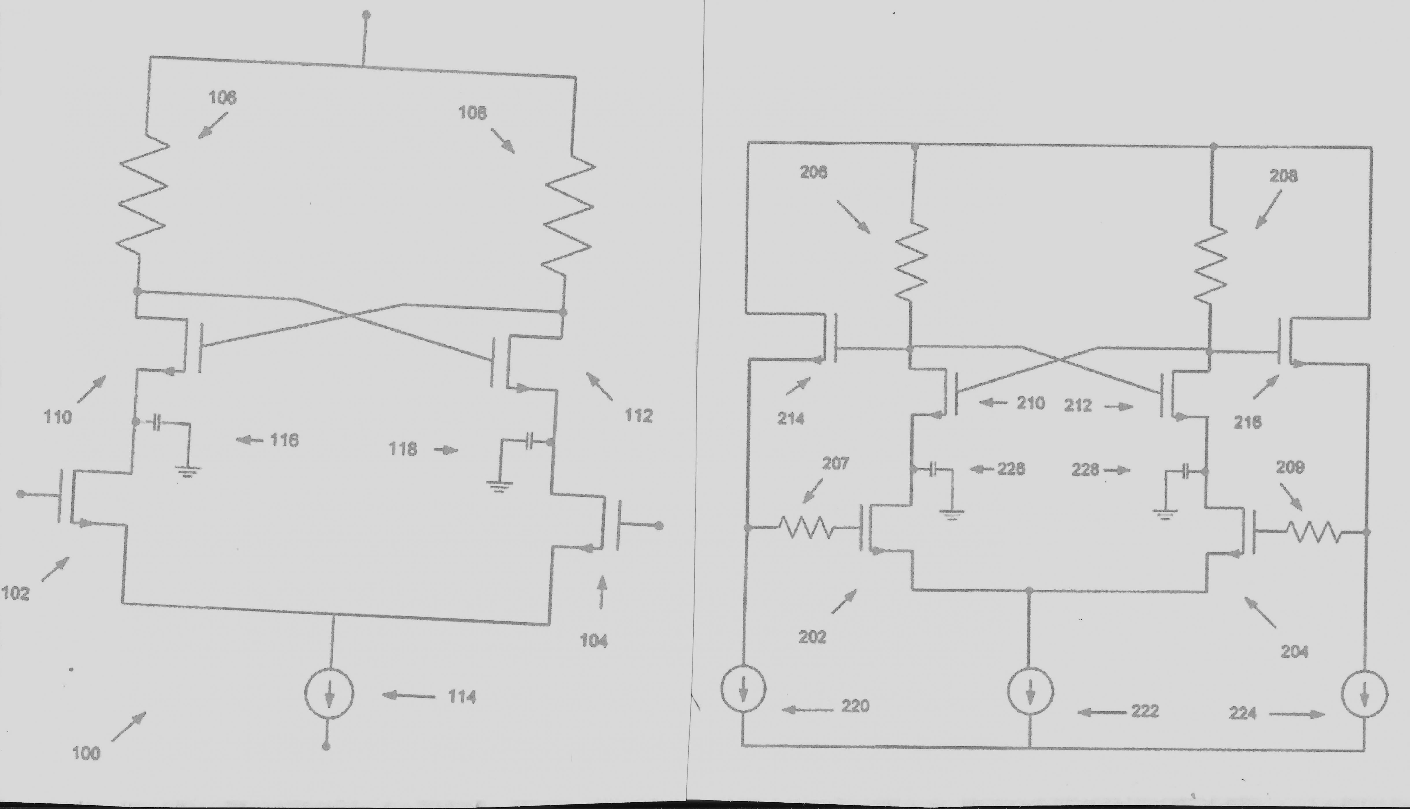

A few more ideas for topologies to cancel the non-linear capacitance that causes so much distotion; though used for increasing speed and BW increase but you can use it for the non-linear C distortion cancelling for lowest Harmonic distortion:

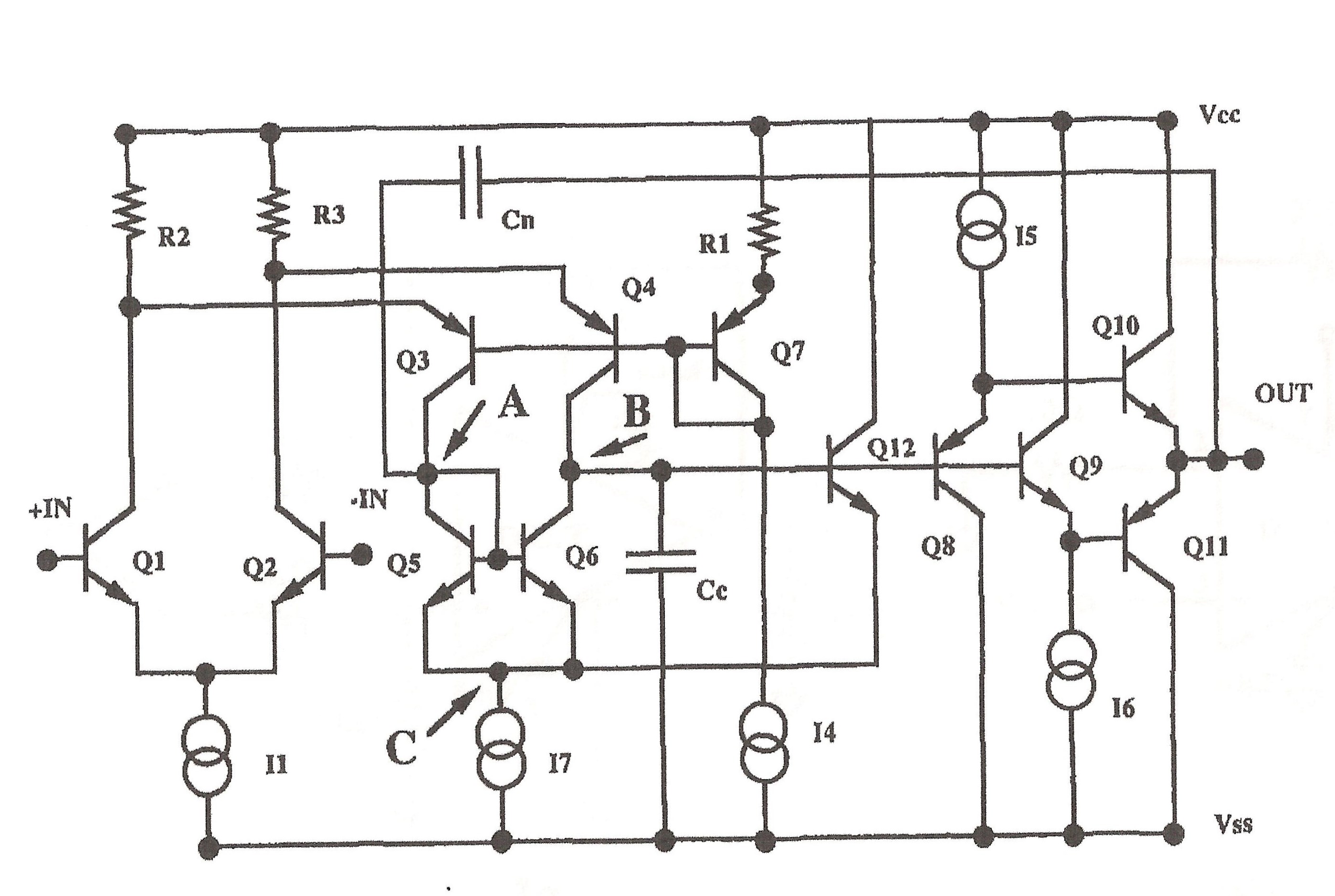

And Scott Wurcer's idea (AES 1992 #3231) for opamp distortion cancelling via Cn.

Scott's looks more like linearizing than canceling. Is there subtle difference?
It interesting that this same non linear functioning is also seen in mechanical valves.

Not this again. 🙂 There's cancellation via displacement current in the capacitors. jcx and PMA have shown a simplified sim several times. The voltage error across the output stage is "s" shaped the derivative gives you crossover "spikes" (the derivative because that is the displacement current in Ccomp that has to be supplied by the input stage when you close the loop). Cn sees only that same error voltage so it's displacement current is only the spike which is injected in the opposite phase into the current mirror so the input stage does not have to. At low to moderate frequencies Cn is bootstrapped by the output stage and technically does not appear in the signal path. We debated whether this was neutralization, positive feedback of -1, etc. At this point in time I'll stick with the pictures.
If Cn goes to ground the displacement currents totally cancel and there is no compensation at all. A portion of Cn to ground cancels part of Ccomp and there is some effective decompensation, this was less useful than hoped. I'm sure there are some of those transitional compensation tricks that could be used with access to the internals.

But just to clarifiy my naive thoughts .. Scott, if this was a power amp, would you take Cn to CLEAN earth? ie the same one used by the feedback network.

I'll resist claiming this is the dual of my 'pure Cherry' mod 🙂The voltage error across the output stage is "s" shaped the derivative gives you crossover "spikes" (the derivative because that is the displacement current in Ccomp that has to be supplied by the input stage when you close the loop). Cn sees only that same error voltage so it's displacement current is only the spike which is injected in the opposite phase into the current mirror so the input stage does not have to. At low to moderate frequencies Cn is bootstrapped by the output stage and technically does not appear in the signal path. We debated whether this was neutralization, positive feedback of -1, etc. At this point in time I'll stick with the pictures.

Richard, in normal operation the Cn samples the voltage across the output stage so its (Cn's) current has the correct (derivative of the voltage error) relationship. Remember to the first order an op-amp's input error signal is in quadrature with the output (d(cos) = sin) the current in Cn is also so 90+90 = 180 or in other words subtraction.

kgrlee said:But just to clarifiy my naive thoughts .. Scott, if this was a power amp, would you take Cc to CLEAN earth? ie the same one used by the feedback network.
.. in normal operation the Cn samples the voltage across the output stage so its (Cn's) current has the correct (derivative of the voltage error) relationship. Remember to the first order an op-amp's input error signal is in quadrature with the output (d(cos) = sin) the current in Cn is also so 90+90 = 180 or in other words subtraction.
Du.uuh! Scott, you've confused my small brain even further. Are we using the same terms for Cn & Cc? In the above pic, Cn is from the output to the current mirror.That comment was for the other Richard who wanted to know about Cn to ground. I leave the VAS/TIS or current feedback semantics alone.
You haven't actually answered my question about whether Cc should be taken to CLEAN earth in a power amplifier .. rather than Vss as in AD797

Sorry if I was confused, yes Cc goes to ground in a discrete amp. Funny, we have op-amps with a Kelvin connection at the output but no op-amps with grounds even though there are compensation schemes that would benefit not being referenced to a supply.
Scott, I have often wondered why op-amps with a ground pin are not more common (in fact as far as I know there's only ever been one integrated op-amp that had a ground pin). As an industry insider I would appreciate your opinion on this. Single internally-compensated op-amps with no offset trimming have three "spare" pins in an 8 pin package so I don't really see what the issue is. Having a ground pin means that the relationship between PSRR and CMRR in "traditional" op amps can be broken.
