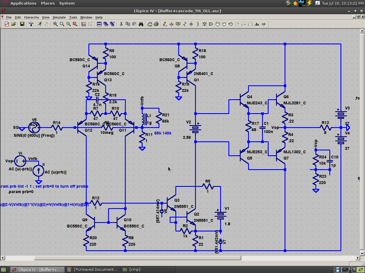

kgrlee, here is my simulation. I did the same thing with an opposite-polarity frontend, and I don't see any strange harmonic cancellation. I do see that the EF reduces THD by ~34db, which is less than the OLG increase of 40db. Notice how few things changed between the schematics.
However, reversing the Hfe mismatch of Cordell's output models I'm able to reduce THD by almost half - most of the reduction in the 2nd harmonic. Just like the extra 5db reduction in THD you see in your plots. Without the enhancer, the effect isn't so large - no because it increases linearity but because the H2 cancellation goes out of tune.

  • You need to be very careful looking at 'Open Loop' gain when you have high degrees of feedback (Loop Gain) I think my 14dB @ 40kHz may be too much let alone your 40dB
  • The output stage hfe mismatch may be your 'missing distortion cancelling factor'. I'm quite aware of this. The final tweak for the original Blameless6 to get 1ppm @ 50W 20kHz (done for the tpc-vs-tmc-vs-pure-cherry) thread was to replace Self's MJE340/350 for Cordell's MJE243/253. In fact replacing just the MJE350 with MJE253 had substantial effect simply cos Bob's MJE350 model has much less hfe than his MJE340. Da CAGs like Bob would say why not just use an evil triple 😱
    But are you saying the enhancer's distortion was doing the cancelling?
  • I'm not sure you've adjusted the current mirror properly for optimum results with the 2 cases too.
BTW, under Tools, LTspice allows you to copy the current screen to the Clipboard without extra clutter.
Can you email me your .ASCs though I can't do anything with them for some time?
I must admit that, philosophically, I don't like to depend on any matching of undesired effects; but maybe I am not giving the possible benefits enough credit.
Bob, I'm generalizing but I think if you want 1ppm @ 50W 20kHz, you need to reduce every single distortion mechanism as you find them.
Where 'distortion cancelling' is useful, is with a lesser target and you have a hair shirt mentality like mine which begrudges extra resistors let alone BJTs 😱
My naive circuits, cos their distortions are predictable and hanging out, are easier to use one mechanism to cancel another. I don't think mismatched output hfe is a 'predictable' though 😡
Bob, I'm being systematically shot down by kean but still fighting. But what's your opinion of evil Ccb in these simple designs? My position is still that its a 'dominant' mechanism 🙂
But what if that internal linearity is improved only by reducing the lowest-order harmonics, like in kgrlee's case?
You'll note that as these examples don't take ANY feedback from the VAS output (ie they follow 'pure Cherry' philosophy) the THD is still mainly lower order even when 2nd/3rd are reduced.
Using evil types of compensation like Plain Miller, MIC, TPC & TMC will increase higher order harms and the residual will be A LOT spikier.

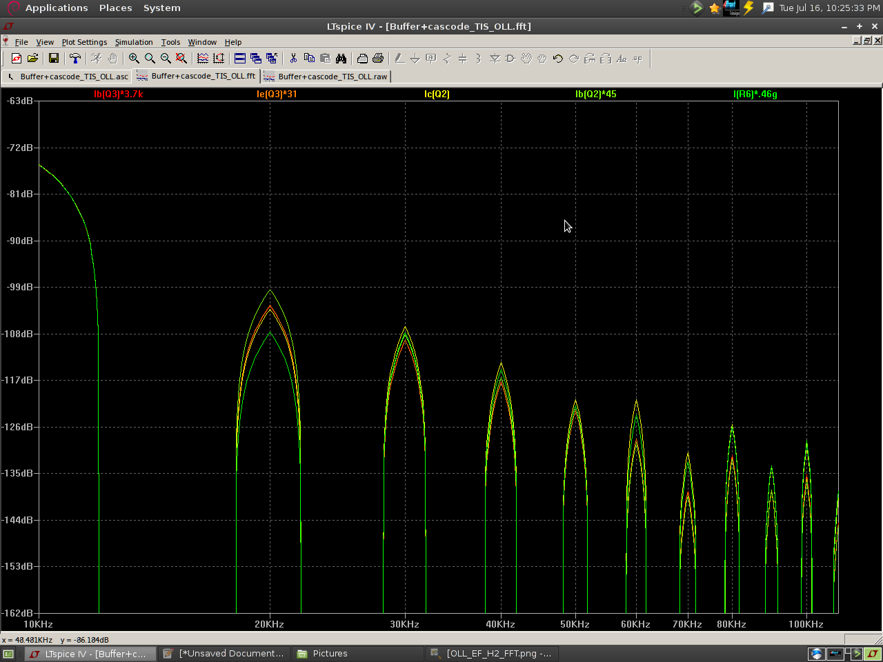

It is actually pretty easy to compare FFTs of the stages to see exactly where the cancellation occurs. Here we can see that the cancellation is a combined effect of the current mirror and R2. I had suspected the current mirror was responsible in part, but I didn't know just whether one was dominant or not.
It is easy to see that without making specific investigations, we'll be going around in circles with THD because we're tweaking cancellations of the remaining distortion rather than reducing it altogether.
