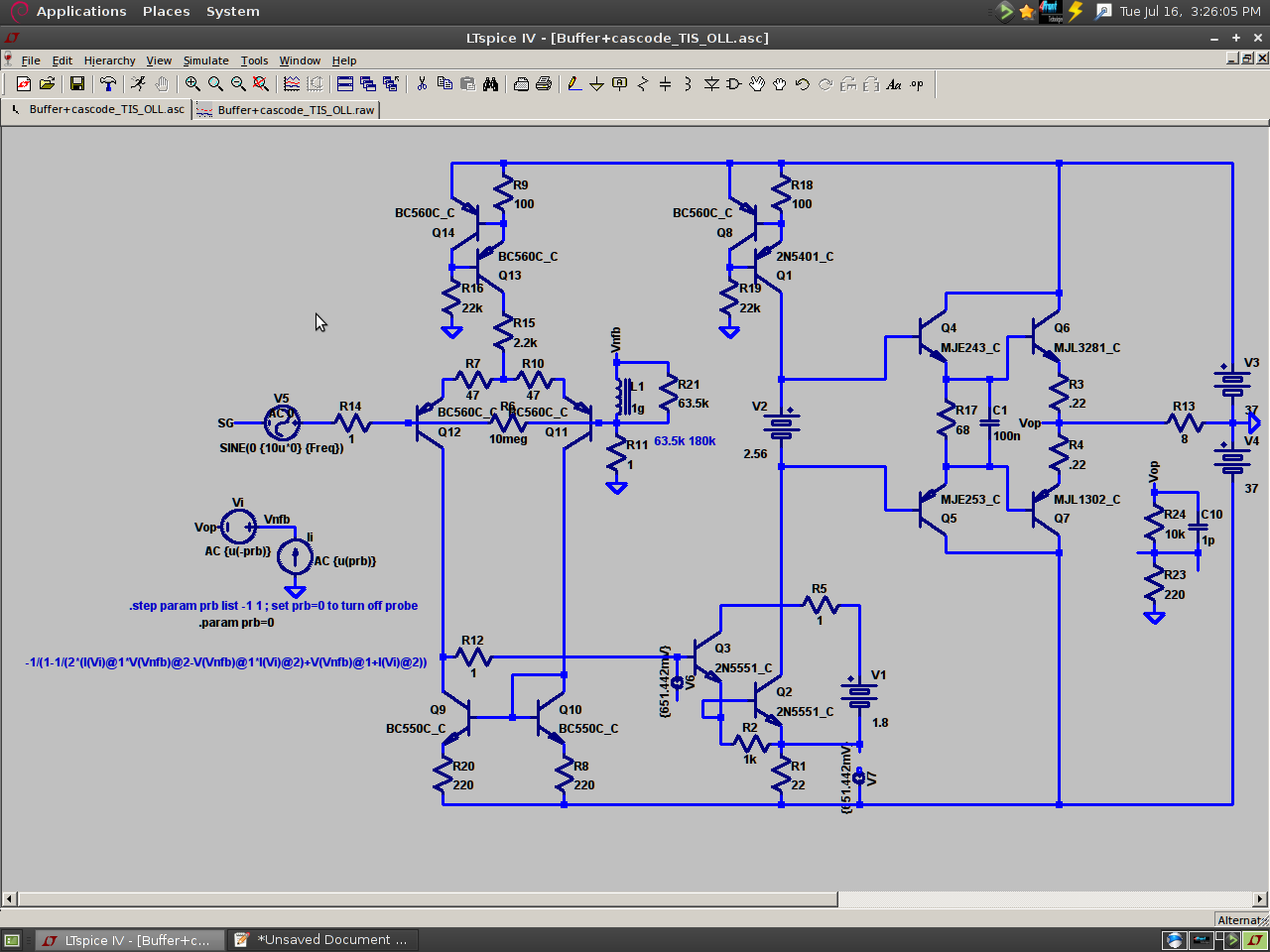

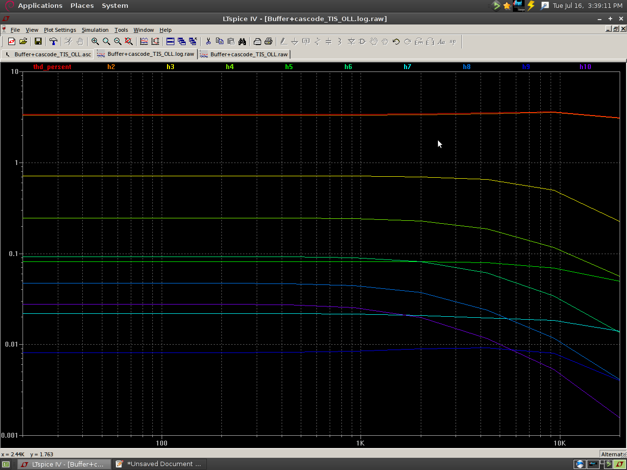

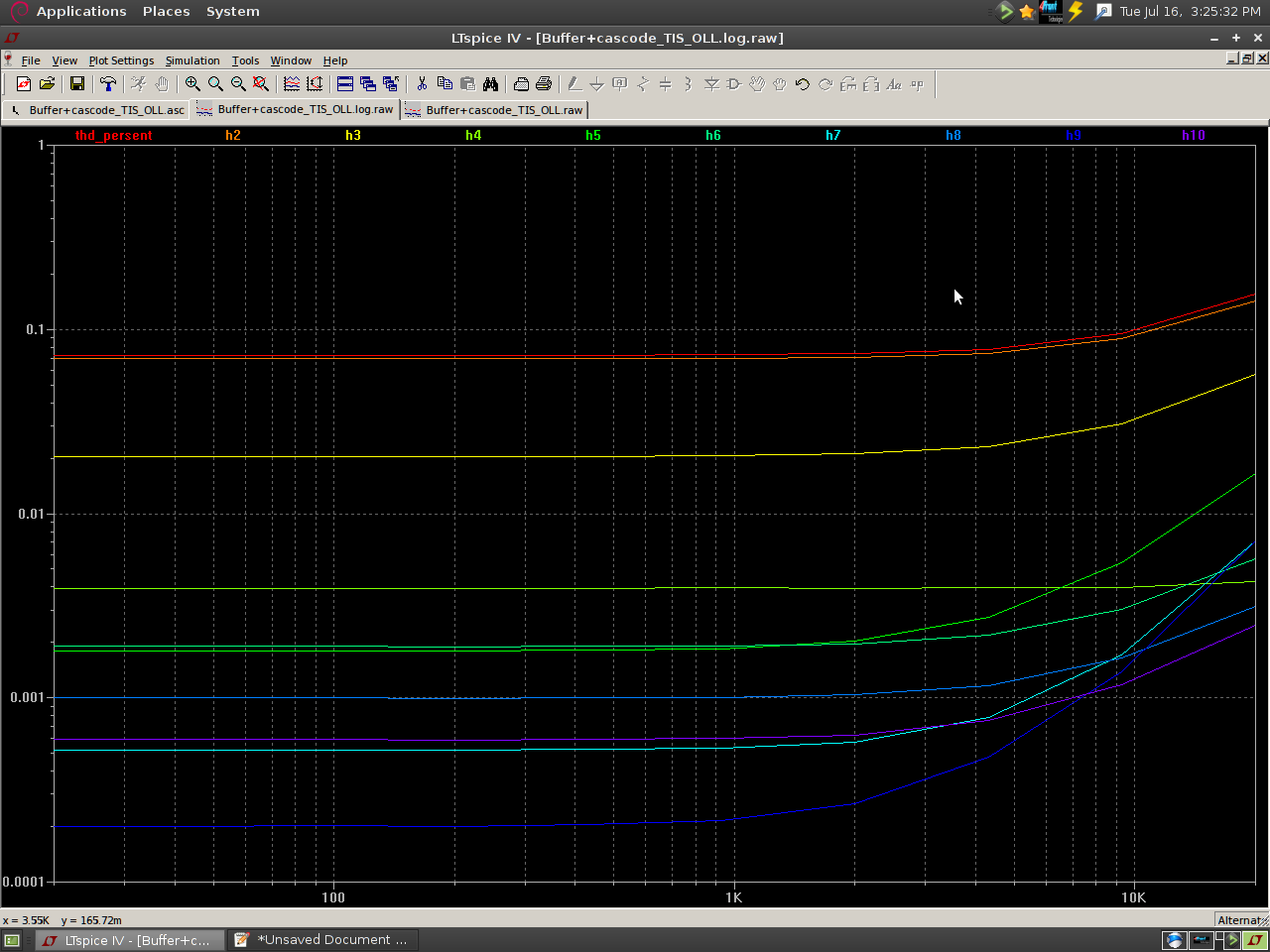

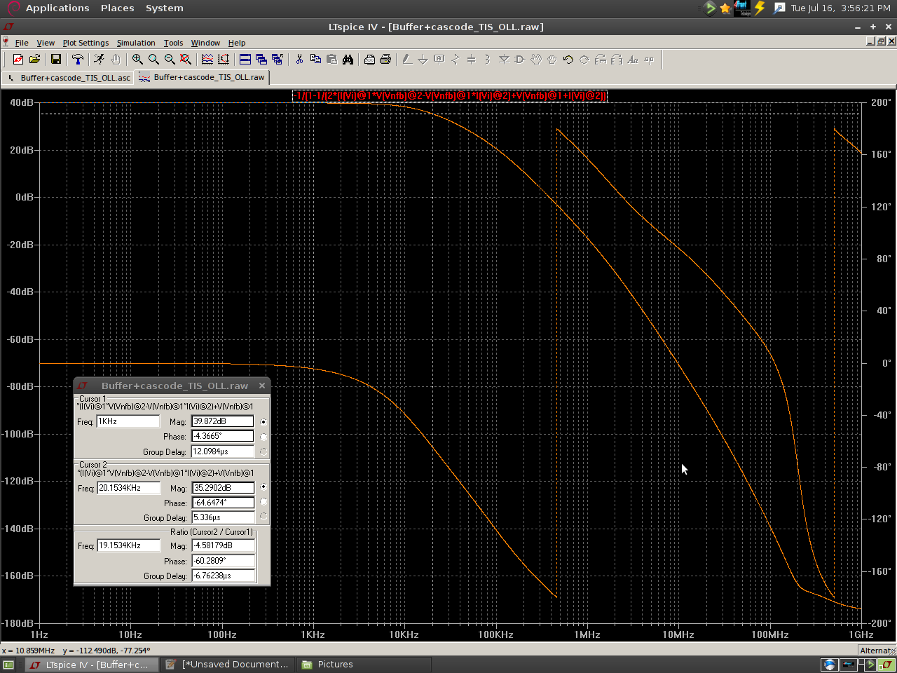

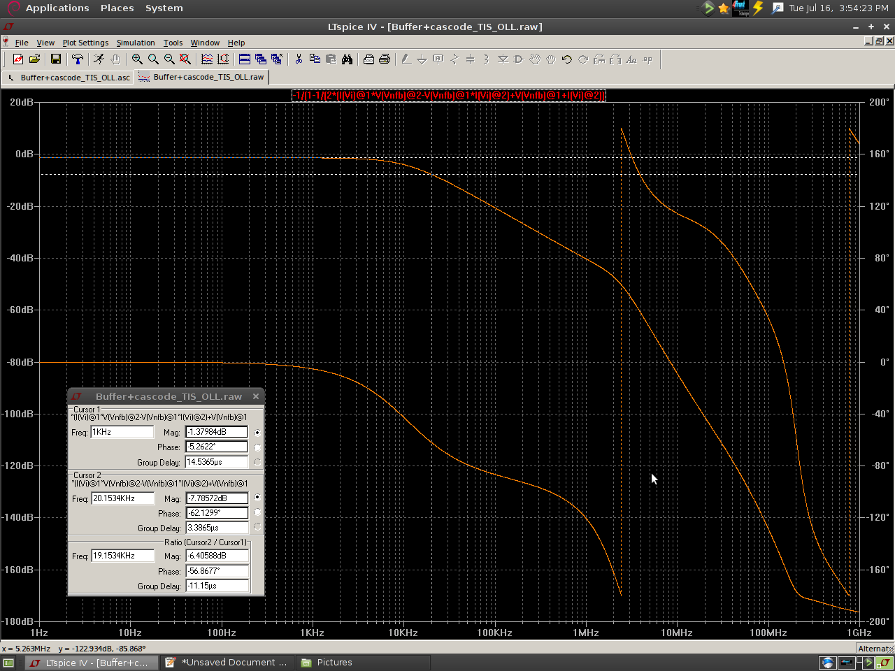

kgrlee, here is my simulation. I did the same thing with an opposite-polarity frontend, and I don't see any strange harmonic cancellation. I do see that the EF reduces THD by ~34db, which is less than the OLG increase of 40db. Notice how few things changed between the schematics.
However, reversing the Hfe mismatch of Cordell's output models I'm able to reduce THD by almost half - most of the reduction in the 2nd harmonic. Just like the extra 5db reduction in THD you see in your plots. Without the enhancer, the effect isn't so large - no because it increases linearity but because the H2 cancellation goes out of tune.

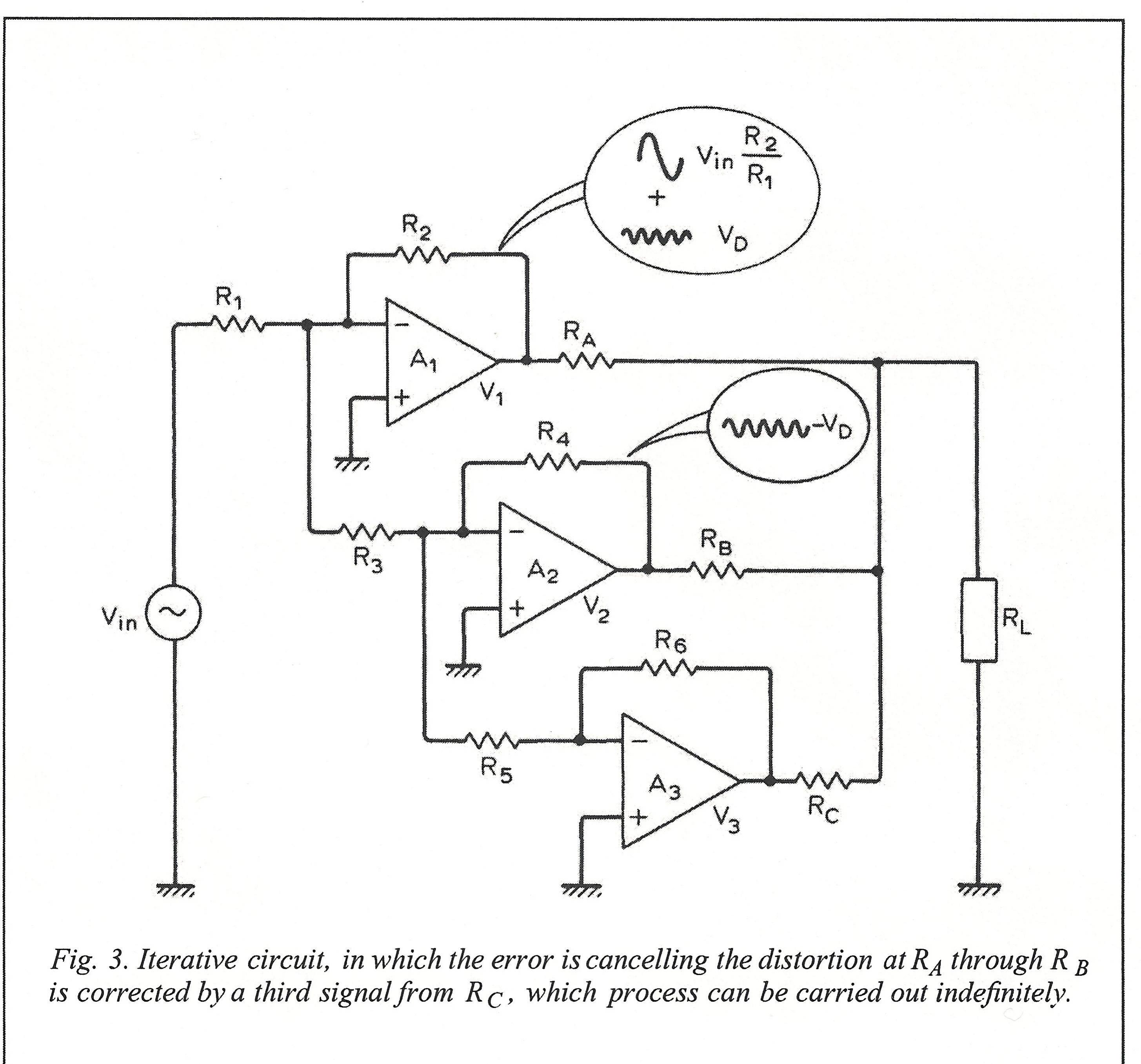

In other words -- what caught my eye was the small debate here about reducing THD via more linearization vs cancellation and dont they mean the same thing.
Cascoding minimizes the distortion, it doesnt cancel it. Negative fb minimizes the THD. But, cancel means to me -- null to zero or into the noise floor. Before I drop it altogether here.... is there a method to null/cancel THD to zero over a broad range of volts and freqs? I have only seen a couple concepts about this approach so far.
Another way instead of stage by stage approach: Maybe this will wet someone's appitite in the cancellation approach and have this lead to something else -->
Thx-RNMarsh
Most of the types of cancellation available to us in a power amp only correct the 2nd or 3rd harmonic - leaving the higher order harmonics as they are. Feedback on the other hand can reduce all harmonics - although this is not necessarily so simple.
