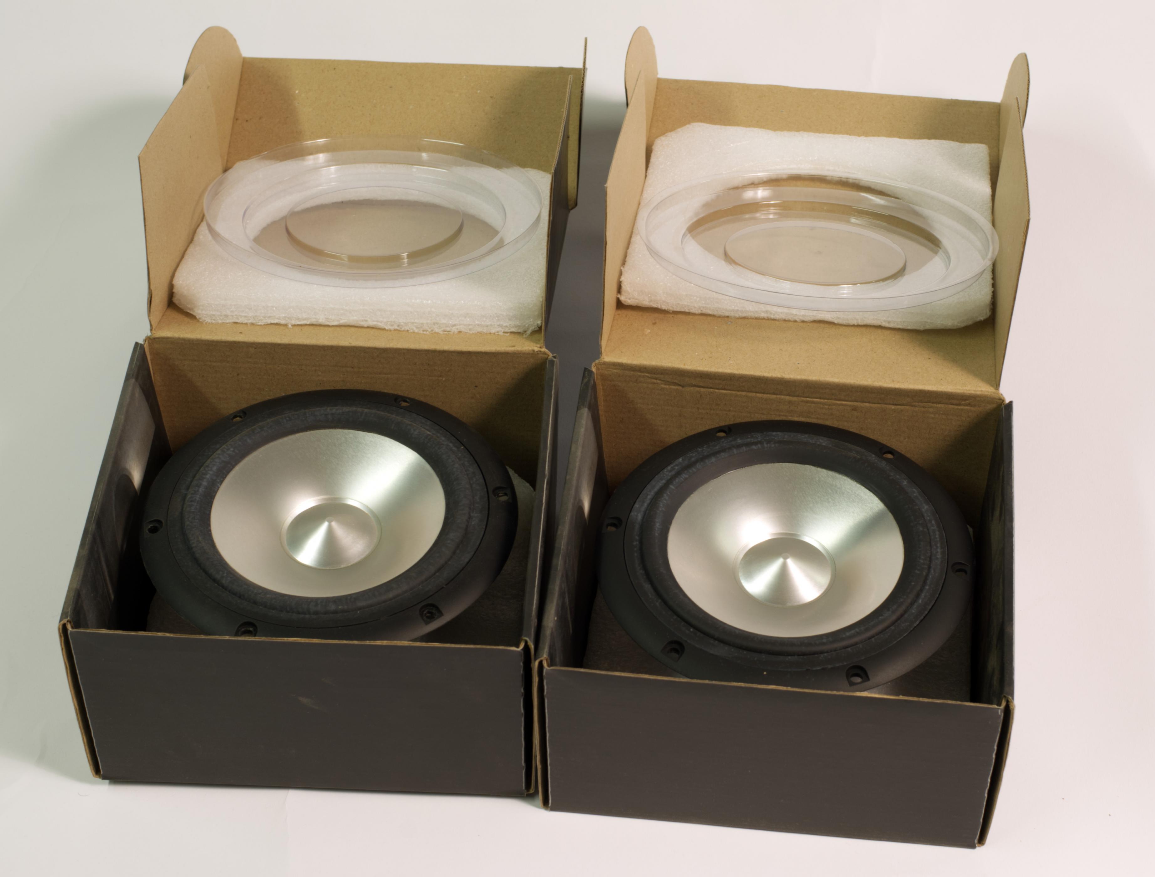

Recommendation for a good mid range driver for vocal
I just completed my first project with a 2 way bookshelf speaker using the Tang Band W6-1721 6-1/2" Underhung Midbass Driver and the HiVi RT1.3WE Isodynamic Tweeter. The crossover is around 2.3kHz.
The bass is pretty impressive coming from a 6.5" woofer and if the listening room is not big, you can actually do without a sub-woofer. The high coming from the HiVi is pretty accurate and detail, good for instrumental music. However I find the mid range is somehow lacking, especially in term of vocal. The vocal sounded lay back, not warm sounding and does not have that "thick" texture.
Now I am trying to add on a mid range driver on top of my bookshelf speaker to enhance the vocal section. I would really appreciate if someone can recommend me a good mid range driver that can produce sweet, warm, "thick" and slightly forward sounding vocal. And at the same time not too bright or harsh. Looks forward to your kind recommendation, TIA.
Edit : Of course, I will be redoing my crossover design with the new recommended mid range driver.

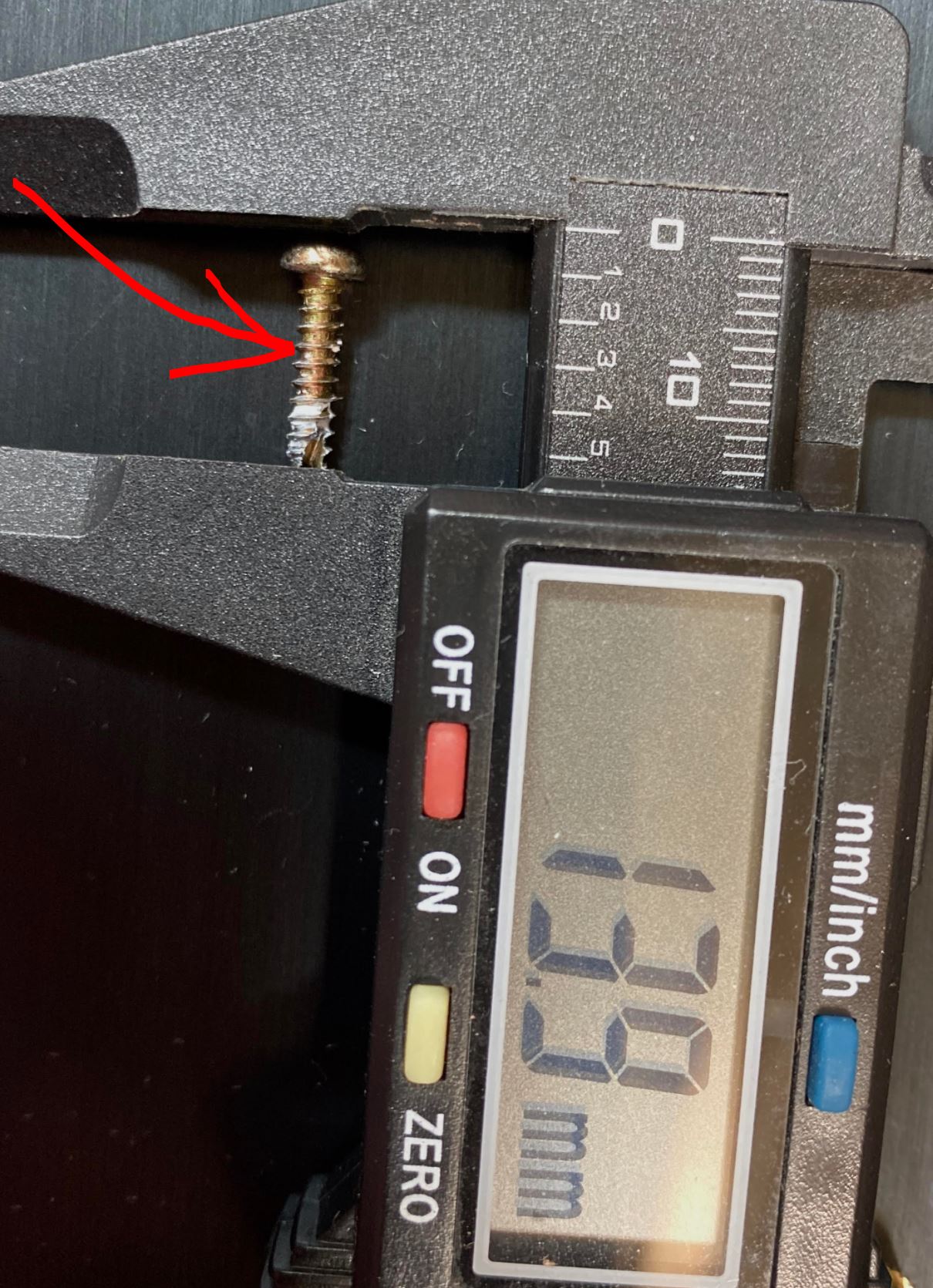

What are these screws called?
What are these screws called and where can I get them? They are used in securing output transistors on heatsinks. They seem much more user friendly than the machine screws i have been using. Those need to be tapped, which sometimes ruins the sink plus takes a long time, These on the other hand are just drill and screw types, no need to tap them ... I know they are self tapping, but what kind or where can I order them?

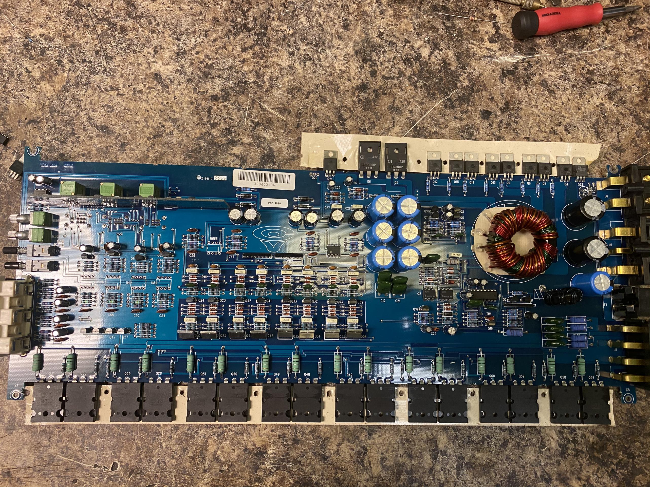

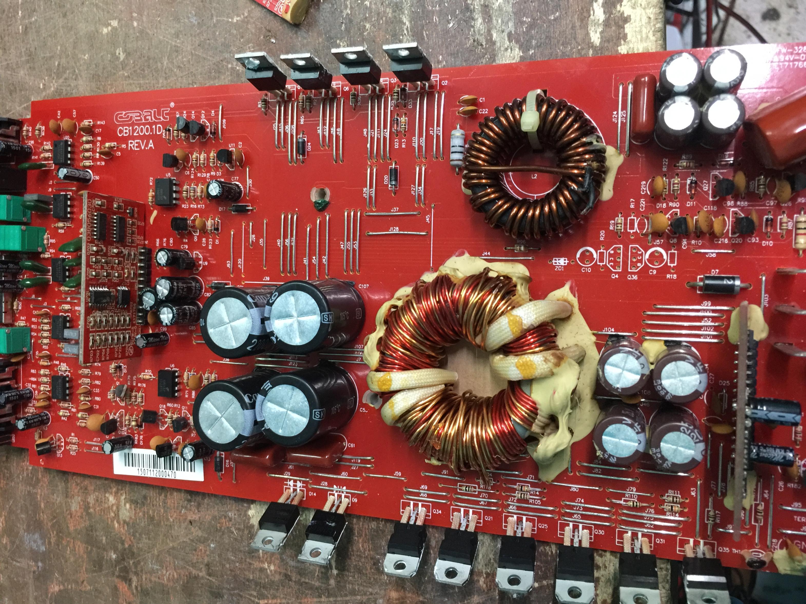

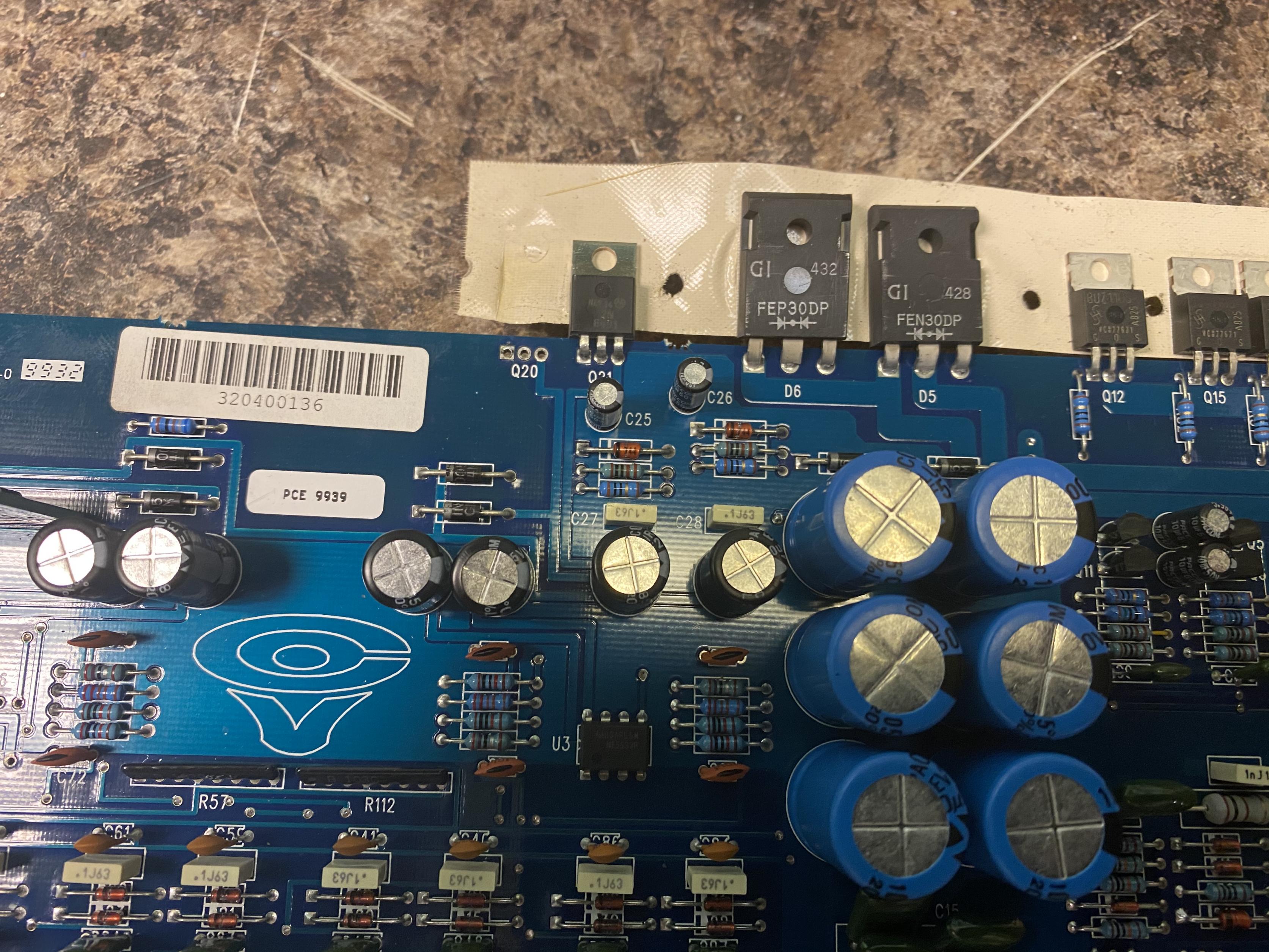

Cerwin Vega Vega 3204
This amp isn’t producing any positive regulated voltage.
I removed the opamps since 1 of them was defective and still couldn’t get the +15 volts .
All opamps for this amp still have voltage on all pads even after they have been removed from the board .
I removed the regulator also and all 3 pads for the regulated have voltage on them .
Any ideas ?

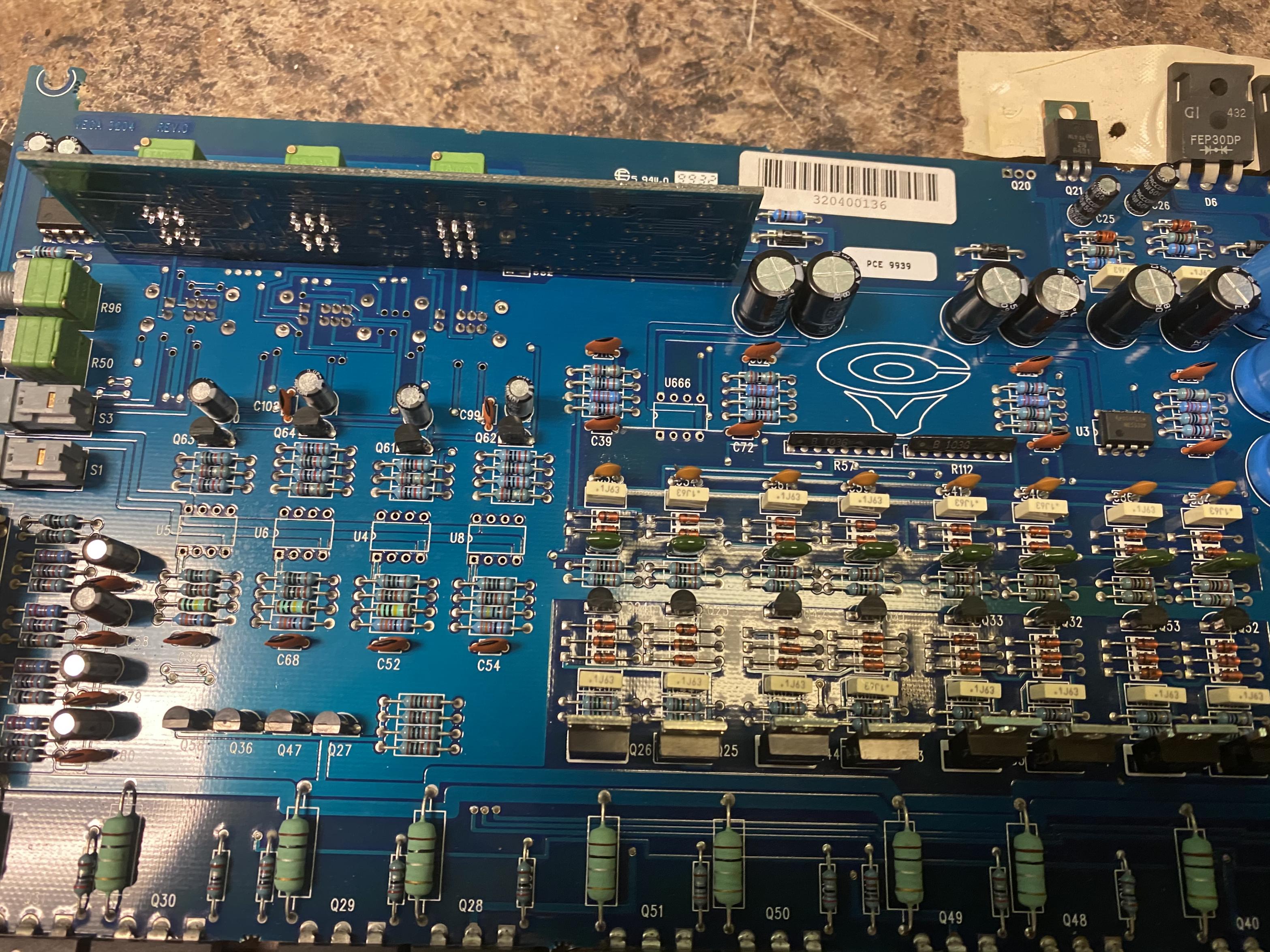

Orion
When a speaker is connected amp will go in and out of protect continuously .signal on the outputs look good.I see 633mv offset on output terminals.
Any suggestions?
What normally goes bad on these driver boards?
So far only thing I find was a bad 5v regulator which supply Voltage to the driver board.

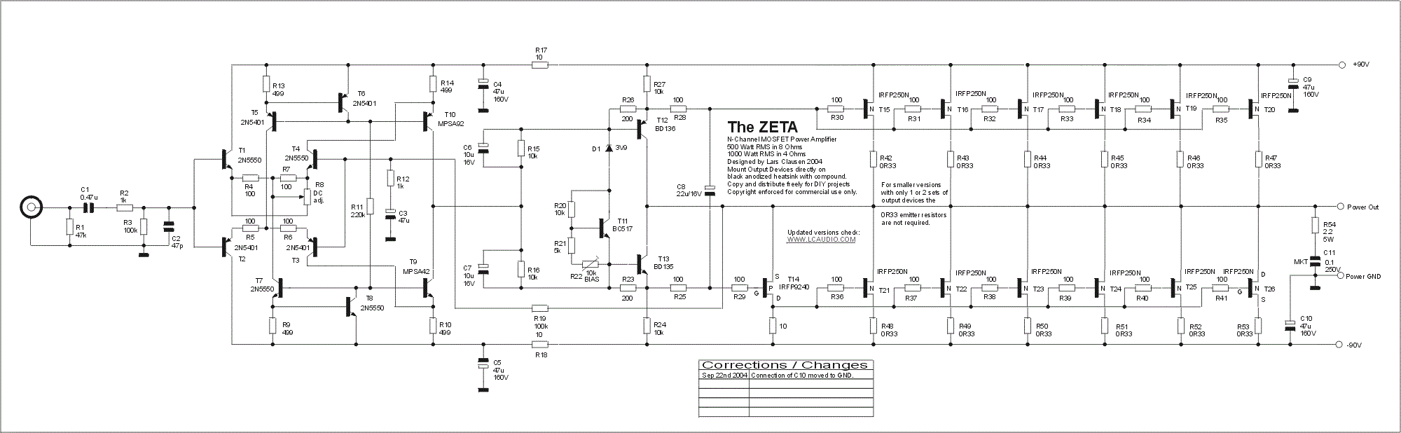

Zeta 2 by Lars
As i felt like a deep unjustice to not even mention Lars's old design once in a decade, I start this topic with its schematic as it was once published on Olive audio.
It was the first high power amp i built, even modified it for use with complementary fets which is simply done by removing t14 and r29 and replacing all n channel tarnsistors with P channel ones, reversing the source resistors place of course .It worked flawlesly on a pcb i'd be ashamed to post...At the time there were the Holton amps in vogue, but having built both i was convinced that Lars's Zeta was the better one. it worked very well from +-90v to +-9 v .using only one pair of transistors and +-35v supply makes for a very good home amplifier .
As i don't find any explicit ban for posting its schematic anywhere i'll do it.

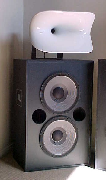

JBL Speakers
Hi, I have recently come across a set of JBL 55VX speakers, the cabinets and tweeters seem to be in very good condition, however the woofers have the usual surround rot and need replacing. My question is how do I get these out? The plastic surround covering the screws seems to be very firmly attached and I do not want to damage it or the front of the speaker.
Thanks.

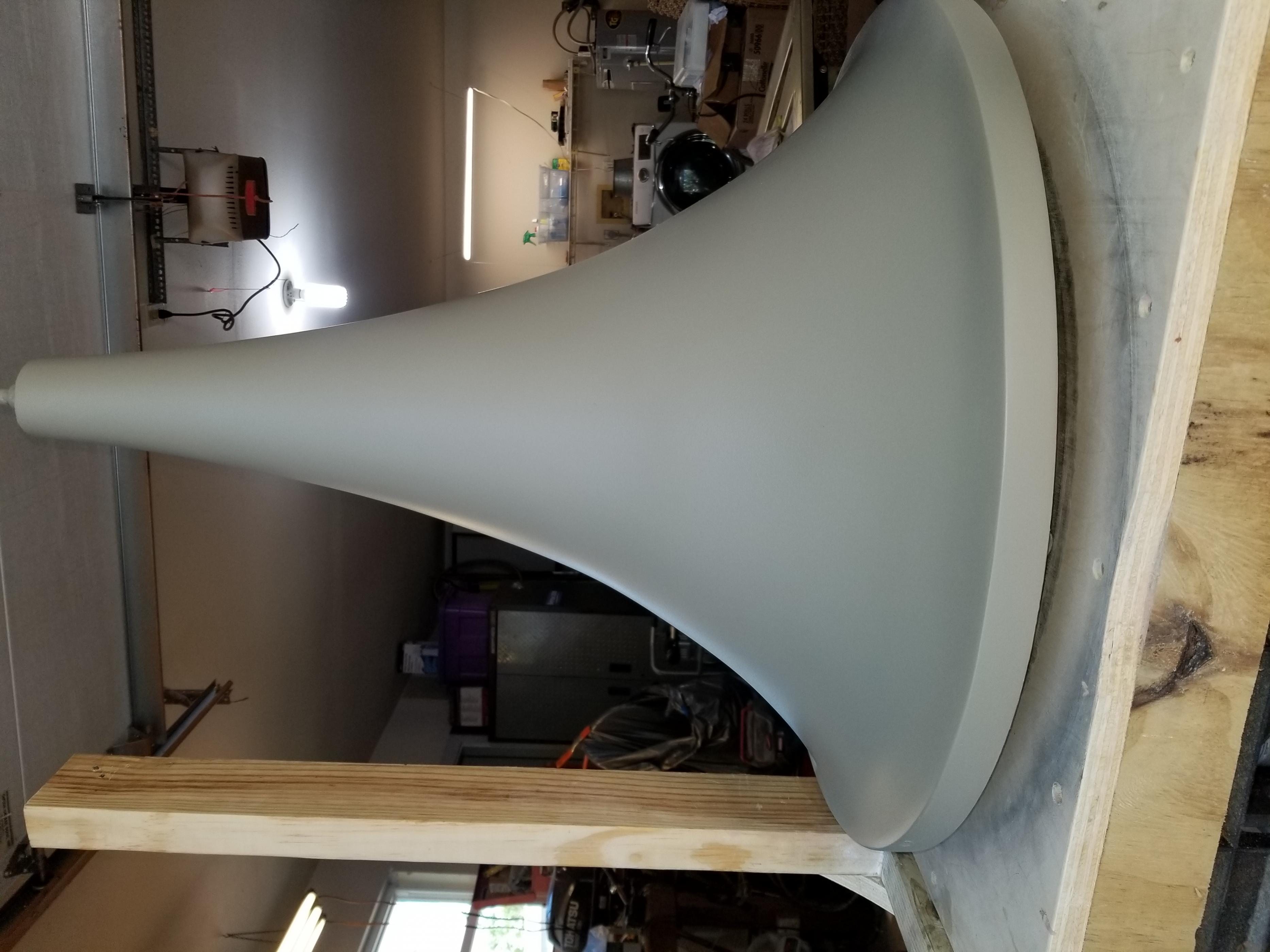

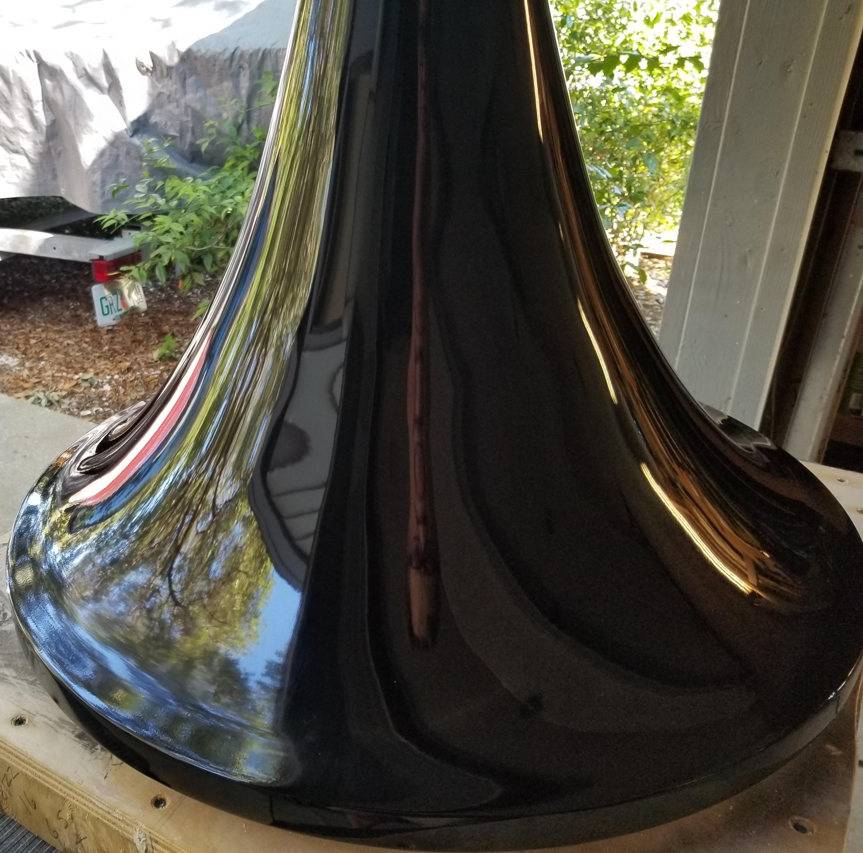

Tractrix Horn Mold
I used Tractrix _V1.4b to design a 185 Hz horn using Inlow sounds .inlowsound.com method of making a mold and building the cones out of paper mache. I am not connected to them in any sense. I have never communicated with him either. Although it probably would have been a good idea. I am just about to finish and pull the second horn off the mold. I do not have storage space for the mold and am willing to make someone a terrific deal. It has a 55mm mouth and is approximately 24" high and diameter. I have not progressed to the point where I can say how it sounds, and am about deaf so don't ask. I am using Dynaudio D54af for drivers but a low frequency 2" compression driver would be better. I hate to take a hammer to my covid 19 lock down work, but it has to go soon. I have learned a few things and can pass that along as well. I am located on the Southwest coast of Florida.

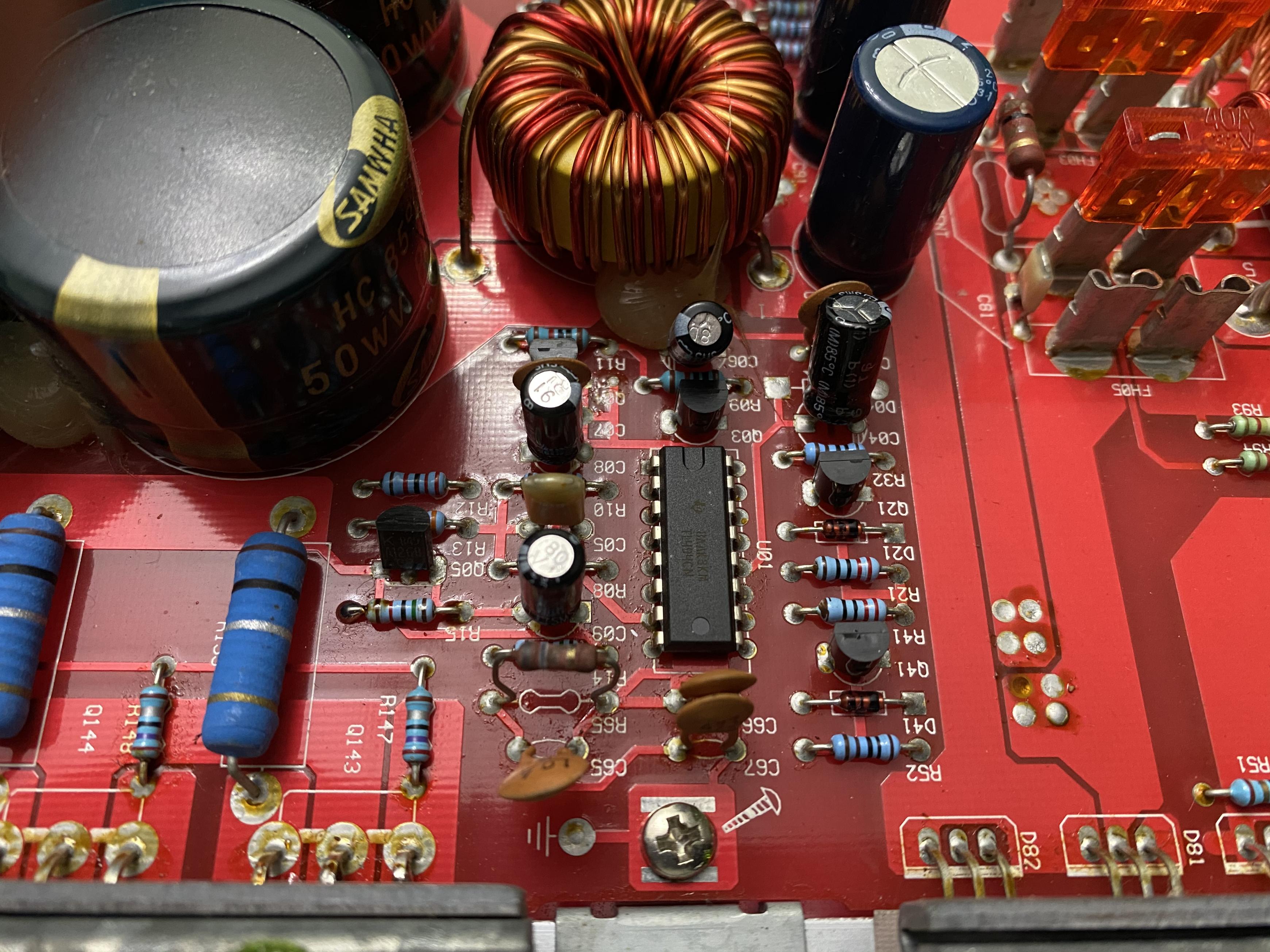

Looking for suggestions to improve sound of t.amp 1050
I have this t.amp 1050 (380W / 8Ohm) specified cheap PA amp. I guess it is a copy of a copy .... and there are many similar amps around, I have attached a schematic I found. I would like to reuse at least the case and the transformer, but I need much better sound 🙂, it should be transferred into a good sounding amp for HiFi.
Do you have any suggestions/schematics for me how to modify it ?
p.s.: I think it needs more than another opamp...

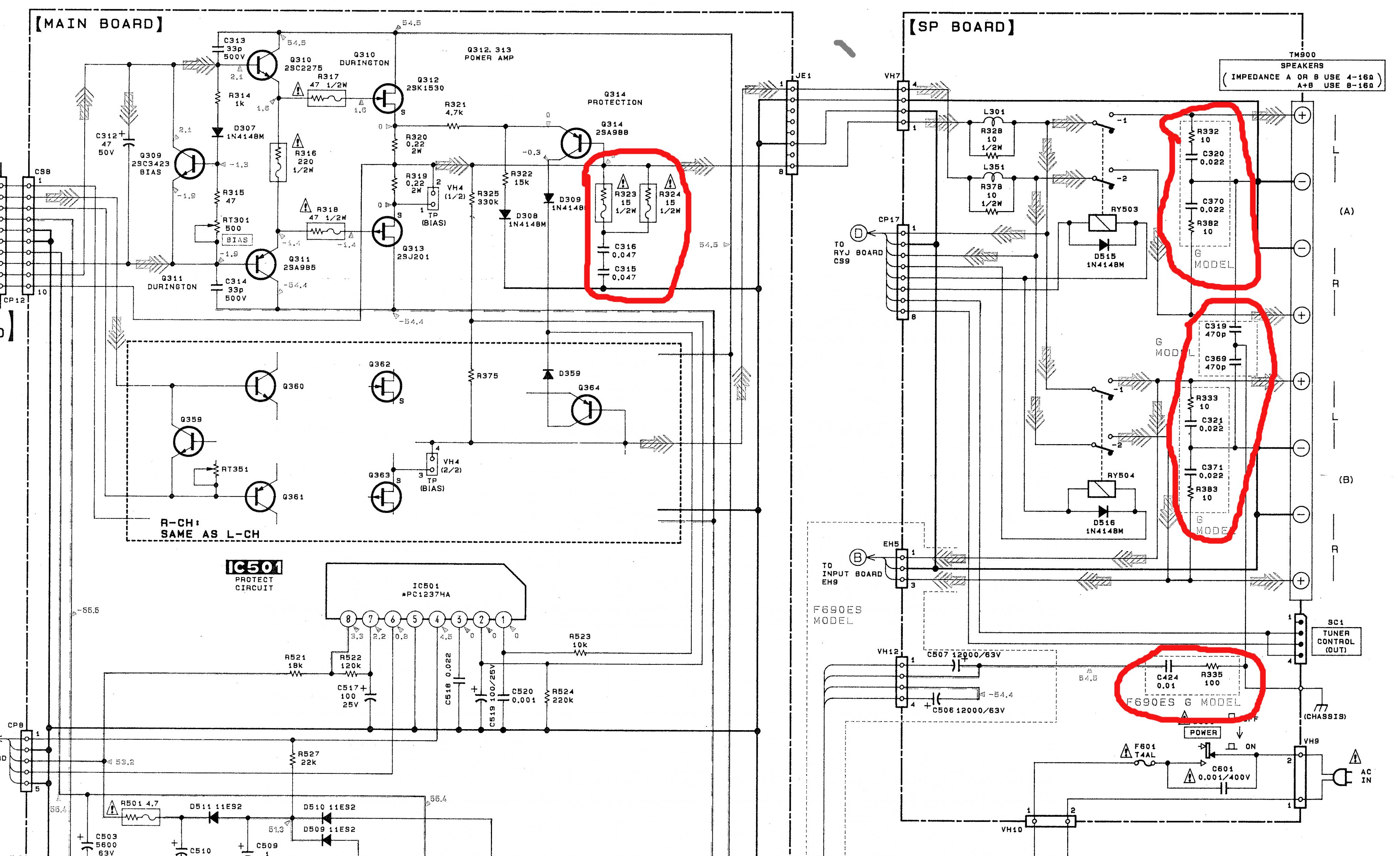

Sharp /Optotronica Amplifier
Hi Guys,
I am repairing a Optronica Amplifier SM-1616
it has a 60w Dual amplifier output on it S60w Output IC
the pre driver BJT transistors are Blown i cant seem to find a replacement for them the originals no longer are availble
2SC1628YL & 2SA818YL
i think i can use the following but not 100% certain
KSA1381ESTU & KSC3503DSTU
can someone please point me in the correct Transistor to use as a replacement that will be compatable for this
Thankyou
Wayne 🙂

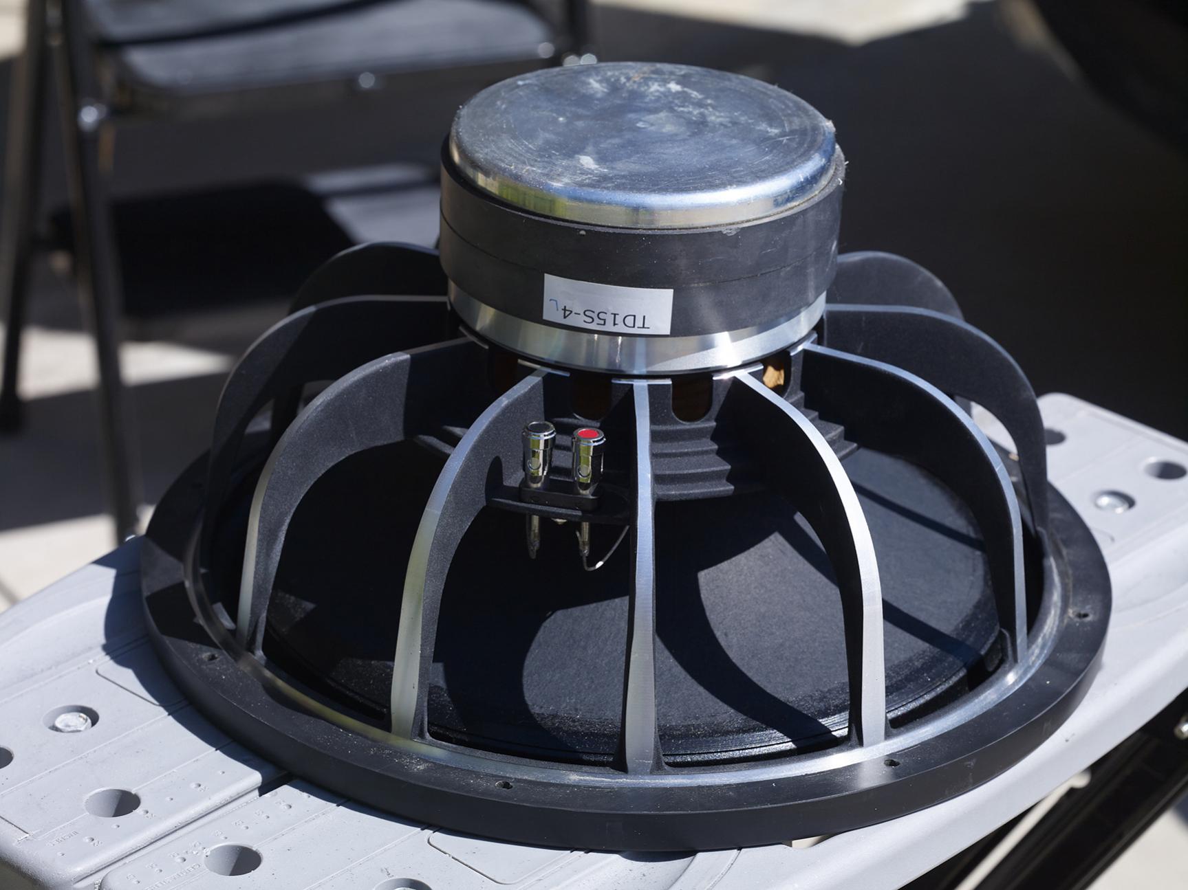

Acoustic Elegance TD15 S bass - woofer, 4 ohms 500W
Offering only 1 bass driver. This is woofer, could be used in many different sealed or vented designs. High excursion, very low distortion. Very little used, purchased new from Acoustic Elegance a few years back. The TD Series woofers are low distortion, high Xmax, wide bandwidth, bass drivers designed for sealed or vented enclosure applications. The TDS use a 2 layer round wire copper coil for higher Qts. They are typically the option chosen for sealed box applications and larger vented box applications. They are often used in larger floor standing speakers. This is heavy driver.
Price $ 350.00 plus shipping
Specs:
TD15S-8ohm
Fs: 22.8Hz
Qms: 3.87
Vas: 467 L
Cms: .45 mm/N
Mms: 108 g
Rms: 4 kg/S
Xmax: 14 mm(peak)
Xmech: 20 mm(peak)
Sd: 855 sqcm
Vd: 2.4L (p-p)
Qes: .41
Re: 5.3 ohm
Le: .3 mH
Z: 8 ohm
Bl: 14.1 T/m
Pe: 500W (cont.)
Qts: .37
1WSPL: 93.4 dB
2.83V: 95.11 dB
TD15S-4ohm
Fs: 22.8Hz
Qms: 3.87
Vas: 467 L
Cms: .45 mm/N
Mms: 108 g
Rms: 4 kg/S
Xmax: 14 mm(peak)
Xmech: 20 mm(peak)
Sd: 855 sqcm
Vd: 2.4L (p-p)
Qes: .41
Re: 3.5 ohm
Le: .3 mH
Z: 4 ohm
Bl: 11.5 T/m
Pe: 500W (cont.)
Qts: .37
1WSPL: 93.4 dB
2.83V: 96.91 dB
Suggested Enclosures:
3.0-6.0 cubic foot sealed
5.0-8.0 cubic foot vented
