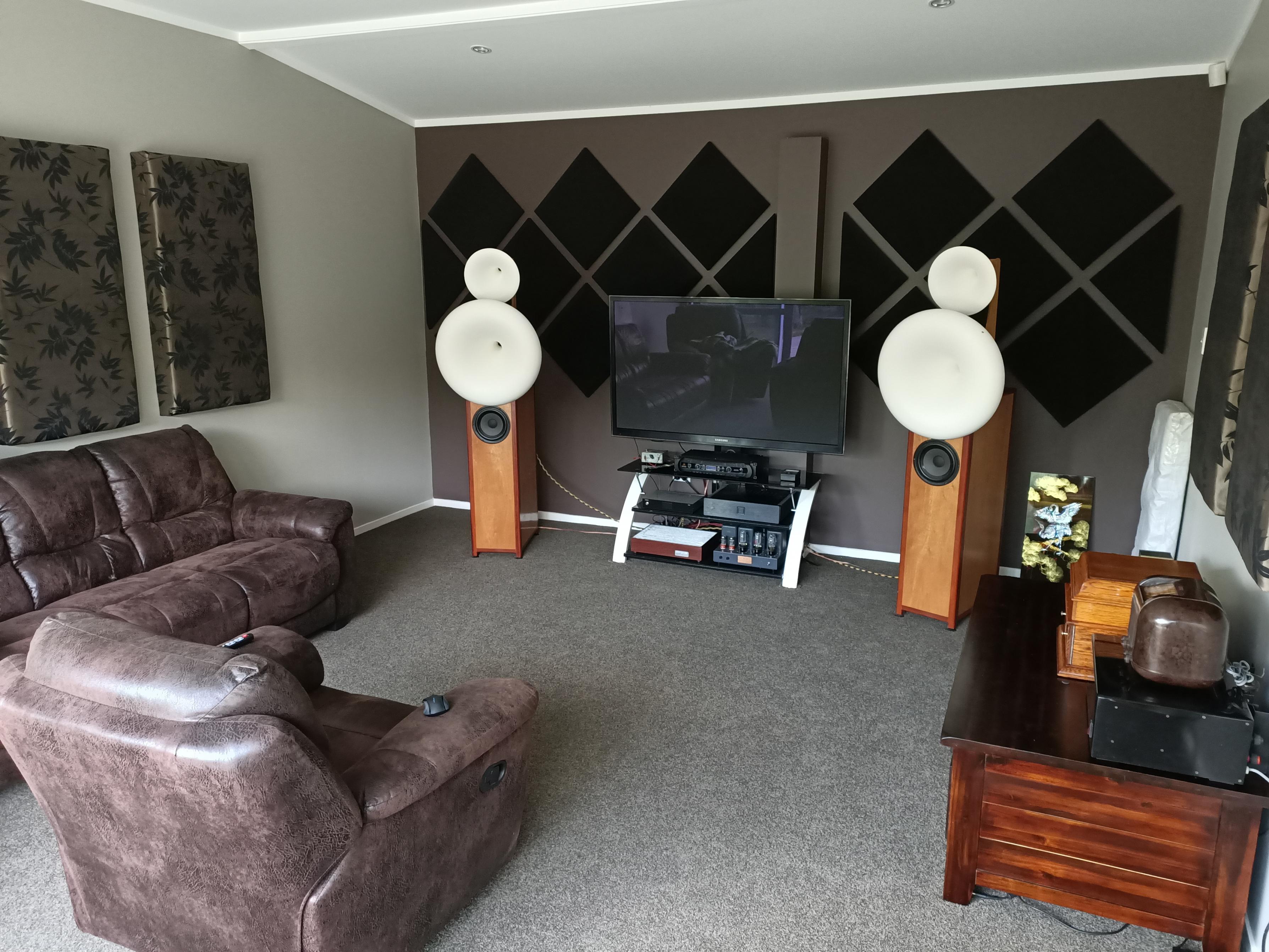

Hi all,
Just thinking about speaker placement in my room…. Did some REW measurements and found all sorts of peaks and troughs when measured at my listening spot which I understand is quite normal. Before I start moving speakers I thought I’d get the thoughts of the learned team.
I set my listening chair 38% from the back wall as 38% from the front wall would never work, the speakers are around 800mm from the front wall and spaced to form an equilateral triangle. This was based on what an ideal room should look like (from my reading that is).
Is it worth moving the speakers to try and get a better (Flatter) response? If I move things around I get away from the rules. The room is 4.5mts x 5.7mtrs so not a big room by any means. I found once I eq’d a couple of the low freq peaks down a bit things sounded better, as can be expected bumping up the troughs didn’t do much.
Or……. As it sound really nice leave it and enjoy?

Give it a month, and if you still have the urge to experiment,
mark the floor with tape and see if you can improve on it.
The "rules" are not hard and fast, they are at best "guidelines" and serve only as a starting point... more like a suggestion than anything else.
Remember, you are fitting your gear into your life, not the other way around. I've seen small rooms where the sweet spot is a couch on the back wall with the speakers only inches from the front wall. I've also seen rooms set up the wide way instead of the usual long way. ... you name it, it's been done and with patience almost any arrangement can be made to work.
For moving your speakers... keep in mind that the structure of your room imposes all kinds of screwyness on the sound. Move them an inch one way or the other and you can be sure the treble will change. Plus every room has Modes (sometimes called Nodes) where reflections and echos play terror with the sound. Once again a move of only a couple of inches can change that radically.
Also keep in mind that moving your listening position can make a huge difference too. Shuffling your comfy chair forward and back a few inches can change everything. It is also possible that because of uneven structures in a room, or uneven hearing, the sweet spot we all crave could be a few inches to the left or right of the centre of your speakers.
While evaluating and moving to find the best spot, you should not equalise. The DSP will hide problems that might help you find a better spot. The time to apply DSP or Equalization is once you've got the best spot and still have a problem to deal with.
But mostly keep in mind this one simple fact ... No setup is perfect.
You can get "really darned freaking good" but perfect just won't happen.
do you have absorbers at the first reflection points? That will make a difference as well.
Yes plus front wall.
Rear wall is double glazed sliding door with heavy acoustic curtains covering them.
95% of the time it sounds very, very good but whenever I stumble across a harsh sounding or over bassy recording the brain kicks in and starts thinking about how to fix it. Tone down the HF then other recordings sound dull....
I'm sure you all know what I mean!!
Thanks for your thoughts and yes patience is probably whats called for.

Agreed ... I was just looking at the OP's photo and my thought was to take everything in that room, except the tv stand, and move it about 1 meter closer to the back of the room.
