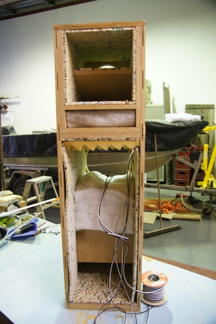

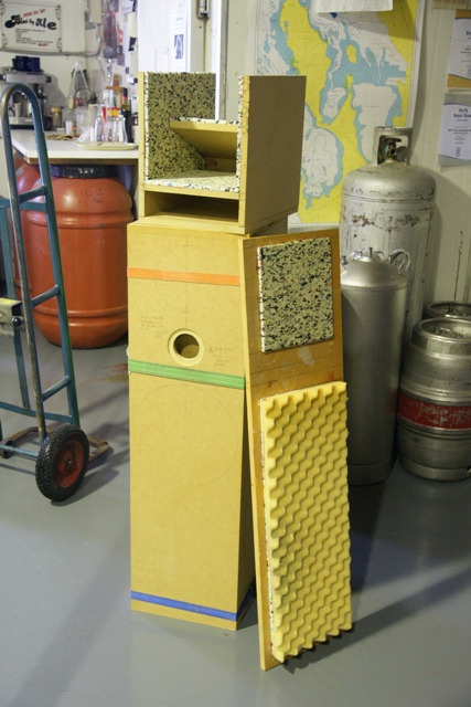

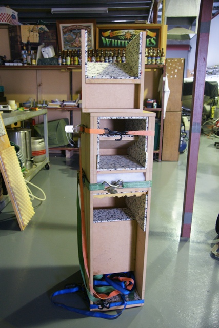

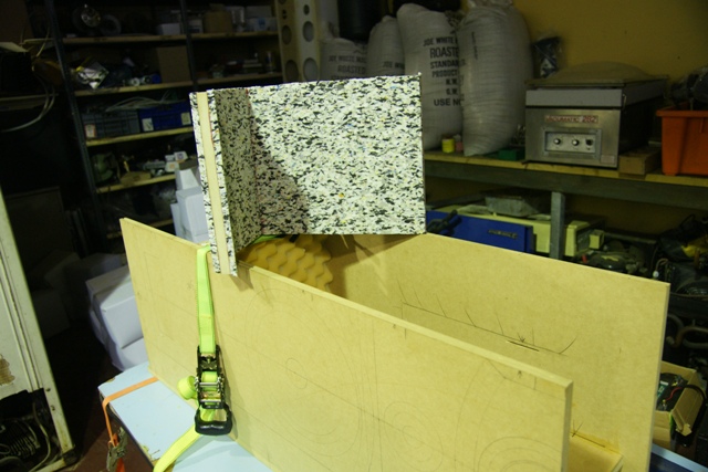

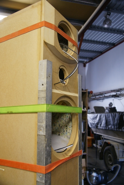

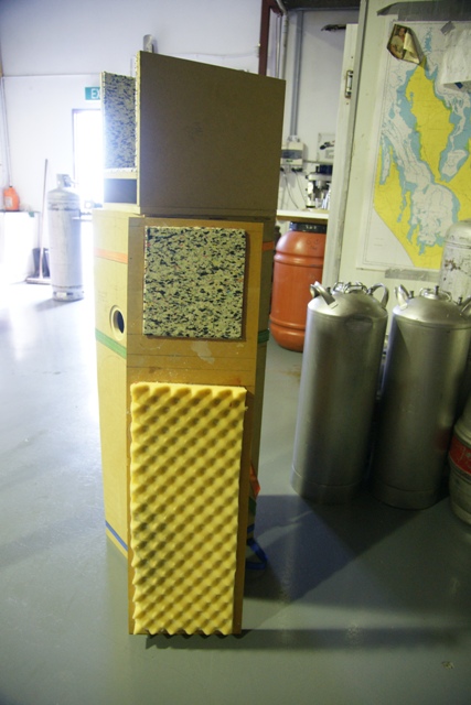

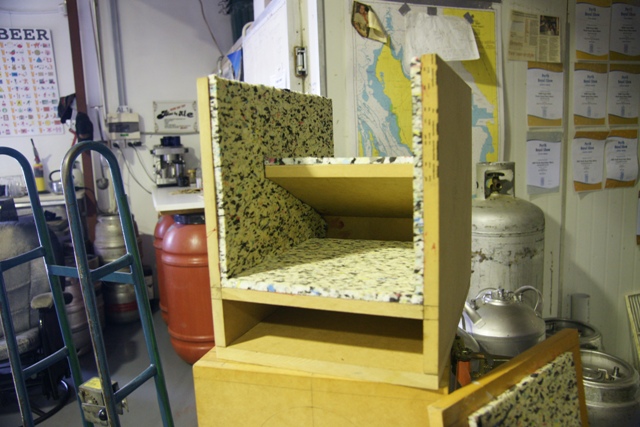

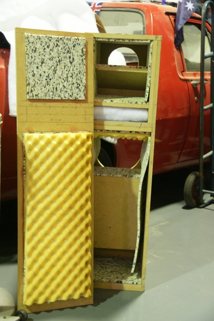

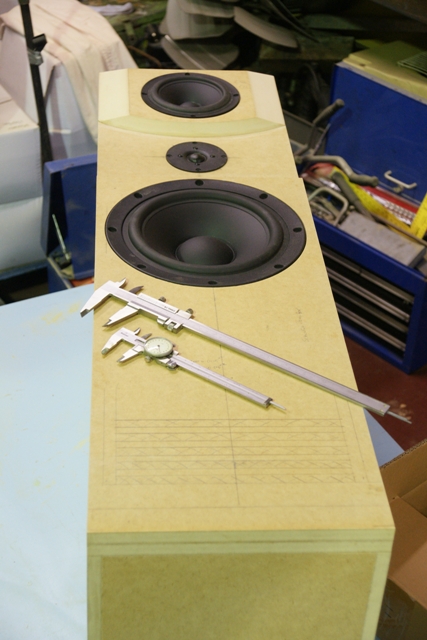

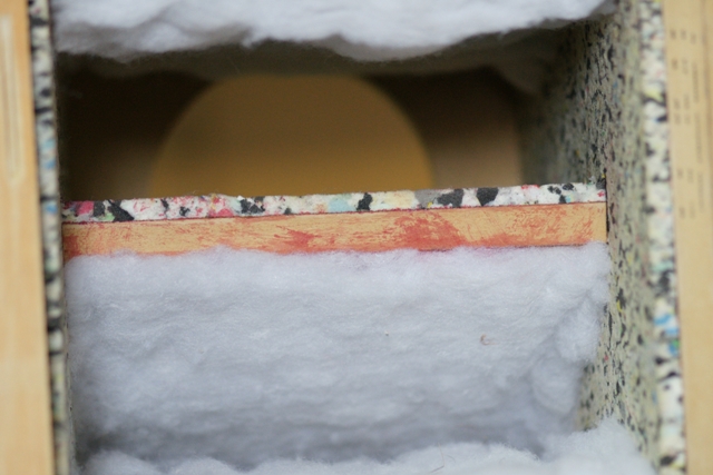

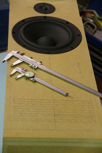

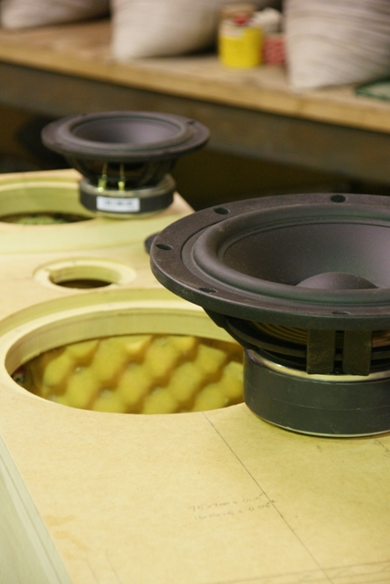

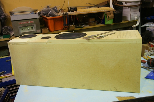

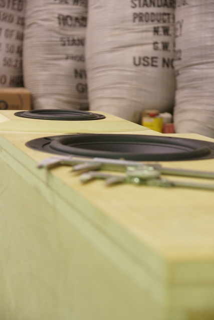

here are some snaps of the project to date
i must say that from looking at the plans that troels as submitted to the current state has taken a lot longer that i had thought it would
also if you dont have good woodworking tools and a workshop i would suggest that maybe another project may suit a first of builder
I have approach the build a little different than the plans in as much as I wanted a common box and not split into two
this has presented a few headaches in getting the mid section built
I sort of thought that when I looked that the module out of the main case it looked like the ships out of starwars dark forces
i have used 16mm mdf for the inner sectoins and walls 18mm for front and back panels doubled on some inside panels and 32mm for the base
also plan to use 32mm for base which will house crossover assemble
I will use 130mm to raise the cabinets not the 60mm that is suggested as my ear hight when seated is around 1030mm from floor level

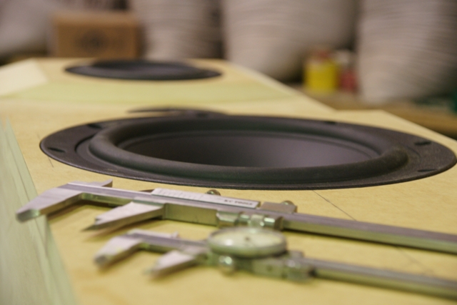

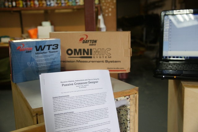

Selectation is SB Acoustics elements for my project
woofer SB29NRX75-6
mid SB17NRXC35-4
tweet SB26STAC-C0004
these have similar T/S to those that are suggested

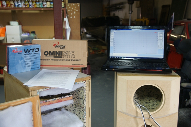

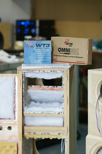

I will take some measurements of the T/S specs using Dayton woofer tester
then use in box measurements from the Dayton omnimic program
final enter into Jeff Bagbys sim program and see what we come up with
i am still a long way off completion but not put off as yet
woofer SB29NRX75-6
mid SB17NRXC35-4

Hi Speedie, I can relate to the getting sidetracked too easily Might explain why a) I have so many projects, and b) why none of them get finished
I'll be interested to hear how this turns out. I've been eyeing off a few of the SB drivers, and was thinking myself about a three way project (yeah another one).
Have you adjusted the cabinet for the SB drivers? I'm guessing the stepping on the original was for time alignment with the specific drivers. I guess SB compared to scanspeak will be likely to have similar geometry considering their links
Tony.

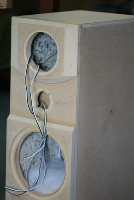

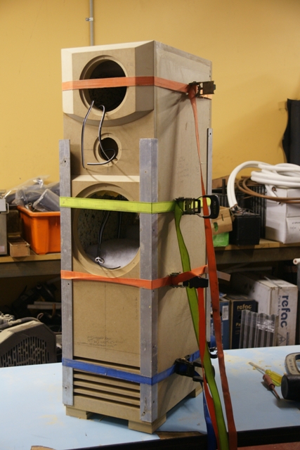

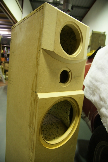

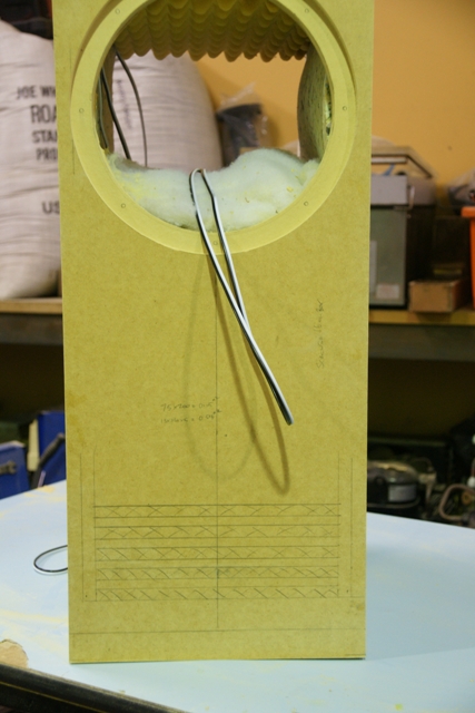

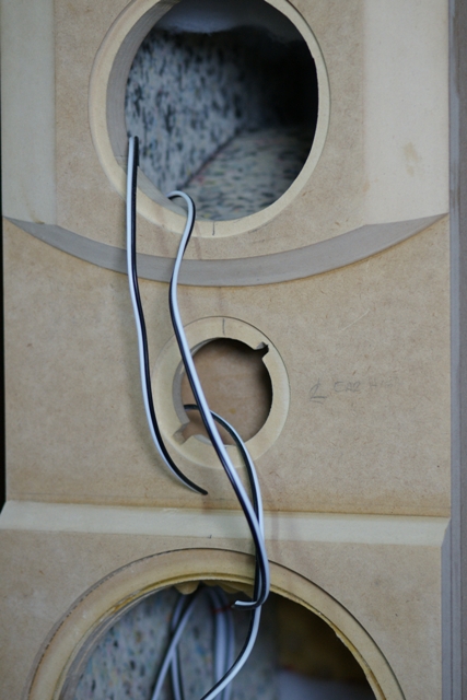

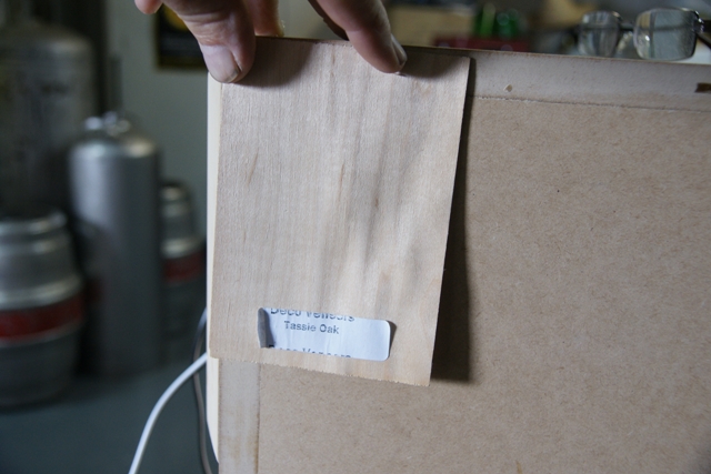

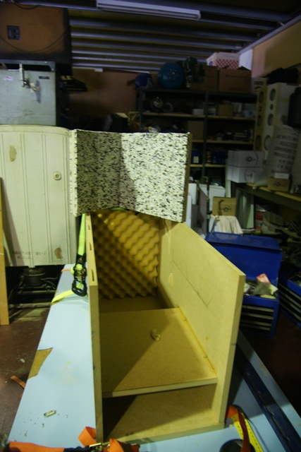

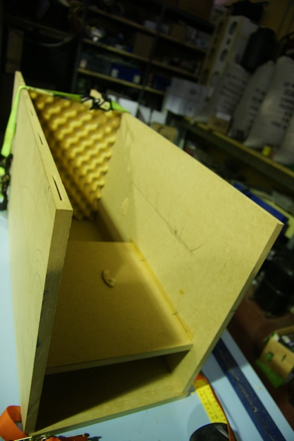

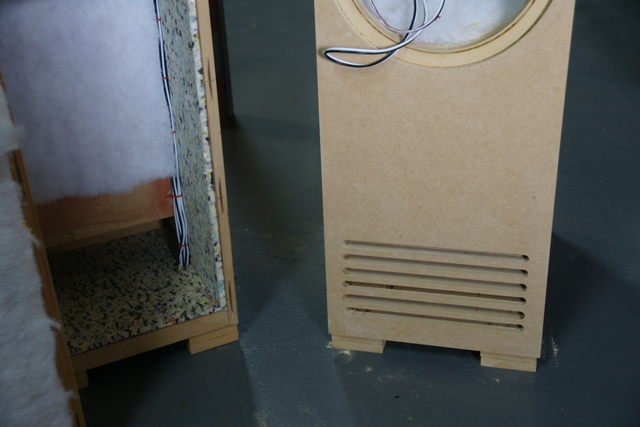

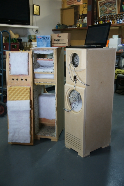

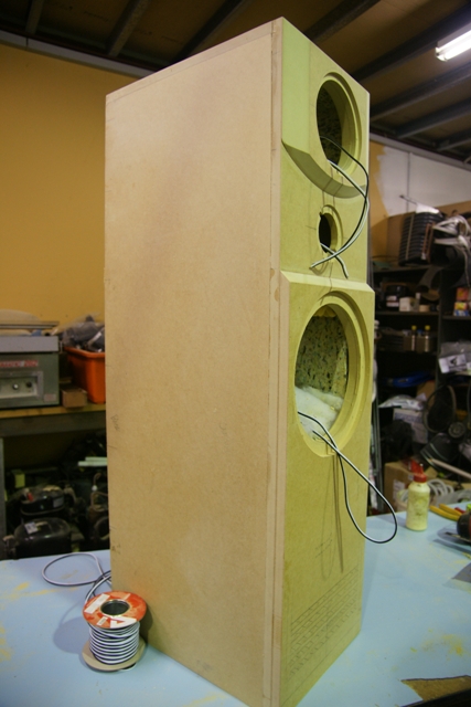

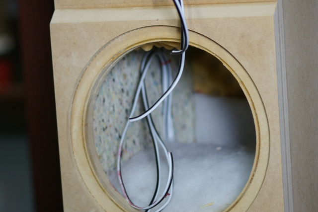

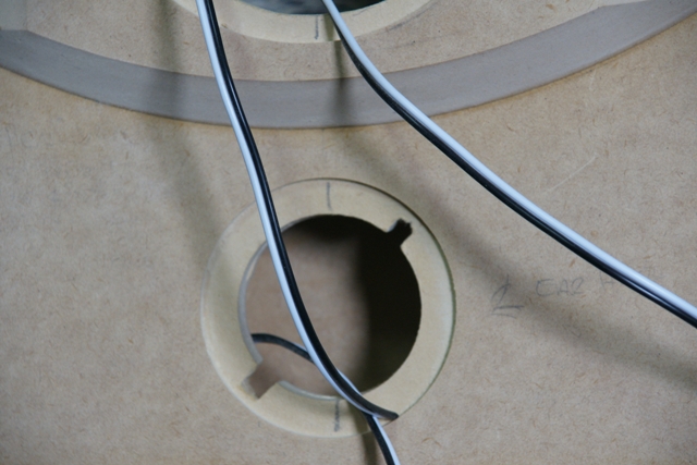

got a fair bit of progress on these boxes
on 13/9/2013 (black friday) had a few mistakes happen
the router stop moved about 8mm the wrong way and i ended up being to deep in the woofer section of one box
this mistake took about another hour or so to rout out the correct depth washer and glue into place
talk about bad luck
i have used a hand plane to get an even surface on the external sections of the box joins
i am in two minds as to either piano gloss back the entire boxes or to veeneer top and three sides then gloss black faces

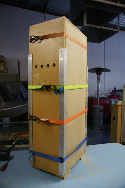

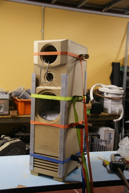

i used some aliminium angle to hold the corners in place when torsion strapping the boxes for glueing
i also knock the joins with a rubber mallet to set them in tight
all of the intrenal wadding and wiring are complete so next thing will be to complete the pedistals and mount them so i can start on crossover development

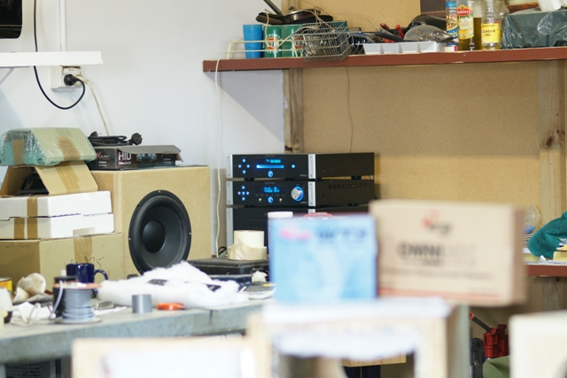

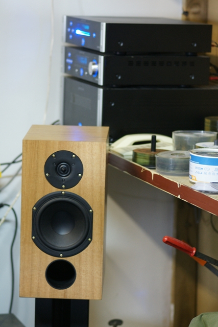

some more snaps for your viewing

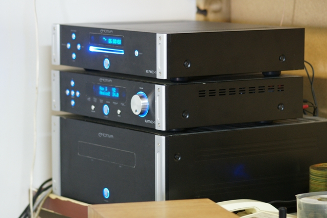

my workshop equipment is emotiva and the small two way are another project that i completed some time back
talk about bad luck

snaps
more snaps

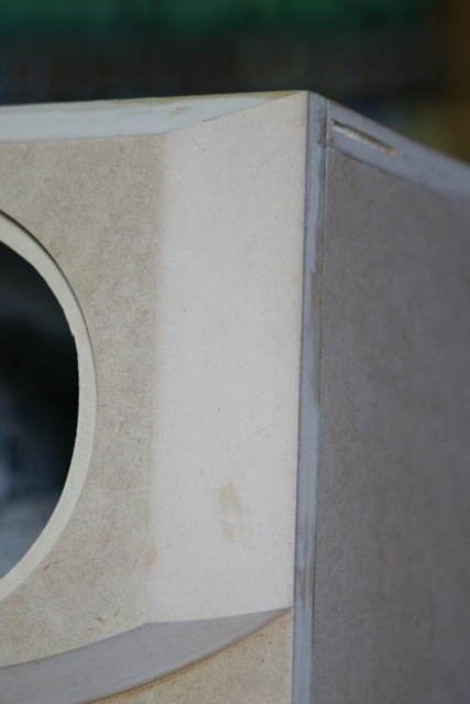

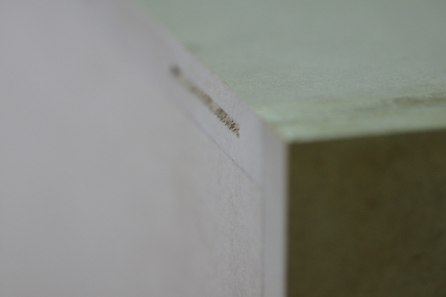

you can see were i cut the biscuits into the wrong section of the lid
another bad day
good bog and faring will disguise most flaws
more snaps
another bad day
