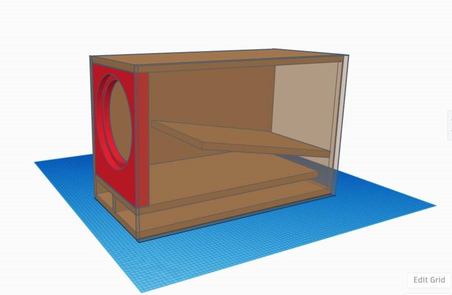

I put together what I think would be a great enclosure for my Dayton Titanic 12" mkIII. Its been living in an old JBL enclosure power by a BASH 500. Please let me know if I missed anything here.
I entered the driver into WinISD
The only thing that was different from the spec sheet was Sd. It autocalculated and manually entering from the spec sheet would caused driver invalidation.
WinISD liked 130 liters tuned to just under 20 hz, SPL at 500 watts rms, 45 deg angle, 3 meters away.
Made this in sketchup to match:
Heres cone excursion and port velocity:
Looks like I'll need to filter under 20hz, but i have a DSP to help out.
Does that all check out? Did i make any mistakes?

It'd require more power to get the same SPL. Whether the driver will comfortably accept the extra power will vary.
If you're going to be running it hard, I'd build something as efficient as possible so the driver absorbs minimal power. If you only care about lower listening levels, then using some DSP boost on a smaller cabinet can make a lot of sense.

I probably wont be running it to hard, I probably have the amp level set at 50% in the current enclosure.
That said, the design has a pretty small foot print. Going from 130 liters to 90 liters takes off 8 inches of height... not sure what good saving that 8 inches would do.
Would probably be better to make the box ideal, then use the DSP for any room effect or things WinISD didn't/couldn't account for.
Why not a simple L-shaped port?
Incorrect, I'm afraid.
Every turn adds a bit more flow resistance, so an L-shaped port would be better here.
Chris
I suppose I was thinking to geometrically.
Thanks chriss661 and BPFanatic. I'll switch it over to an L port.... I'm embarrassed, i have a degree in aerospace engineering

Thanks for your reply . Yes, a horn for the port is probably not worth pursuing. I have done a bit more modelling in hornresp and found that there is some advantage (keeping total box dimensions the same) in going with a folded mltl:
- Keeping the same port area it allows me to shorten the port to fit along one wall, rather than going around the corner
- The shorter port pushes the first port resonance up past 200 Hz
- The fold partition provides some useful bracing
- Can be easily tuned with stuffing in the "wide end" of the line (the volume above the fold partition in the attached diagram)
The OP might want to look at this as an option.
