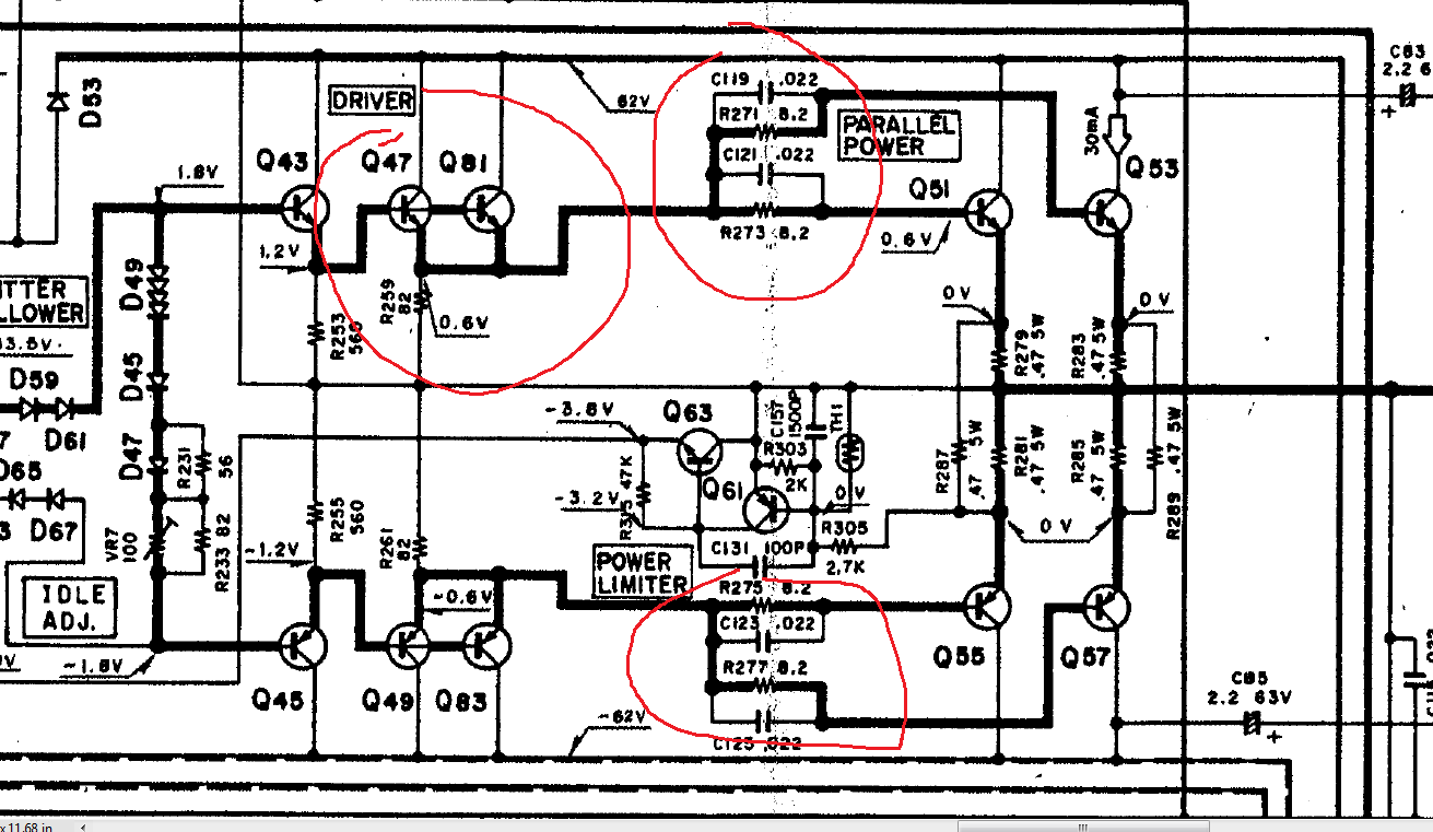

a transition from 3mhz to10mhz transistor won't be really noticeable...but one to 60 or 80mhz is...Here you have some very extreme case where you have paralleled 200mhz drivers for 80 mhz final transistors...not much compensation is used throughout all the amp but every single stage is optimized for speed.Usually higher FT transistors can oscillate, their Cbe is very low so a small base series resistor is advisable.

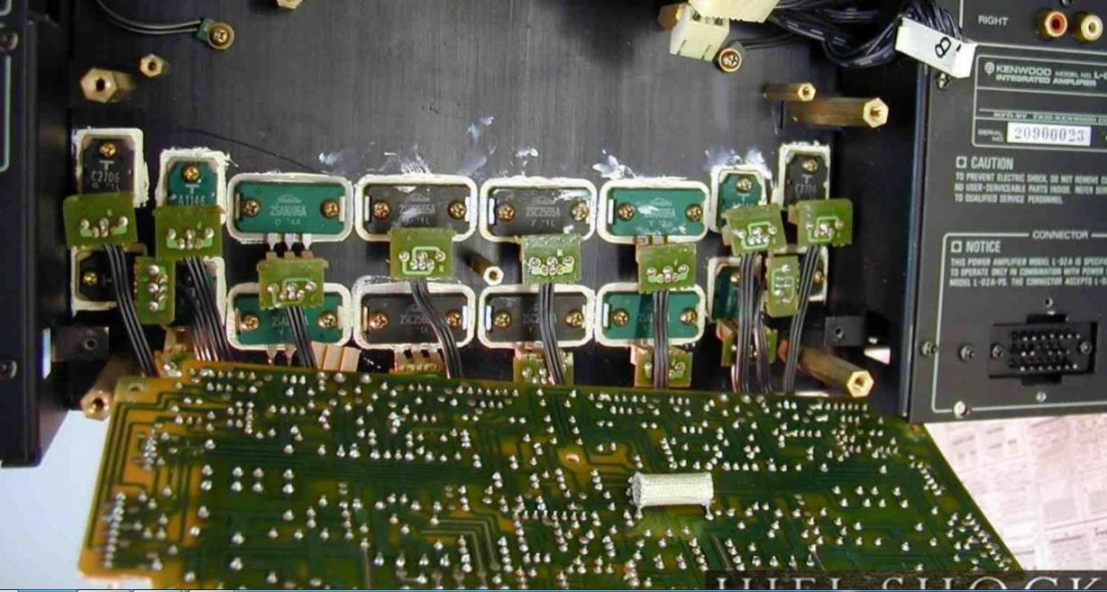

Here you have an even more extreme case with (RF like)common base stage driving 80mhz transistors...but there's a catch here.People would say: Sacrilege! Too long wires to such fast transistors...those wires are just making small capacitors parallel to the active junctions making the circuit a bit slower and more stable. The common base stage(DLD) have no problem driving even higher capacitance...The DLD stage itself is wired that way...many people who saw that picture were in complete disbelief...saying that that amp is complete heresy but it works and there's no known case of an l-02 that got burned or self oscillating although it has 150v/us slew rate...Sansui and Kenwood were high speed circuit champions for sure.

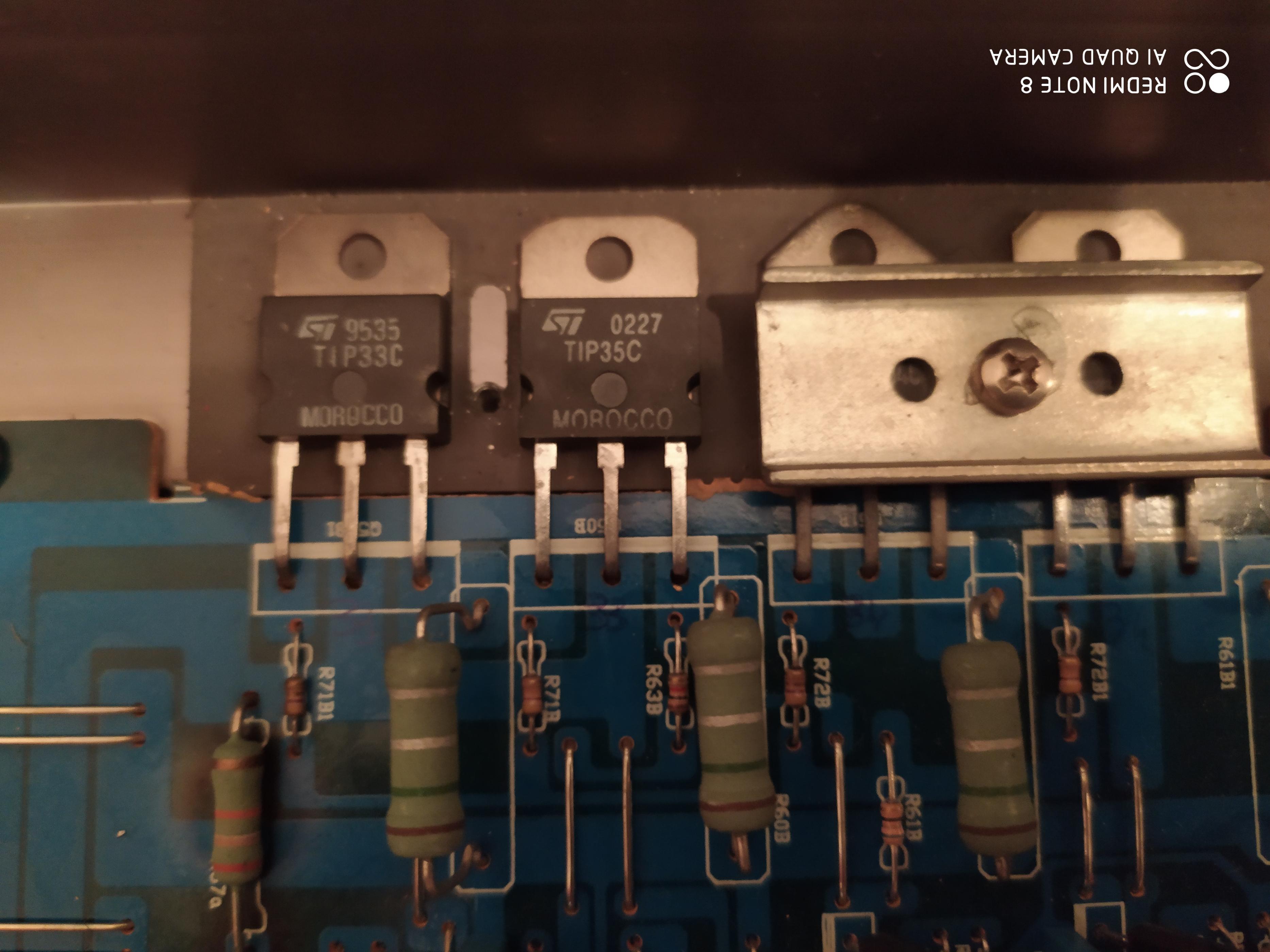

pic of the badly repaired output stage attached
as you can see parts of different wattage have been used
in the weekend i will take complete pics of both channels
overall i like the amp ...

I see a base resistor in your picture and that makesme think that the original transistors might be higher FT as well...try 2sc5200/2sa1943...very cheap .What i don't really likein your circuit are the 0.15 ohm emitter resistors.Replace them with 0.47ohm/5w .You won't loose much power, you couldincrease the bias alittle bit anyway , but you can go with a lot more different transistors with no problem.

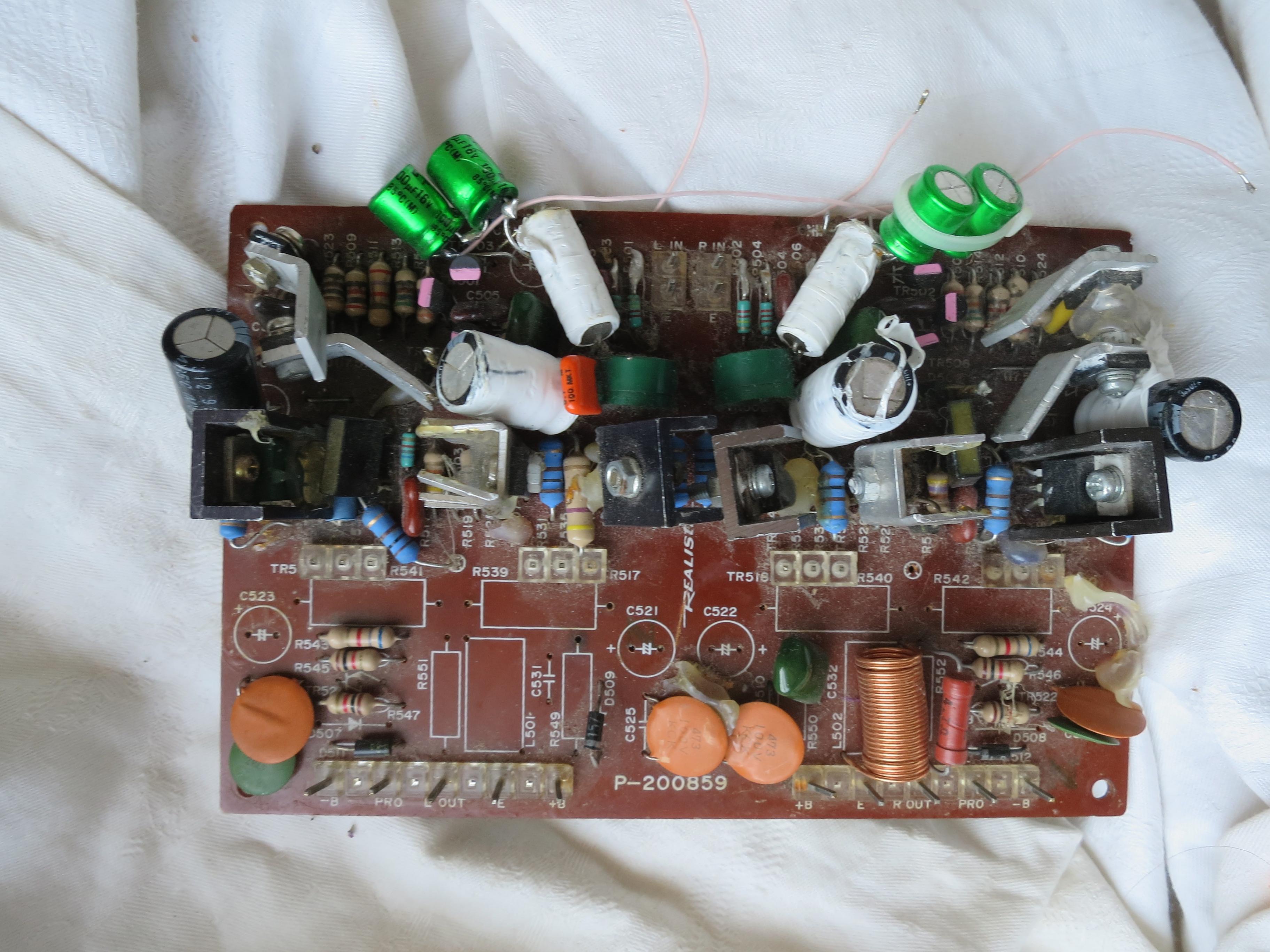

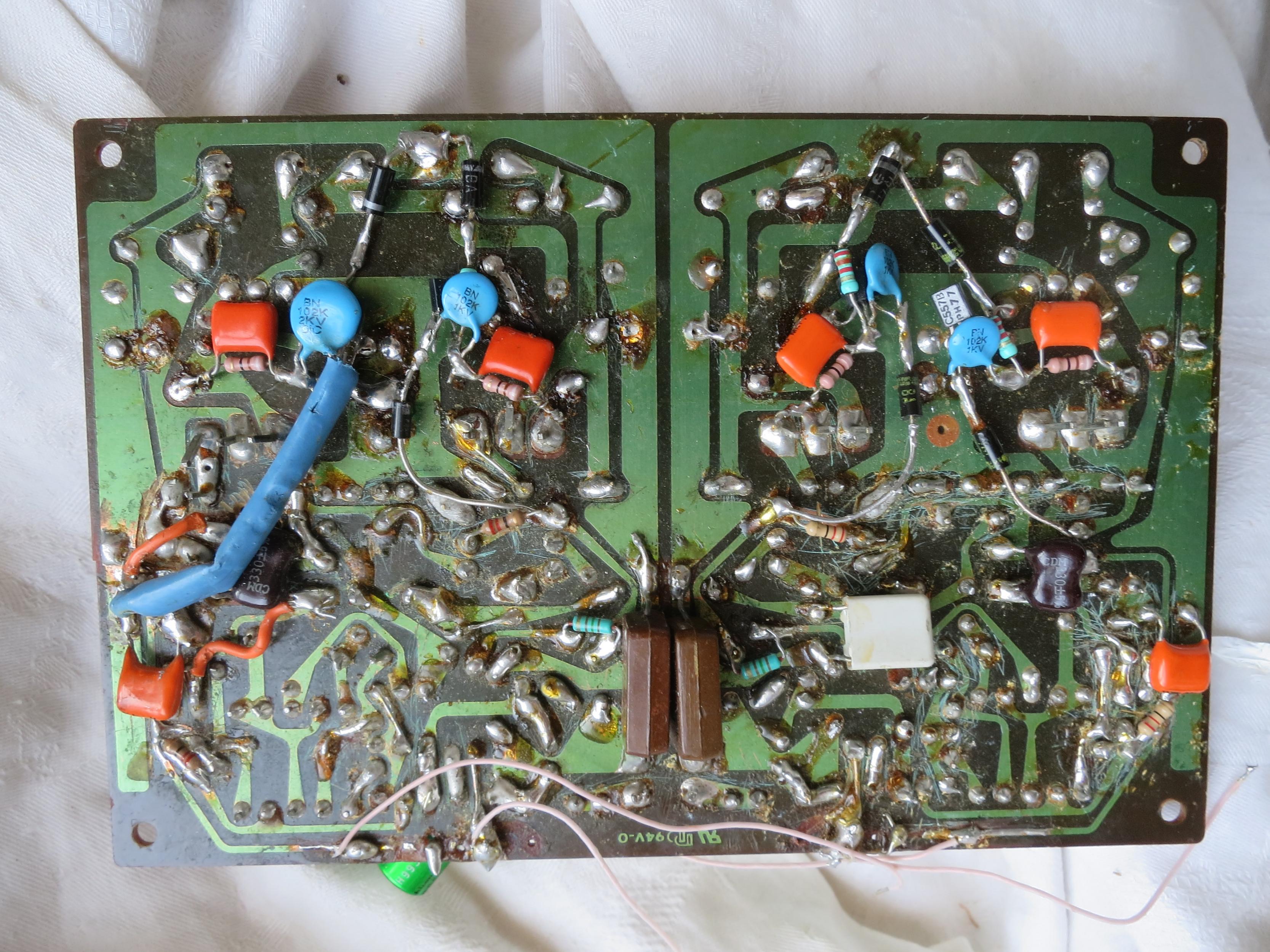

Yes, i replaced all the components with much better and faster transistors and some better capacitors in that final stage after that severe burn ..also used a very high quality potentiometer for bias from scraped HP analysers.That happened 9 years ago.Didn't modify any passive component value though...still have that board as i wanted to make a new pcb .The pcb has develloped an unpleasant smell after several decades of "burn in" :) .Usually i lose interest in fixing stuff once i get the idea of what can be done with it...
The sound was a clear class A sound...much more melodious ...no crossover distortion probably.I only used my ears for checking.
