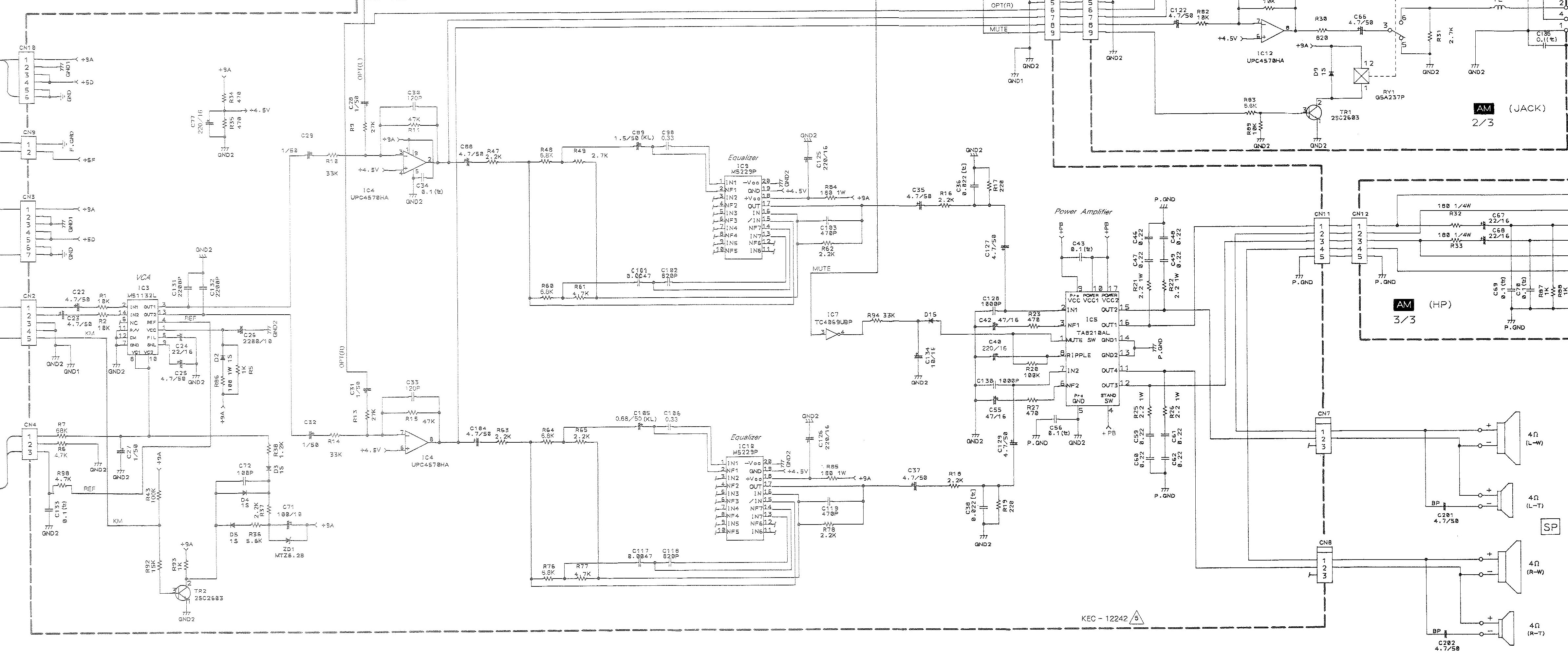

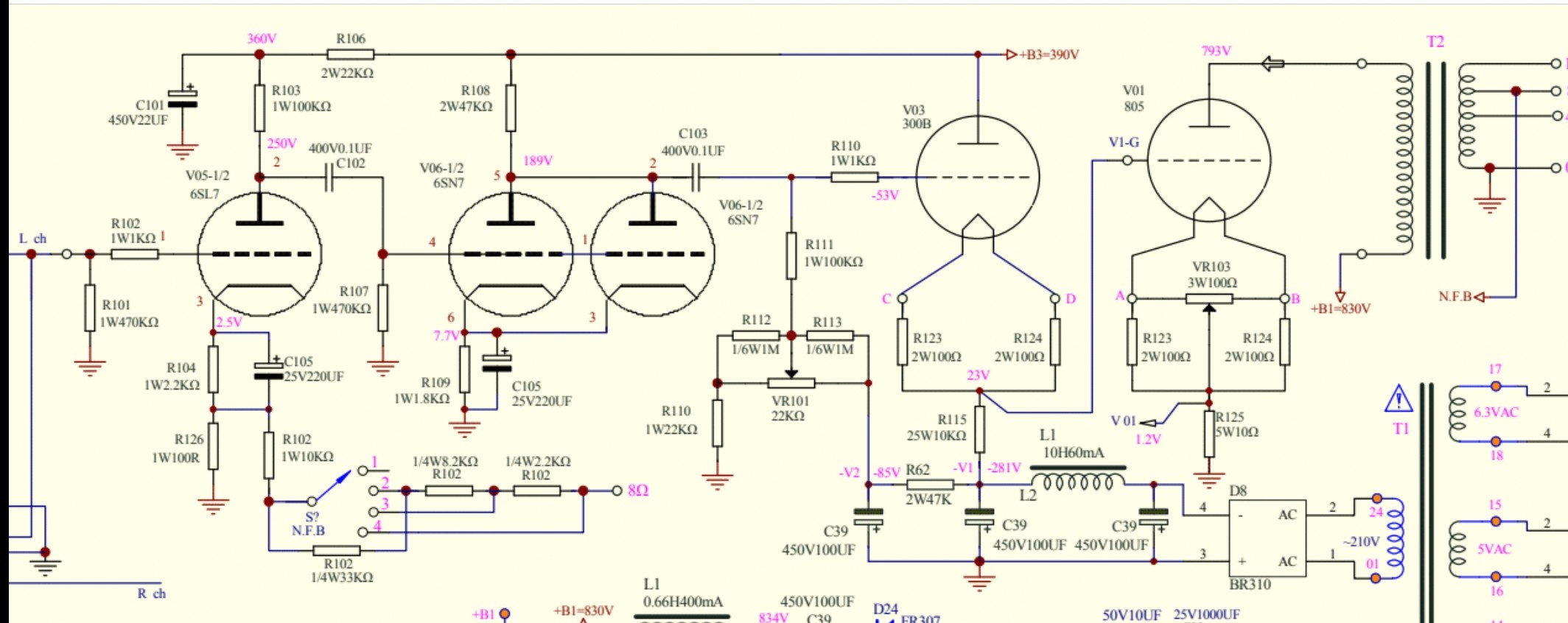

I have a Line Magnetic LM-508IA as my main amp. It's great, but I have a hunch that a dedicated preamp might make it even better. I am actually about to get a LM-512CA. The supposed gain of the preamp is 20db, there's not much more information, and I also couldn't get hold of a schematic. The power amplifier features a "preamp input", but it only bypasses the volume pot and not the preamp stage. My question is, whether you think it's a good idea to change this to a real bypass, and where exactly you would put the signal from the preamp. Between C103 and R110 and go directly into the 300B driver?
I attached a schematic of the LM-508IA. The first stage is half the 6SL7, cap coupled to the 6SN7, which has both triode systems working in parallel, another coupling cap and then the 300B driving the 805 as a directly coupled cathode follower.
Thanks and best regards

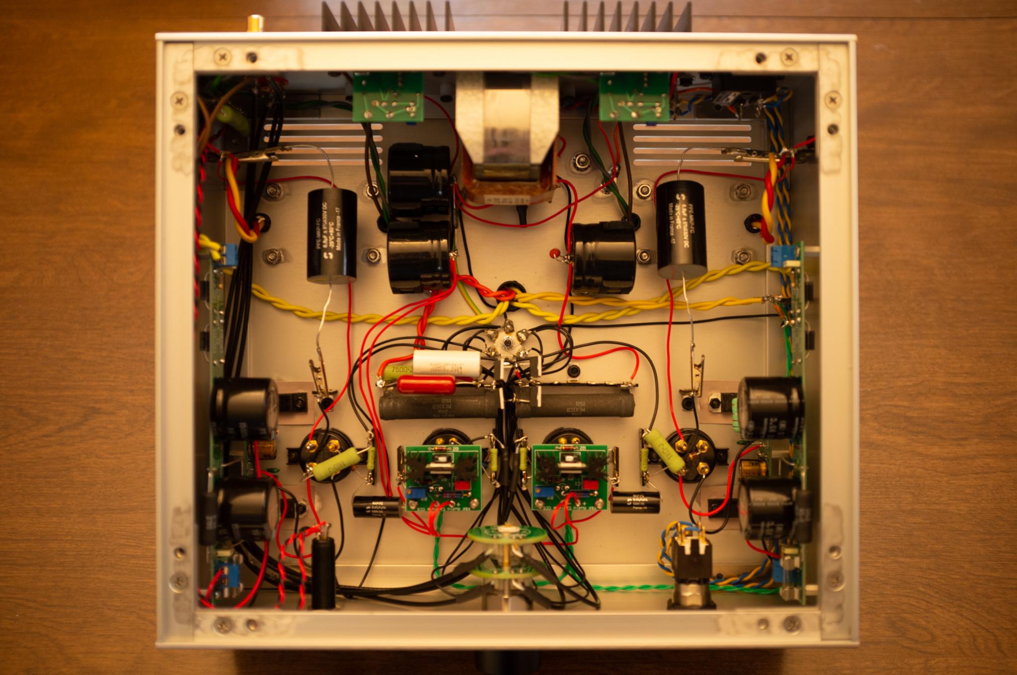

TubeLab SPP Questions
Been spending some time (days, not hours) cataloguing the thermionic, sand and driver stash. Already found several goodies I forgot about, e.g. an externally beaten Quad 303 that fired-up after a brief ramp-up on the Variac.
Already received the output and p/s cap from Mouser...yeah, sand!
OK just kidding, although low voltages will work better with four grandchildren under four, so there's that.
Downside is that the Chief Cook & Bottle Washer has seized on this opportunity to force an eBay purge of about a dozen guitar speakers. Rats.
Also found P-P OPTs, including pairs of both Hammond 1608s and Dynaco Z565s (for the ST and SCA-35 EL84 uL amps) amongst others. These in particular are practically begging for a little solder on those old wires.
Questions for George:
(1) are the SPP boards available? Looks like I need a few. Lord knows I'm not doing point-to-point at my age if I can avoid it.
(2) I noticed that on the Dynaco EL-84 amps, the SPLITTER plate and cathode resistors are slightly different values (cathode is about 22% larger, 27K vs 22K), which seems odd.
On the SPP, they are the same (I would say symmetrical), which seems logical. What gives? D. Hafler up to some tricks I can't fathom?
(3) I would like to use one board to make a Flexi-SPP, with off-board Octals for 6V6 and the like. Maybe an octal driver, maybe even 6L6etc family power tubes if I can concoct an easy way to switch OPTs. Any issues with that?
On the SSE with off-board octals for 6AV5s, I neatly tie-wrapped the wires, but didn't twist any, not even the fils. No hum, but probably bad practice.
What SHOULD I do? Just twist the fils, say 3 turns/inch? Twist the whole bundle? Just curious.
(4) What, no CCS on the driver cathode? I found a sleeve of 10M45s in the stash...I can do it off-board like I did on the spit & duct tape Rat Lab 6AV7.
(5) Coupling caps on SE amps seem to cluster around 0.22uF, while P-P amps all seem to use 0.1uF. Why is that? Only dealing with half a wave at a time?
Thanks in advance...

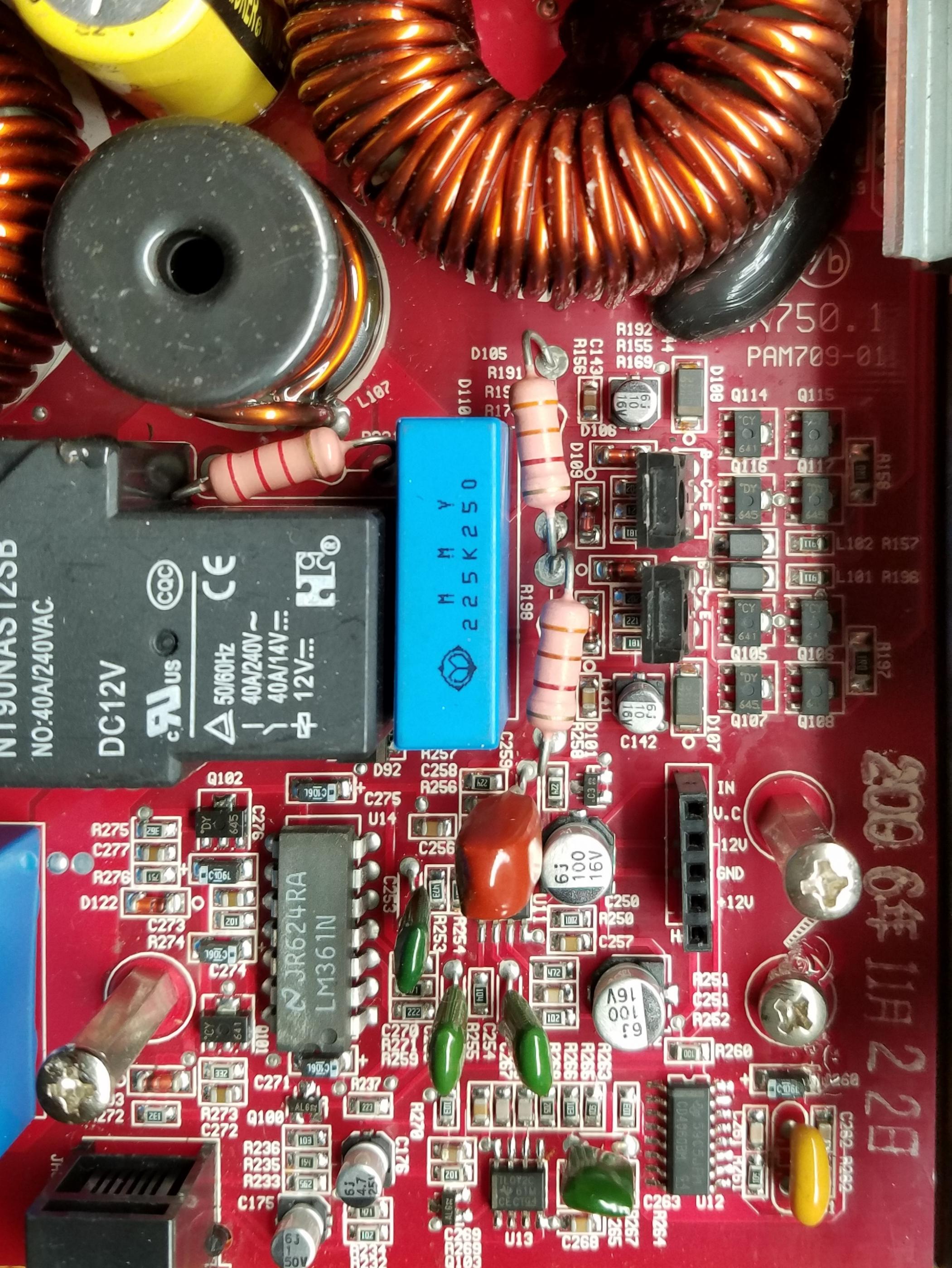

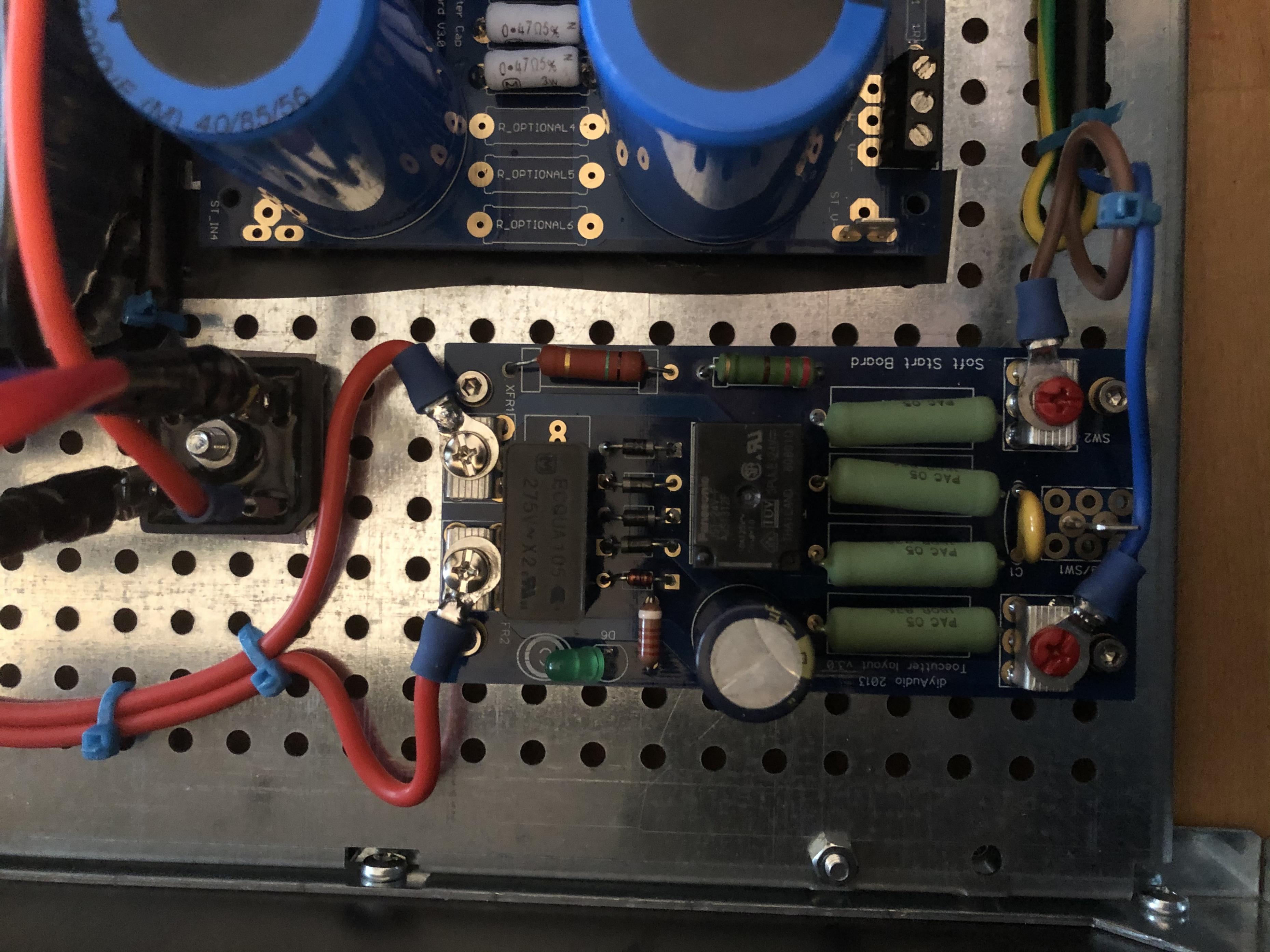

KX750.1
Relay is cycling. I have pulled R35 and amp stays on. Relay comes on.
I have replaced U14 (LM361) and U11 (TL072C), put R35 back in circuit, get the same results. Cycling protection. Pulling R34 back out now.
I have board out of chassis. All PS FET's are new 3205's with 47ohm resistors, and 640's and 9640's are new.
I have 12v across all four zeners.
Voltages of IC's
U14 LM361
Pin 1: 12.03
Pin 2: 0
Pin 3: -7.42
Pin 4: -.452
Pin 5: 0
Pin 6: -11.75
Pin 7: 0
Pin 8: 2.76
Pin 9: -1.30
Pin 10: -1.17
Pin 11: 2.31
Pin 12: 0
Pin 13: 2.81
Pin 14: 2.81
U11 TL072C
Pin 1: 10.12
Pin 2: 28.80
Pin 3: 0
Pin 4: -11.75
Pin 5: .556
Pin 6: .560
Pin 7: 5.61
Pin 8: 12
U13 TL072c
Pin 1: .002
Pin 2: .002
Pin 3: 0
Pin 4: -11.75
Pin 5: 0
Pin 6: .007
Pin 7: .625
Pin 8: 12

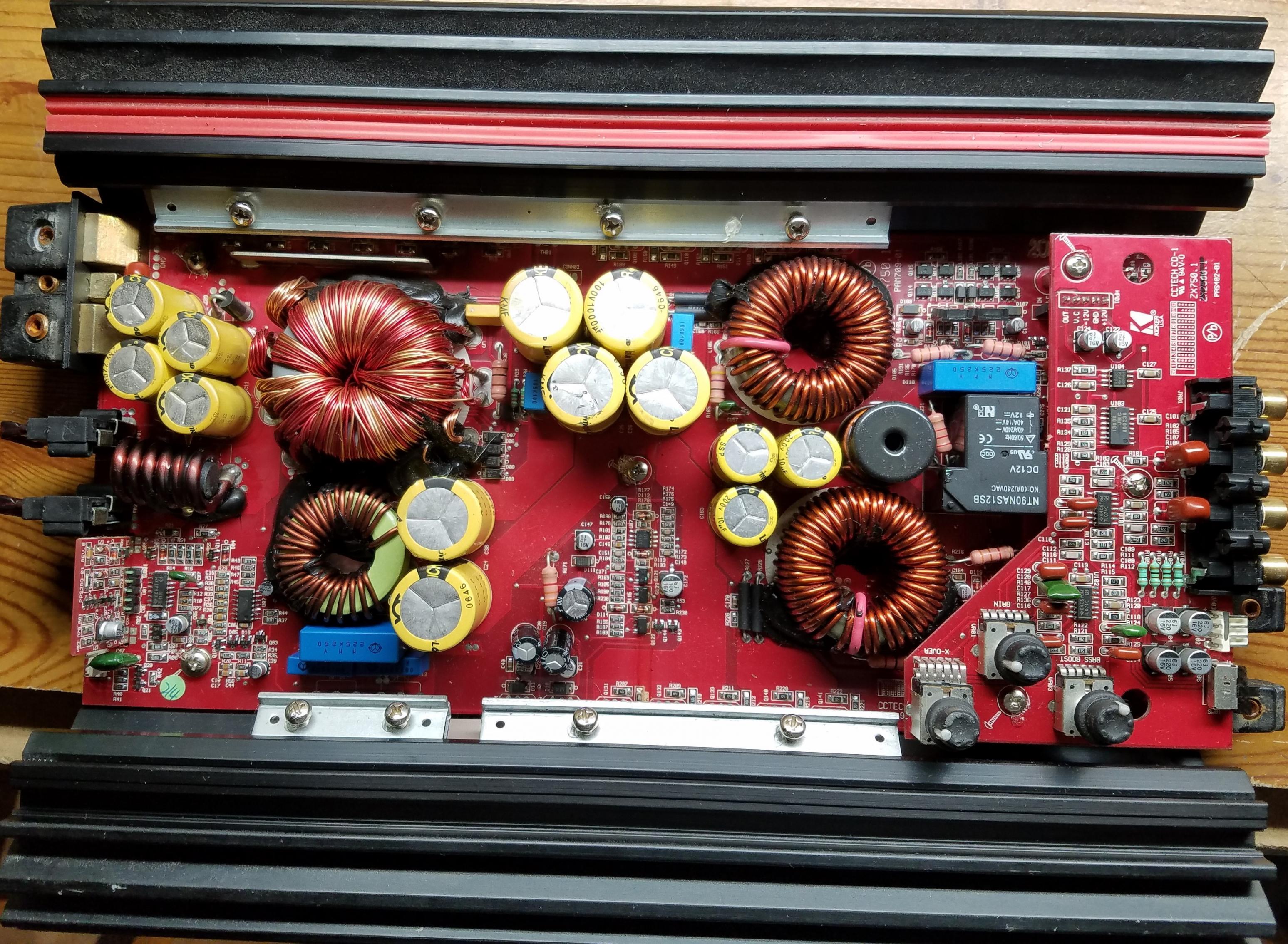

Rockford Fosgate 800a2 meltdown
I got one for ya.
Appears this thing had a nuclear meltdown of some sorts, and I have no idea what would even cause this amount of damage.
Even more importantly, is it even fixable? anyone have any clear pictures/schematics of the burned section in the TL494 circuit?
it appears on first glance it went into a serious oscillation before it had the meltdown. the Zobel filter is burned. Also, I noticed the transistors have unsoldered themselves from the heatsink indicating this thing got SUPER hot... like firecracker hot.
Pictures are too big to attach them here, so I threw them on Google Drive:
800a2 - Google Drive
thoughts?

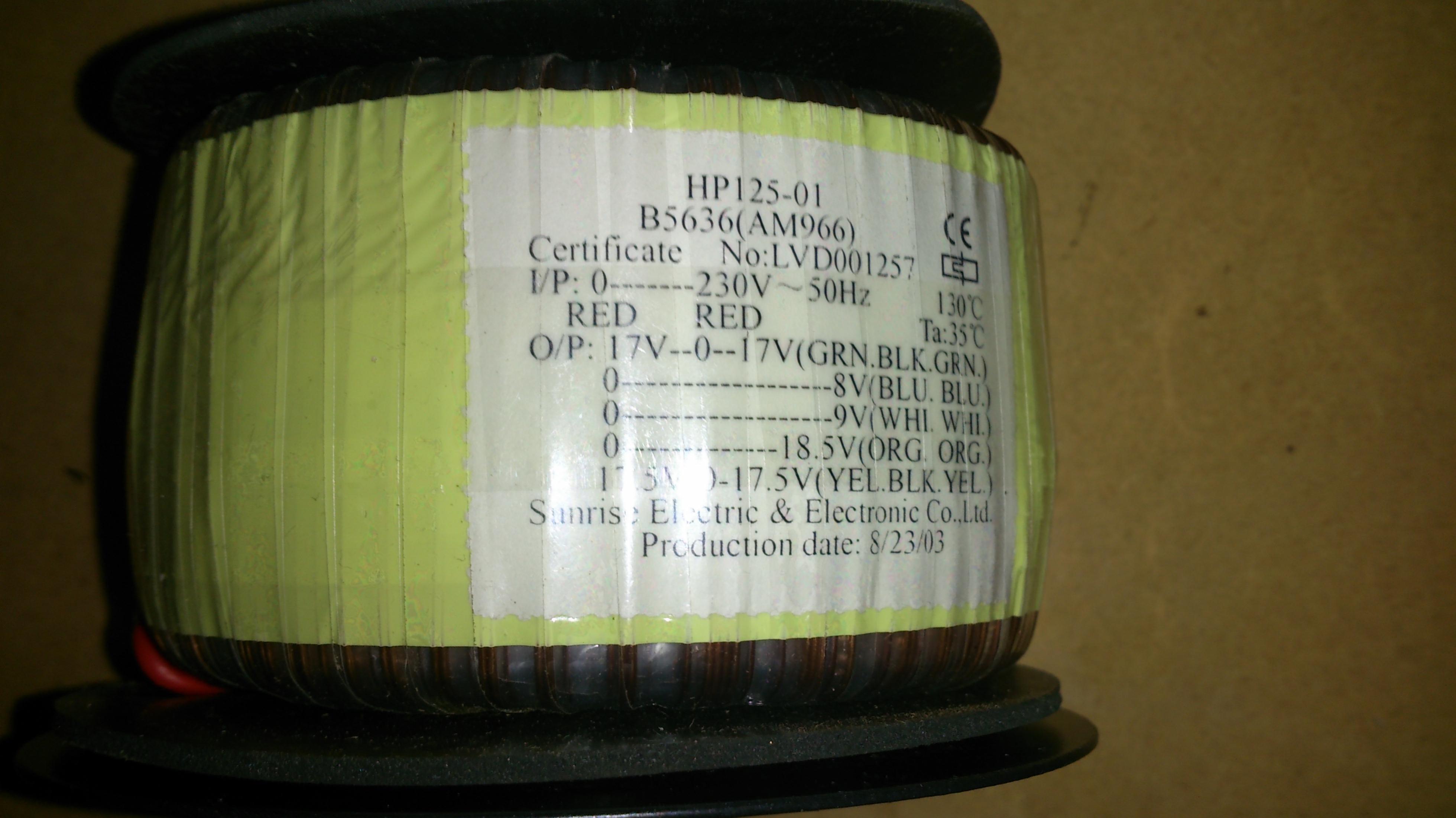

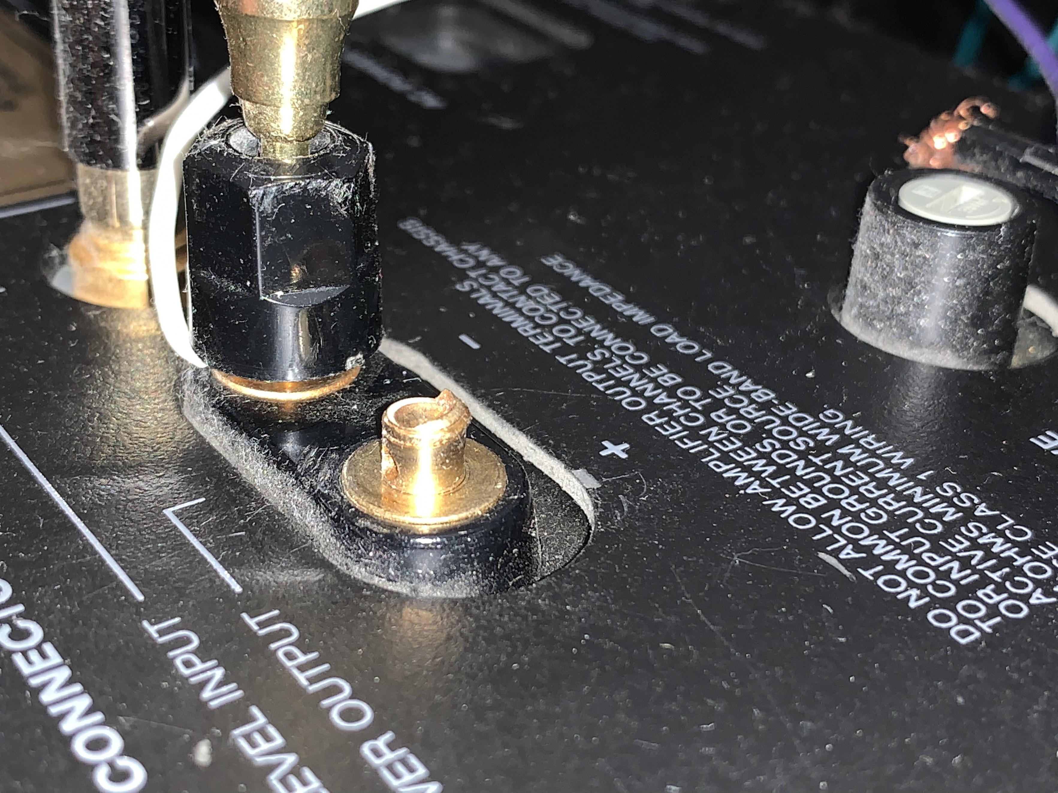

Replacement Terminal for Threshold S500 II
Hello everybody,
I am quite new to the HIFI world and was fortunate enough to inherit an old Threshold S500 from my dad. It was gathering dust in the basement for many many years until I found it and it still works great! Unfortunately one of the terminals seem to be broken (see picture below). Does anyone have recommendations which terminals i should replace them with? And has anyone attempted to replace those terminals on a Threshold before and can share some tips on how to do it?
Thank you and best regards
Duy

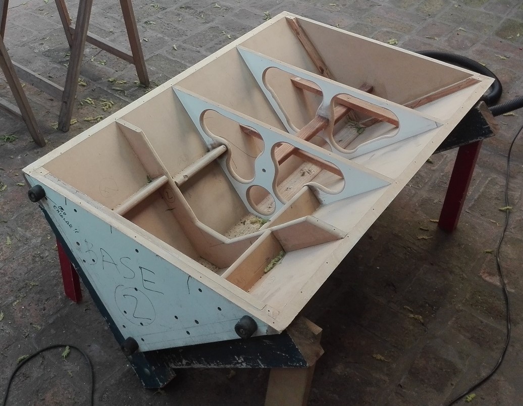

Coral Beta 12
I found an article from Chris Templer at TNT about a modified horn cabinet. I have a pair of 12" Goodmans Axiom 201, so I started to plan for this project with my friend and carpenter Ulf. The horn is made out of 32mm MDF with oak veneer that is white washed. The lip at the bottom help the horn to couple to the floor and increase the bass . I will get som lower castors to bring the cabinet down a few centimeters. No filter needed as the sound is great in my ears and a 10m double folded bass horn, Audax 15" is helping out in the lowest low. I run this on my vintage Sony TA-2000F and TA-3200F but planning for a tube amplifier soon.
Coral Beta 12 horn | Flickr

DB Technologies PA 3.0 Problem
Hello everyone
Yesterday i bought a used db pa 3.0
When checking at Sellers home It seems It was working well
But when i try at home, even without any input attached It makes a big "Buzz sound"
Tried to switch cables / speakers / Power outlet and send some input, the speakers works but i jeep hearing this vert loud buzz
Amplifier also make a strange sound when i turni It on as on following video where you can also hear the buzz
db pa 3.0 - YouTube
What May Be the problem?
Also che Power cables has been fixed by Seller like per pic

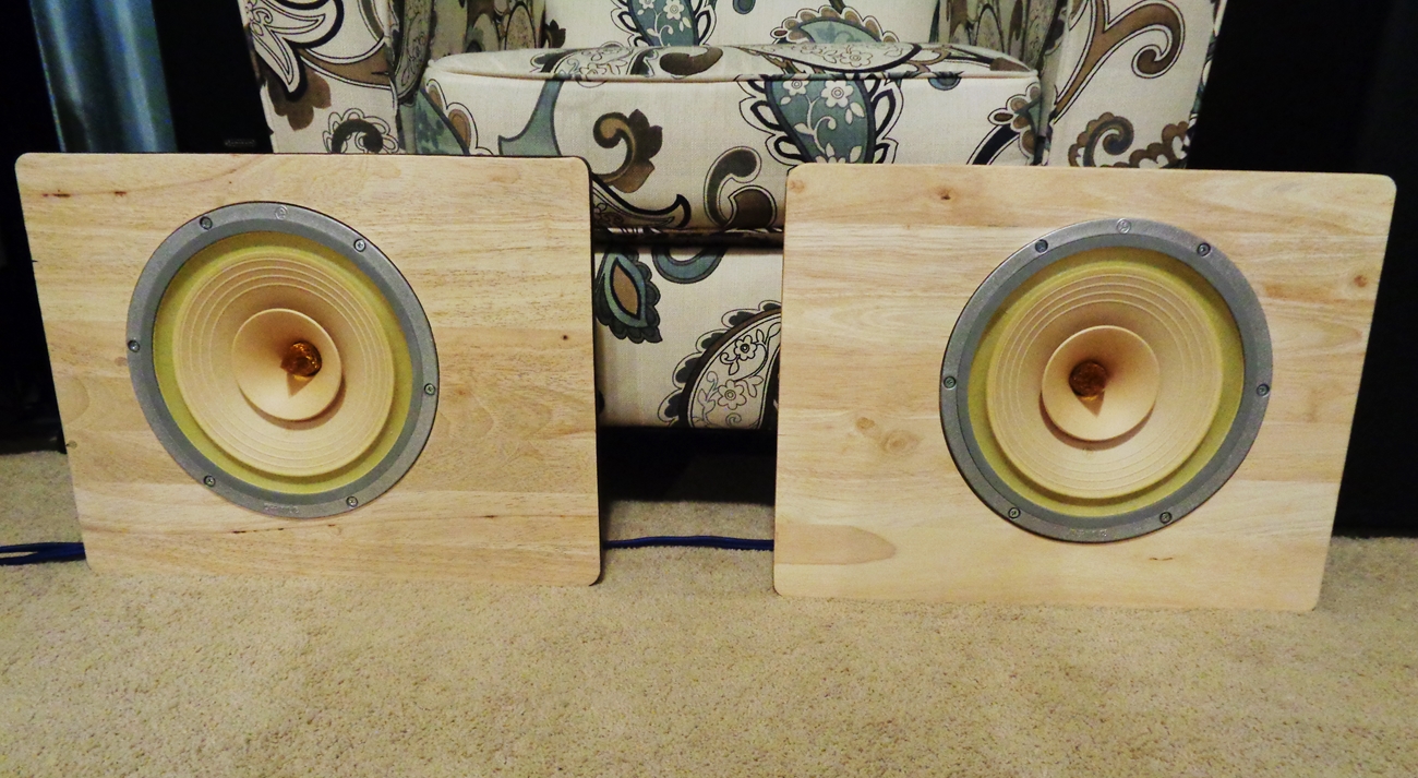

Need construction advice for OB
I'm very interested in hearing people's advice as I'm in the process of building a set of open baffles (first time speaker builder). I already have a pair of full range Lii Audio Crystal 10's mounted on 15 x 19 inch solid maple baffles and burning in (close to 100 hours).
I'm waiting on a pair of Acoustic Elegance Dipole15 - Dual-8ohm drivers to show up in a week or so. I want to mount them on 24 (W) x 36 (H) inch solid maple baffles. Should they be centered as much as possible on 3 sides or off centered and how far from the bottom? I understand there aren't many options due to the fact that the baffle will only be 24 inches wide.
I have a Primare A32 power amp. Here's a rear pic.
Since I have 2 sets of speaker inputs on the power amp, I was thinking of running the Crystal 10's to the top speaker inputs without crossovers (that's how they're being played now) and the AE woofers to the bottom speaker inputs. I know I'll need an inductor on the woofers to keep high frequencies from going to them. I need to know if that hook up will work without harming the amp or speakers. If that hook up will be okay I'll have more questions. Thanks for any advice.

Carver TFM-25 IC questions
I'm trying to troubleshoot the right channel on this amplifier, the right channel is triggering the protect with a DC offset of -350mv to -400mv. Must be on the border of voltage to trigger as it comes out of protection half the time? Anyway looking at the input IC 101 , I get normal values except at the output of pin7 ( right channel) which reads +14.36 v ? Pin 1 output for left channel is -154mv... Does this indicate a toasted IC or would it be a bad component feeding into it??

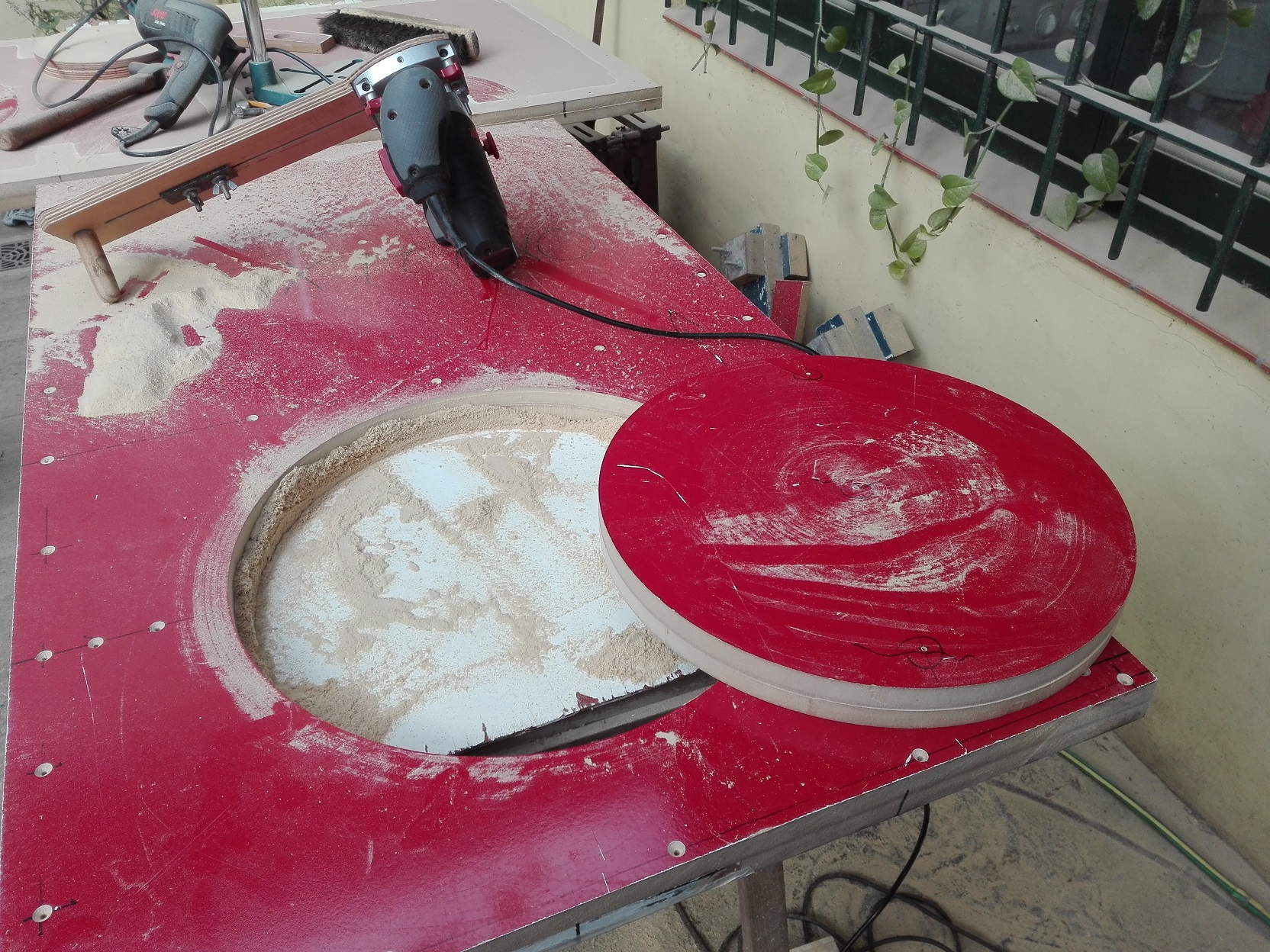

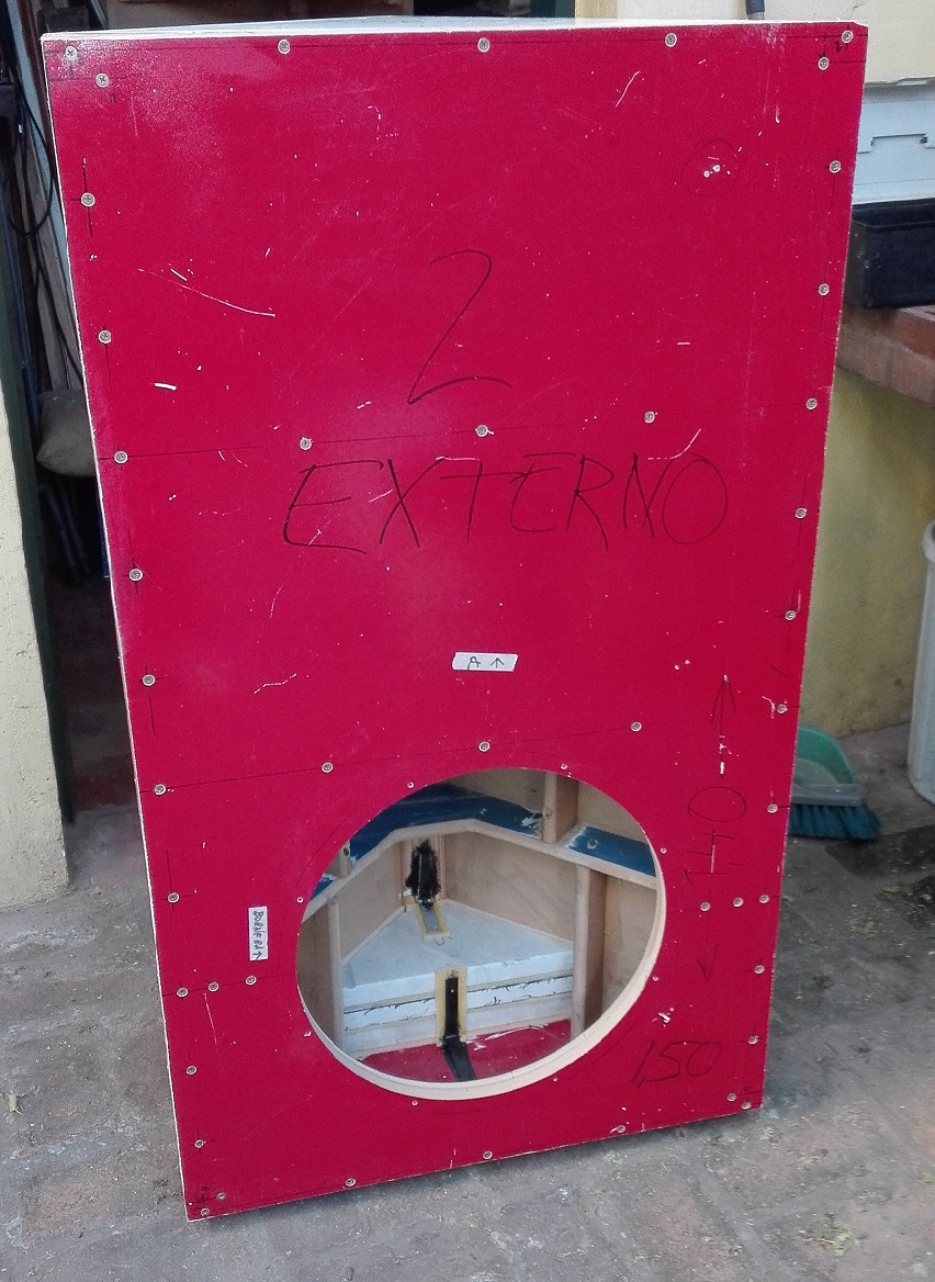

Empirical resonance testing and wire fixing on my DIY Subwoofers
As I am a bit of a perfectionist maniac and in these times of pandemic there is something to be entertained, I decided to solve a problem that probably was not such.
When I taped the wires to the weak speaker connection foil, I thought they might come loose, because the basket is slightly irregular in shape, and the plastic strips would slide into the narrower section with vibration. They had to be fixed permanently, but the extra task was forgotten.
So yesterday I decided to do it because by the way I wanted to do a little experiment, motivated by this recently read post.
https://www.diyaudio.com/forums/full-range/365242-softly-coupling-driver-cabinet.html
The photos explain the work done.
It was risky to get the speaker upright, but I had already discarded the "beds" I had made to work horizontally.
So I prepared a bracket to support the bottom of the speaker once it was loose, and there were no major inconveniences, thankfully.
And the heads of the fixing screws also had to be covered with black paint. Done. Now I like the look better.
Having said that, let's go to the experiment in the post. Let's agree that a sealed cabinet is not the same as a ventilated one, the internal air pressure inside the sealed cabinet is much higher, but the resonances transmitted from the speaker structure to the cabinet obey the same physical phenomena.
I had a concern to vary the setting of the set screws and observe what was happening with the vibration of the cabinet. Although the speaker is not fully floating, as would be the idea of ​​the post mentioned, because the screws here are an important mechanical coupling, I wanted to see what happened.
I used a CD with a fixed 30 Hertz pitch.
Conclusions:
1) There is no variation in the resonance of the cabinet with the screws slightly tightened - just so that the gasket is sealed and air does not escape - or firmly tightened - as they were originally -.
2) At low volumes, the cabinet is "dead" across its entire surface. But oh, surprise! At high volumes, a slight vibration is perceived (by resting the hand on it) only in the upper part of the cabinet. From the middle of the cabinet to the floor, there is no vibration, it remains inert. With high volumes, well, the entire cabinets, the speaker and all the furniture shake. The walls reflect but do not resonate, they are made of solid material (bricks).
3) These tests and results make me think that the cross and vertical gussets do their job acceptably, but the thickness of the side walls and top panel (19mm) should have been thicker, perhaps 30mm like the front baffle. It is evident that the extra weight added to the base of the cabinet with marble blocks lowers the resonance (added to the weight of the speaker) in the area around the speaker effectively, as intended. But not as we move away from this area.
But either way, the resonances are well above the working passband of the subwoofer, which is crossover via an 80 Hertz DSP amplifier with an 18 dB / octave Butterwhort slope. In my next reincarnation I will see to make thicker panels and fill the entire interior with sheets of lead .....
Any thoughts and / or criticisms will be well received. Ahead. Come on ! 😀
PD: Rest of pics next post

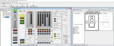

For Sale: DEQX PDC 2.6P Preamp
Hi all,
I have an early model DEQX PDC2.6P for sale, the preamp version with the attenuators. It has SPDIF and AES digital inputs, balanced inputs and unbalanced RCA ins and outs. Upgraded to the latest firmware and runs with the latest V3.02 calibration software
Working perfectly, a brilliant tool for trying out crossover points and slopes. Does full driver/speaker correction and limited room correction as well. Full volume control on all inputs and outs and a selection of up to four separate inputs. Also has full parametric EQ adjustable on the fly via the remote
Perfect for anyone interested in getting the most from either passively crossed speakers or developing 2/3 way actives. Really easy to get a system up and running quickly because everything you need, hardware and software are fully integrated, nothing else comes close. Has three presets so you try out different crossover options from your armchair
Great condition, and looks very cool with the chrome finish front panel, also comes with the remote control pictured. A Behringer measurement mic is also available at extra charge
Looking for USD800 plus shipping from Australia
Let me know if you're interested and I'll get a shipping quote or if you want some more information
Cheers, Ralph
Analog scope troubles
My old, beloved GW GOS-3310 has stumped me. It has been a faithful companion for years and then had an “event” that since has the amplitude variable as well as the vertical gain pot acting like vertical position, along with the actual vertical position control and DC balance pots.
I have replaced every transistor, diode, and zener in the visible portion of the schematic pic below, and replaced or checked every resistor and cap. Voltages all good into the circuit starting with Q202, and good all the way to the CRT on the right with the notable exception that varying VR203 (amplitude) should increase Y1 and Y2 on the CRT equally and it doesn’t. VR202 (Gain) should do the same and it does not. VR201 and VR204 are DC balance, and all 4 of these move the trace vertically instead of changing the amplitude.
Anyone with higher schematic reading and troubleshooting skills than I might see what I am missing. Thanks in advance for any assistance.
I have a shiny new Rigol MSO5000 so I am not without a scope but I have a warm spot in my heart for this old single channel 10 Mhz scope.
Jeff
