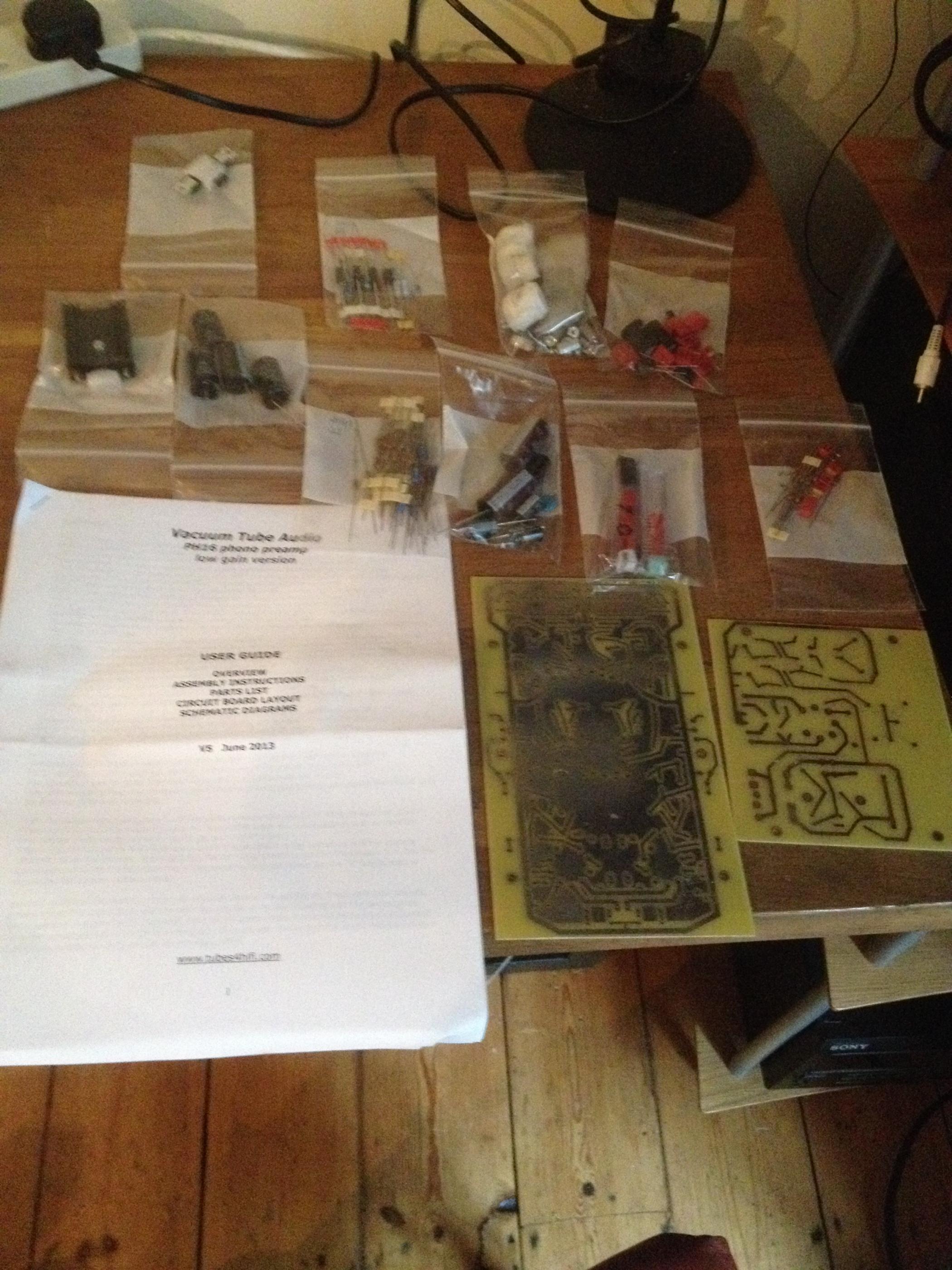

The kit has arrived, and i have bought a new solder station from maplins, I have also ordered a toroidal transformer from Terry at Canterbury Windings Home
here are all the parts and where it will be built.

Roys Kits are delivered with the components in separate bags so the power supply resistors are in one bag, caps in another
amplifier stage resistors, caps and loading resistors all in separate bags.
the instructions/manual/schematics/circuit diagrams are clear and well written.

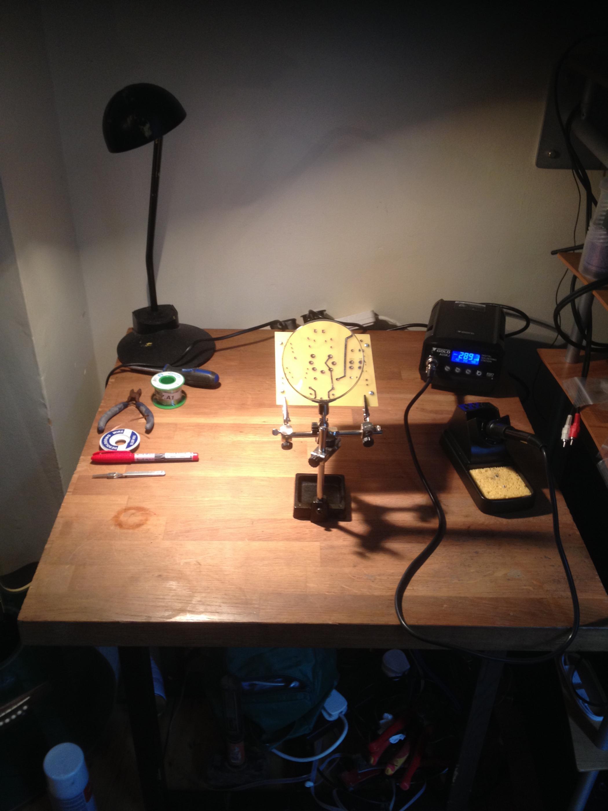

So once set up from a trip to Maplins with new solder station, Multimeter isopropyl alcohol (for cleaning the boards) a third hand (Magnifying glass, with crocodile clips to hold the work to allow two hands to do the soldering) A roll of Silver Solder, heat shunt, and wire (green, red,black and a length of low cap coax) I was ready to go.
I printed of a resistor colour code chart to identify the resistances and checked them with the multimeter,1. to check i was right and 2. to match resistors in pairs which was unneccessary as the majority of the resistors are quality dale resistors which were pretty spot on.

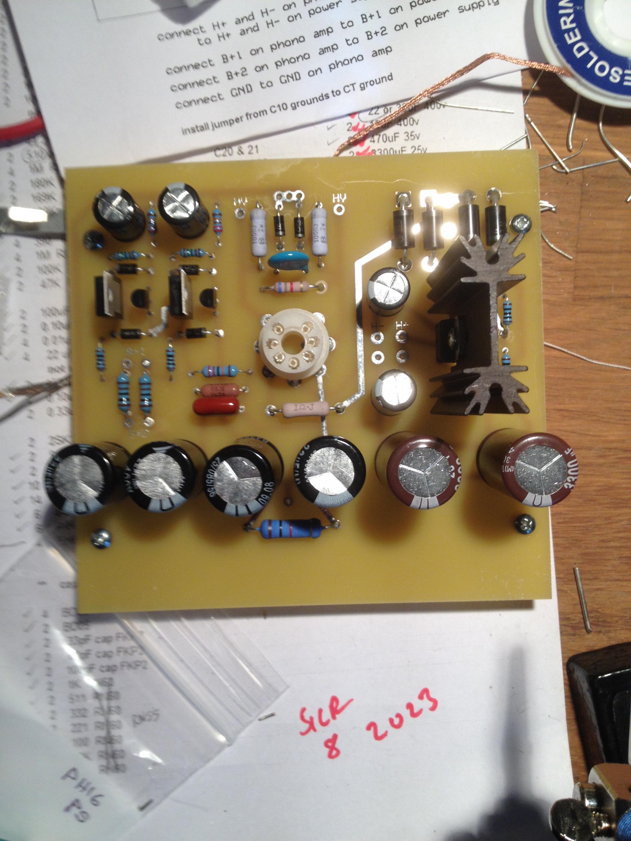

Stage One:
As it has been decades since i have picked up a soldering iron I decided to start with the Power supply first, after cleaning the boards with the isopropyl alcohol (to remove grease/fingerprints etc) putting on the standoffs I started.
all resistors first, then diodes and capacitors..
Just a tip for anyone wanting to use the silver lead free solder, make sure you have a powerful enough soldering Iron as the silver solder has a higher melting point than usual lead multicore solder ie savbit.
all went very smoothly and here is the finished power supply

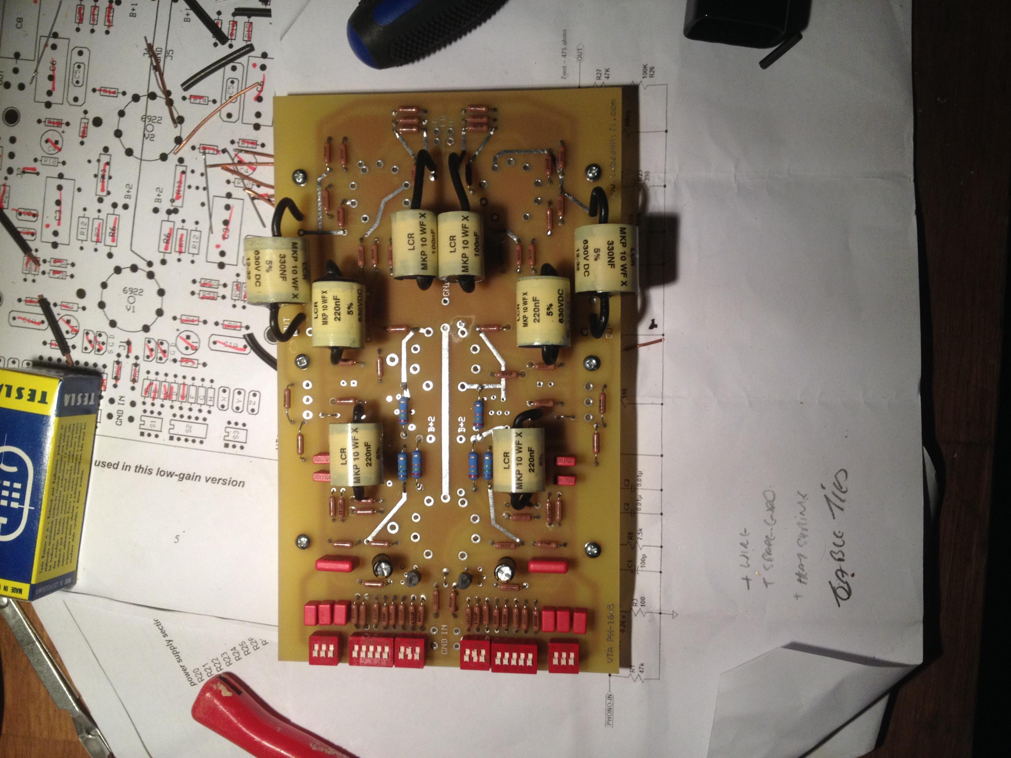

Stage 2 Amplifier section;
After seeing the bewildering choice of valves available priced from £6 a piece teslas to £100+ siemens, telefunken and amperex.
so I decided as this is my first build and getting it working was the first priority I plumped for the cheap teslas. I sourced a set of 4 from Langrex-Electronic Valves And ComponentsSpecialising In Original British, German And American Tubes. (very helpful and also supplied the 12x4 rectifier tube for the power supply.)
On Roys VTA instruction parts list i noticed there was an option to upgrade the signal path capacitors to sonicaps , so i decided to do a bit of research and again was stunned at the choice and price range of audio grade capacitors.
wanting to get the best sound i could but within a budget I have bought 8 polypropylene audio grade capacitors from maplins. Search audio capacitors | Maplin
obviously not the best but i think they will be an improvement on the supplied WIMA capacitors and like the valves there is an opportunity to upgrade these as and when required.

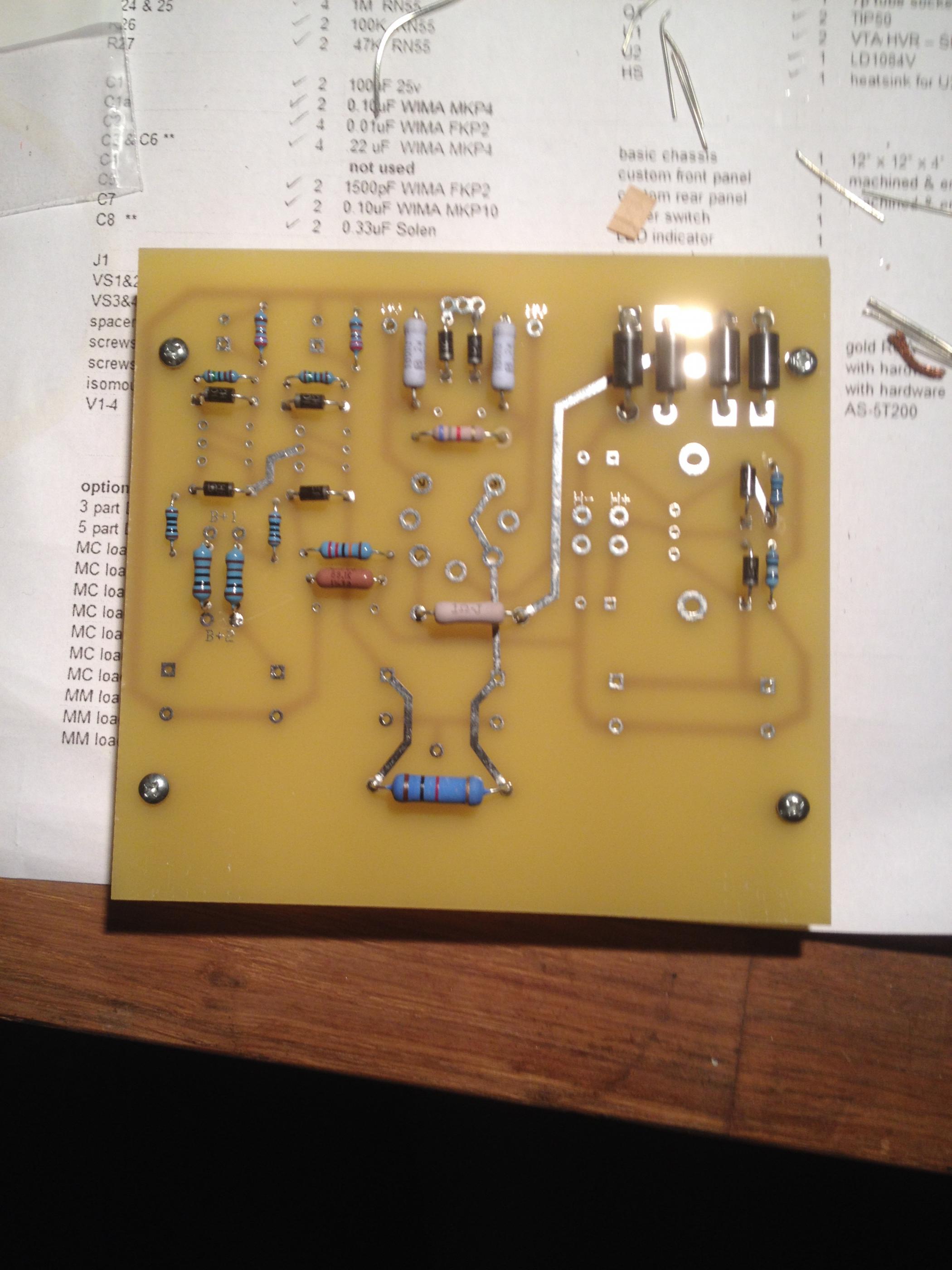

So, same as the power supply I started with the resistors, jumper leads, Dip switches then the normal and electrolytic capacitors and finished with the audio grade caps and valve bases.
Just a quick note on the dale resistors, they are not coded with the colour bands but with a 4 digit number whereas the first 3 numbers are the value and the last number is the multiplier, so;
10R0 = 10 Ω
2152 = 21.5 k Ω
2494 = 2.49 M Ω
once i got used to this it is a much quicker way of reading the values.
Anyway again everything went together well, and it is refreshing to find all the components listed to be there with nothing missing nor nothing extra well done Roy
Here is the stage build of the amplifier section:-

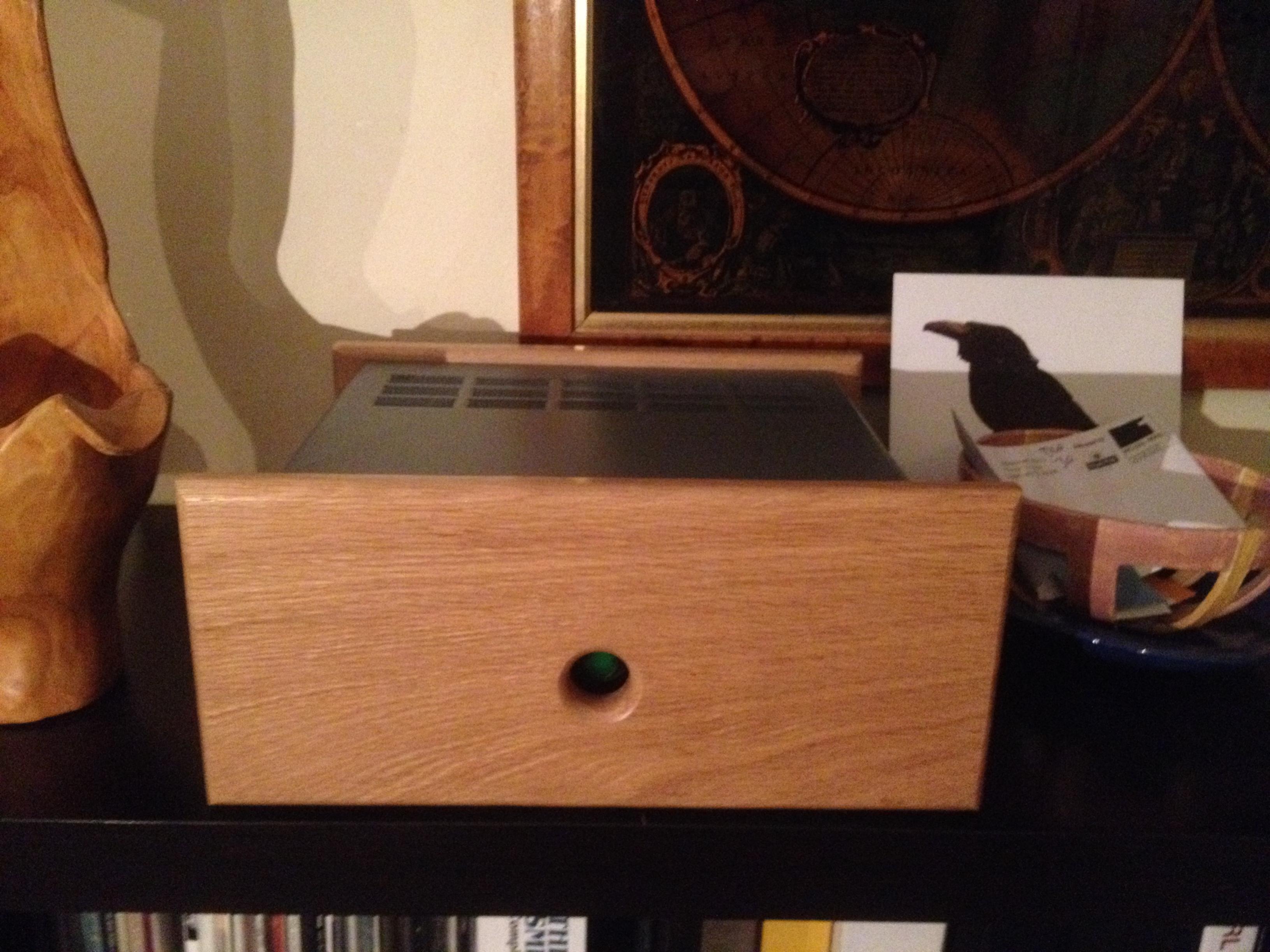

So you can probably guess from above I have decided to go with the fully enclosed chassis/enclosure.

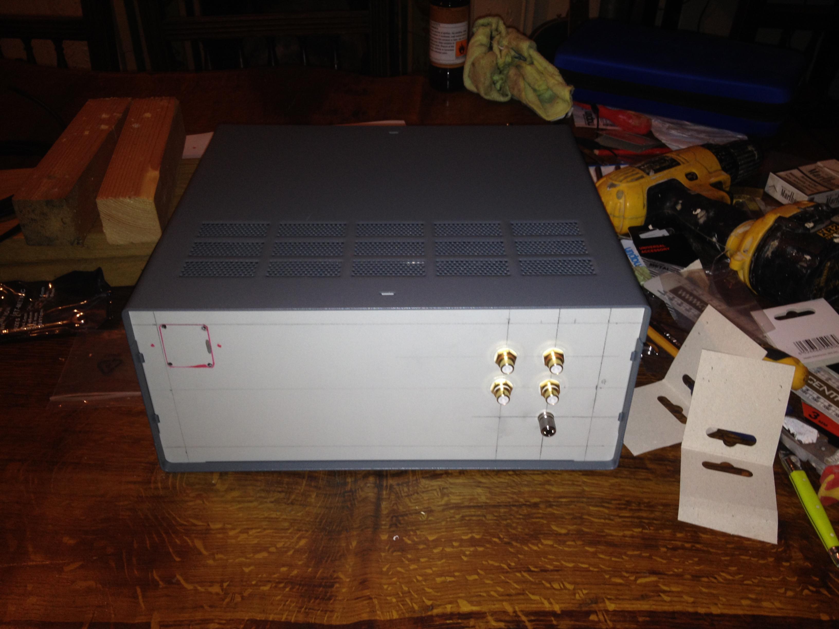

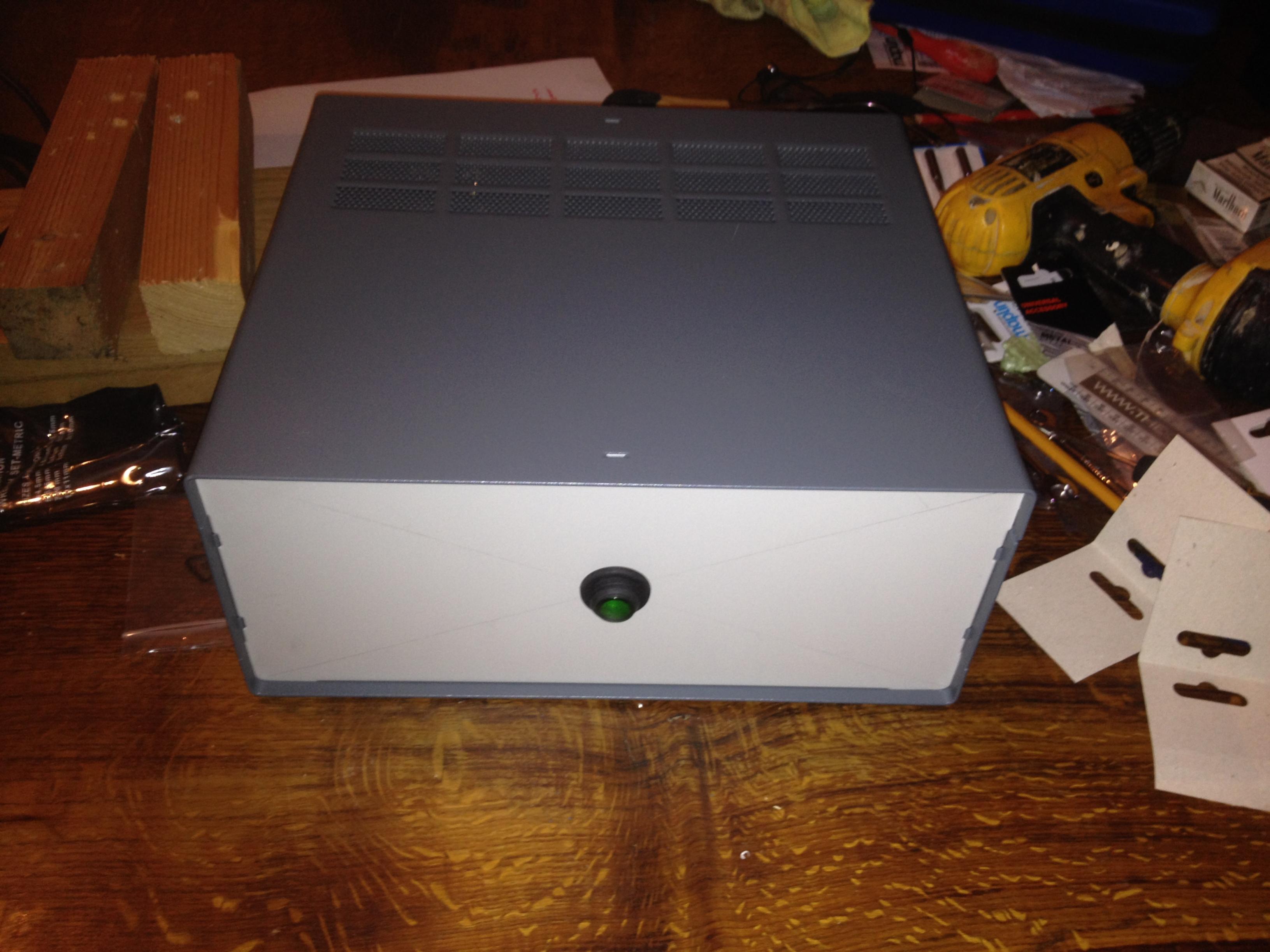

I have also decided to purchase the enclosure and this was my first choice High Quality Enclosures for Audio, DIY Hi-fi & Electrical projects
but at nearly £140 for the enclosure the cost was too prohibitive.
so after a lot of trawling the internet and sourcing the other items i needed (rca plugs, IEC inlet filter, Mains inlet plug, on off switch ) I found this Buy General Purpose Enclosures 3Ux279Dx305W Electronic Enclosure RS SAC3.0D2W2 online from RS for next day delivery.
£33+vat much more like it!
A boring box but with excellent ventilation.
So now to "tart" it up

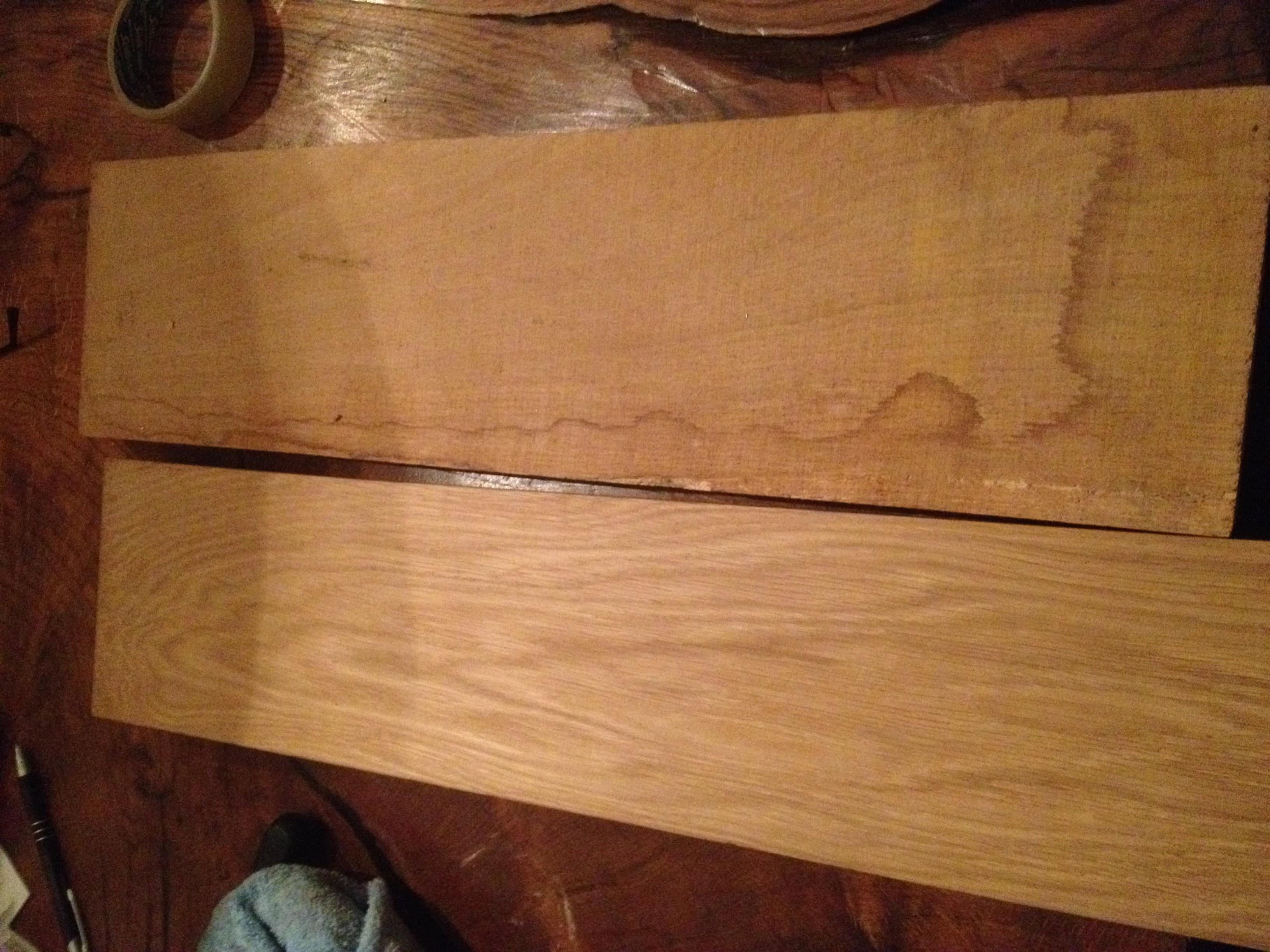

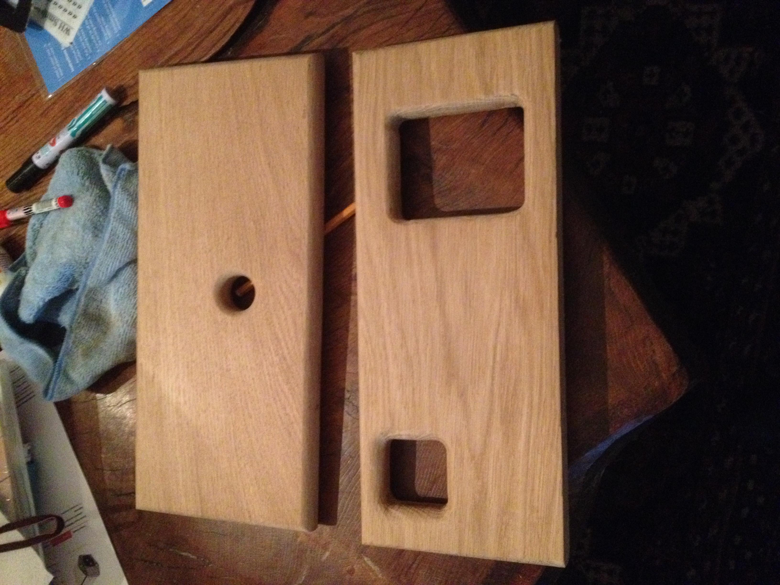

Two lengths of oak plank offcuts blagged from my local Joiners and a few hours with a sander, router and some beeswax I have ended up with this(see if you can spot the not so deliberate mistake!):-
Tomorrow, Putting it all together

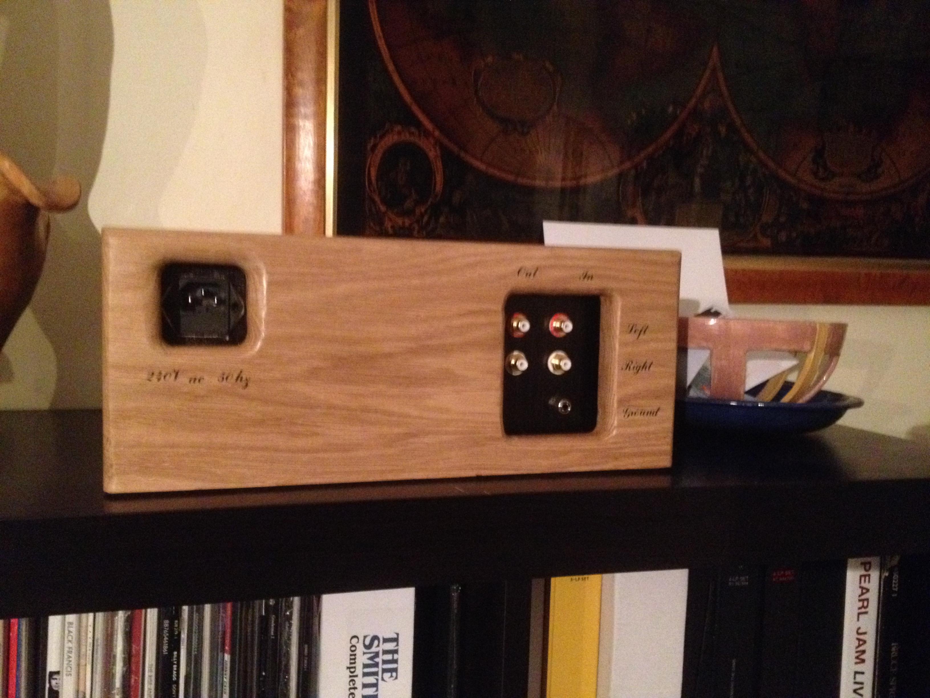

Stage 4:- Putting it all together
First i fixed the wooden fascia to the chassis so the fascia is not quite touching the chassis but is held away slightly from it with foam rubber pads, my theory is that any ringing or vibrations that can effect the chassis will be damped by the foam and dissipated through the wood. probably snake oil but who knows!
All the components in place so the first thing i did was to clean all of the solder joins of flux with isopropyl alcohol and a toothbrush, it needed a couple of goes to get both undersides of the boards spotless but for me worth the effort.
Now came what i found to be the hardest part of the build; connecting transformer,power supply and amp section together.
first I placed all parts and drilled the holes in the chassis then cut the connecting wires to length. Now for the next stage you need good light, and a clear workspace!
there are 24 places where wires need to be connected to the circuit boards and if you make this kit don't make the mistake I did. there are a number of places where the hole for the wires is right next to a component hole. in two of these holes the solder had creeped into the wire hole when soldering the component, so probably 30 minutes wasted with desoldering braid to get those clear before i could put the wire through.
The other thing I would do with hindsight is to solder the input/output cables into place from the top of the board rather than from below (like Roy has for the inputs in his pictures) as the cable I used was Low capacitance coax cable from maplins Coax URM76 50Ω Low Capacitance Cable Black (priced per metre) | Maplin which is stiff and awkward to bend and as they are touching the bottom chassis it defeats the point of the isomounts supplied with the kit. I will be changing these over.
the wiring just needs a bit of planning and thought before you start if you do that it should go hitch free for you.

B+1 recommended 180Vdc actual 177Vdc
B+2 recommended 175vdc actual 169vdc
I emailed Roy as I was worried about the slight variance and he replied as quick as ever that these were good voltages.
It was getting late at this point so the unit was unplugged and and the part that matters (the sound testing) starts tomorrow. I will not give a review of the sound quality until I hear that the phono stage components have settled down so you will have to wait for a week or so till my full review is posted.
for now here are a few pics of the internals:-

Tips.(for beginners)
Cleanliness, make sure circuit boards are clean with isopropyl before starting any soldering.
Make templates on paper of the mounting holes from the circuit board before starting
put the standoffs on the board before soldering it makes it easy.
Start with the smallest components (resistors) and finish with the largest (caps, valve bases)
twist the wires by putting the ends in a portable drill and holding the other end. (much more even twists)
check off the components on the stock list as you go
take time planning the layout in the chassis before wiring everything together
if in doubt email Roy...............great support
KIT REVIEW
Clear concise instructions, circuit diagrams, and component plan.
components within close tolerances and packed in separate bags for each stage of the build.
Quality through hole circuit boards and mounting hardware.
Easy to follow and I did not have any problems with the build at all.
As a kit highly recommended. and to be honest if you are slightly handy and have a bit of common sense I would say a beginner would not have too much trouble making one of these.
By the way it works as well!
