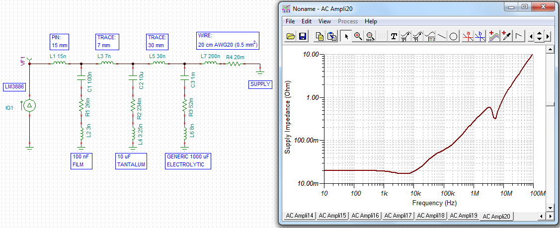

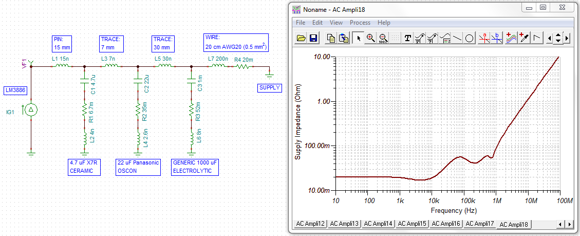

Attached plots show the supply impedance as seen from the LM3886 die looking out through its supply pin. The bypassing in the first picture is a 4.7 uF X7R ceramic capacitor. About 7 mm from the ceramic cap is a 22 uF Panasonic OSCON cap, then 30 mm further away a 1000 uF generic electrolytic can. From this point, the supply is connected through 20 cm (8") of AWG 20 (0.5 mm2) wire. The supply is assumed to be ideal (zero output impedance) as I'm only looking at the decoupling network. Any real supply will only degrade performance.

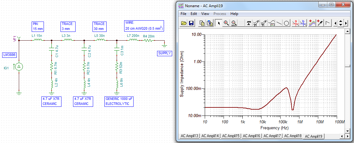

The second picture shows what would happen if we used two 4.7 uF ceramic caps in parallel. They are physically smaller than the electrolytic cap, so they can be placed closer - 3 mm apart.
Finally, the last picture shows the supply impedance with the bypassing network recommended in the LM3886 data sheet (100 nF film cap, 10 uF tantalum, 1000 uF electrolytic can).
The parasitics for the various components, I obtained by measurements on an HP4194A impedance/gain-phase analyzer and/or from the manufacturer's specs.
As shown, the 4.7 uF ceramic (TDK P/N: FK20X7R1H475K) + 22 uF OSCON (Panasonic P/N: 35SEPF22M) + generic 1000 uF, 35 V electrolytic can provides much better performance than the network recommended in the data sheet. The ceramic cap is $0.86/EA @ QTY=1; the OSCON, $1.05/EA @ QTY = 1 according to Digikey.

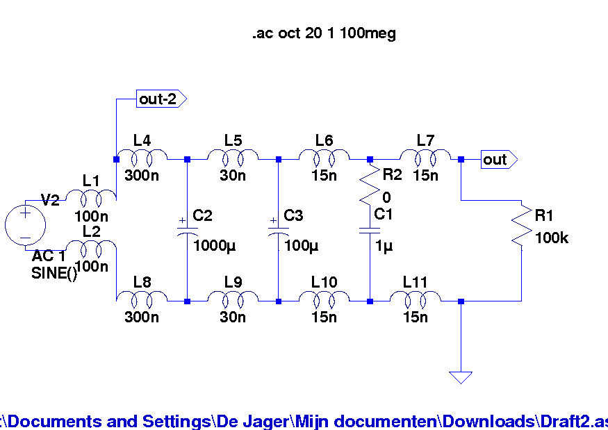

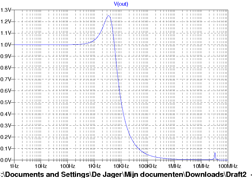

I stumbled on this sometime back when doing some sims of the speaker return location. A bit scary is that the resonance is in the audio band. The largest cap seemed to cause most of the resonance. Lower capacitance and or ESR just made things worst. I used a Nichicon 1500uF, 100uF and a TDK 1uF X7R.
Maybe of some help here.
Mark,
all three capacitors are shown as "perfect".
How much does the peaking change when you add a little ESL and a little ESR to each of the capacitors?
The inductances are way too large and it needs a snubber at the AC input (and maybe some extra ESR...)
