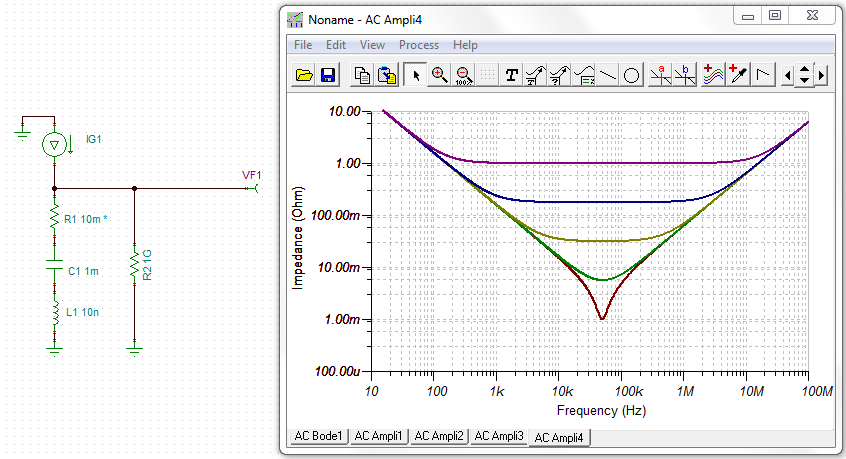

Depends on your criteria for "work better". Attached is a graph of the impedance of a cap as function of frequency and ESR. The lower ESR, clearly provides a "better cap" - i.e. lower impedance. However, the lower ESR also increases the Q of the resonant circuit.
A Q of 0.5 provides the flattest time domain response. I'm not sure that's what you actually want, but a Q in the range of 0.5~1 is probably a reasonable FOM.
Q = XL/R --> XL/2 < R < XL, where XL is the reactance of the ESL at the resonance frequency f0: 2pi*f0*L.
~Tom

A low-ESR capacitor is a better cap ... until it is paralleled with other caps... which creates an antiresonance peak. Lower ESR, higher ESL, and higher distance between capacitor values give larger peaks (higher Q).
So if you choose to target a specific impedance (or simply wish to avoid nasty resonances), choosing a too low target impedance will need lots of caps, at which point the contraption will get larger, connection inductance will matter much more, and you'll need power and ground planes, etc.
That's why "controlled ESR" ceramics start to appear, with ESR in the 10-100 mOhm range, and specified with a reasonable precision. This way they can be paralleled with much less problems. Unfortunately this is a new product, so for the moment they are prohibitively expensive...
Some of the OSCON type caps are available in a controlled ESR option as well.
The anti-resonant peak. Yeah that makes sense. If each cap create a deep notch with steep slopes, you need many caps close together to smooth out the resulting impedance curve.
