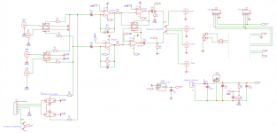

DHT heater supply design
Greetings to all,
I have developed a board for a heater supply that is capable of 1.5A and can be upgraded to higher currents by substituting a different part for the LM337
Its a mix of known circuits, and works pretty well in testing, there are currently half a dozen of these modules operating, and the first feedback is positive. With some raving reviews from some friends that have tried these in their amplifiers.
See the attached circuit diagram, its essentially a TL431 reference, biased by a LM337 in the negative lead, followed by a current source that is voltage driven by a comparator through a low pass filter.
The diode D4 increases the voltage over the current source by another 650mV or so, so the 2SC6144 transistor is in its linear operating region.
Diode D3 serves to keep the current ramp up characteristics of the current source independent of supply voltage, this means the circuit will have a nice soft start characteristic whereby the current is brought up slowly, keeping thermal shock of the filaments to a minimum. Furthermore it also provides a limit to the amount of current that a cold filament can draw during start-up.
R1 and R2 are the current sense resistors, with a 1n4148 for D3 the maximum drive to the opamp-transistor current source is about 650-700mV depending on exact supply voltage and diode production lot. This will yield a short circuit current of ~2A for the current source with the values as per the schematic.
Current source frequency compensation
R4 C1 serve to make the circuit more stable with light inductive loads, i have not optimized the value of C1 very much because the circuit seems stable with leads in of several meters.
Upgrade to 2.5A
By replacing R1 and R2 with 390mOhm 2W metal oxide resistors and replacing the LM337 with the 3A LT1033 allows for 2.5A of current.
Circuit advantages,
One of the advantages of the LM337 pre-regulator setup is that the voltage over the 2SC6144 transistor is tightly controlled by the circuit which increases reliability, and furthermore the input voltage is not too critical because the LM337/LT1033 both have internal over-temperature protections.
The diode clamping on the output of the comparator yields very nice startup behaviour on most directly heated tubes.
Noise is also very low, i cannot measure it very well with the limited test equipment i have available for the job, but most meters agree its somewhat lower than 100uV. With some popcorn noise visible on my Rigol oscilloscope.
Disadvantages
This circuit is not exactly efficient, by deleting the pre-regulator and lowering the value of the sense resistors, dropout could be lowered to half a volt. enabling the supply to run from AC to DC in most 5V and up DHT's
try the circuit yourself,
I have lots of boards available, and can also provide kits with all the components needed to build this circuit yourself.
There is a group buy for these regulators here: Group buy filament regulator for DHT tubes

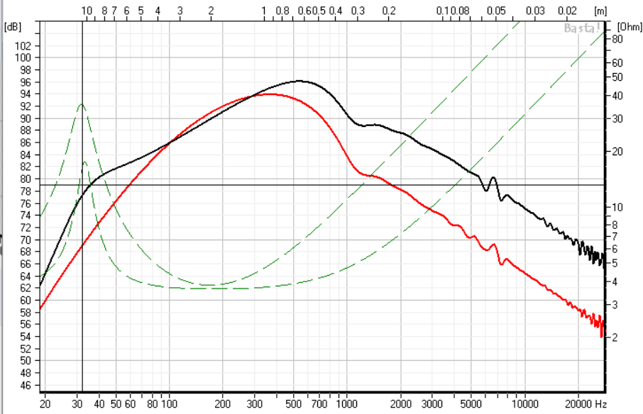

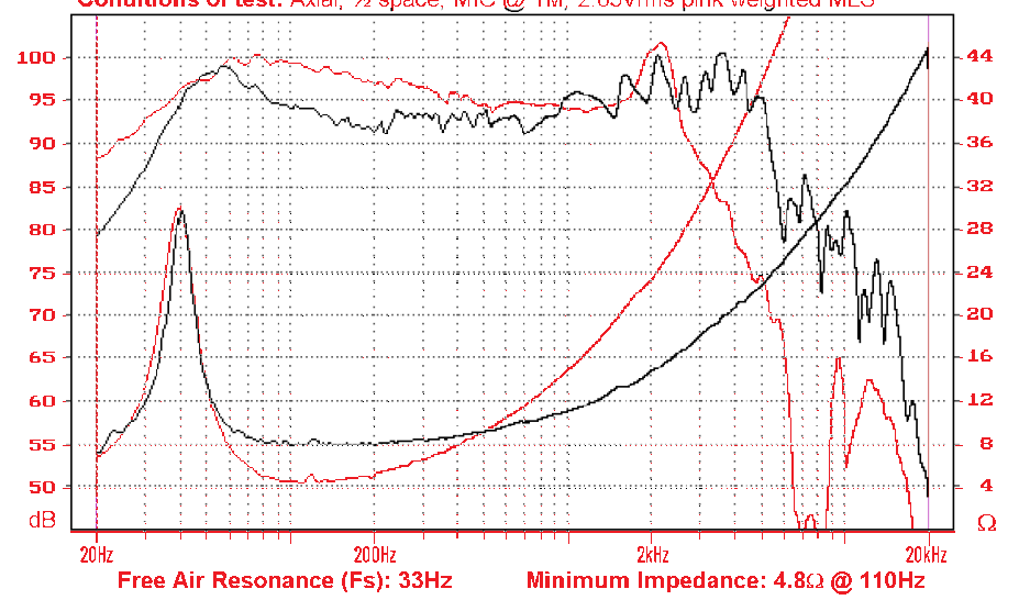

AR woofer query??
The thread about the AR7 has made me realise that I don't actually know how to tell an acoustic suspension driver from any other type of closed box driver.
So what are the small signal parameters of an acoustic suspension woofer apart from an a low Fs.
As far as having a low Free air resonance I don't remember any 12" woofers lately that have one as low as 17 or 18 Hz, even my Kicker EX woofers are only 25Hz

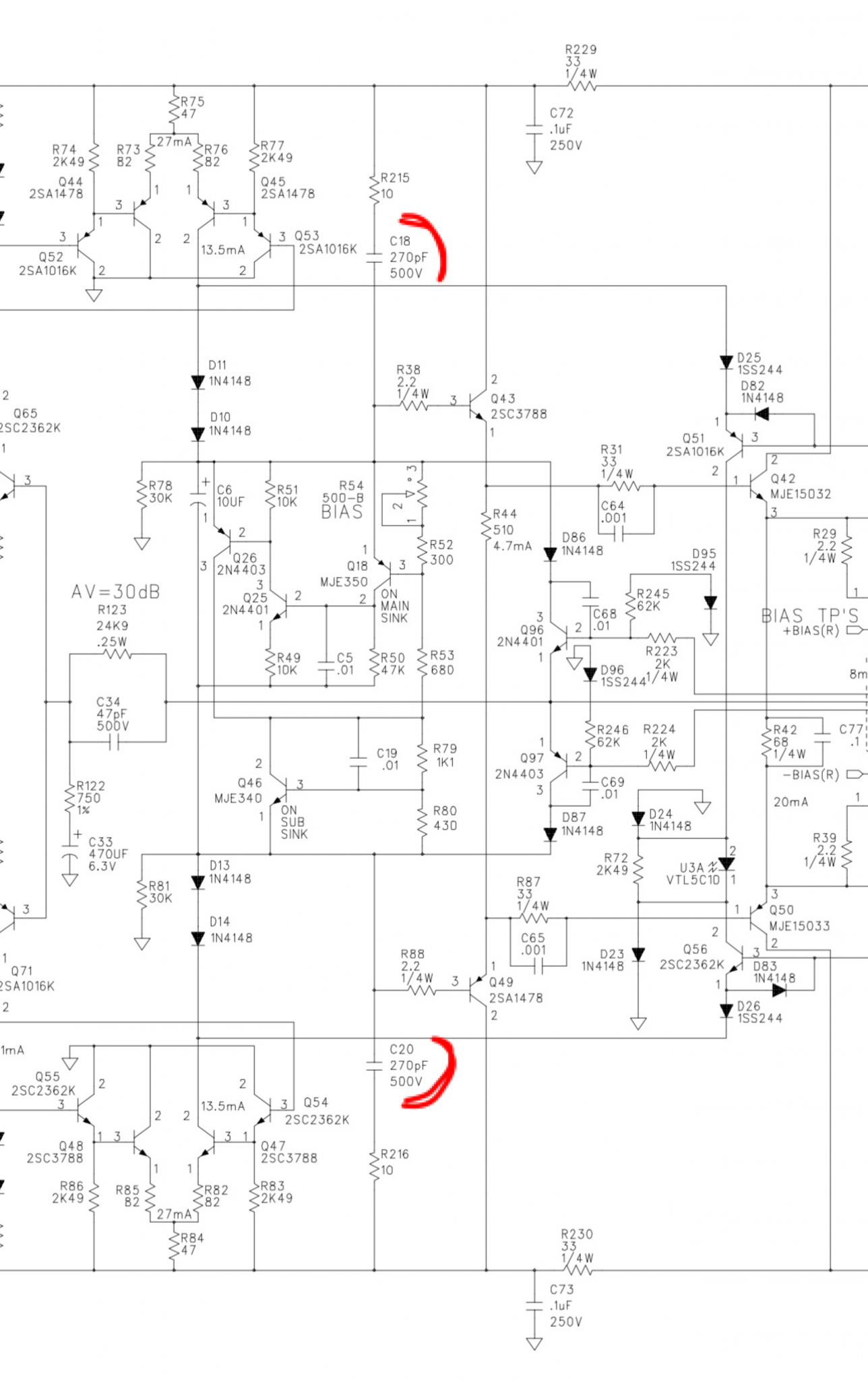

Kirksaeter Moderator 150.200 DC Offset and Bias
So I got this exotic and we'll sounding amp, it came with original user manual where the schematic is depicted (yet it was built with significant mods) but much is left to the operator.
Well, output stage is a push pull of parallel power transistors ( one channel has 8, between mje3055 and mje2955), and since this design is new for me, I'd like to ask how regulate DC offset (looks like I've got two pots per channel, totaling 4) and proper values for the bias (here i measured the emitter current through the emitter resistors as usual), which are nowhere to be found.
Please find attached a schematic ( remember, output transistors are paralleled, not depicted) and the actual board.

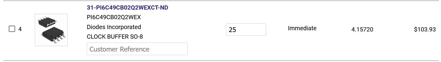

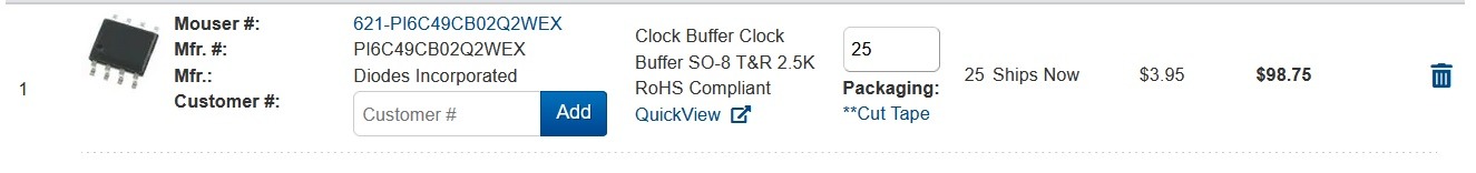

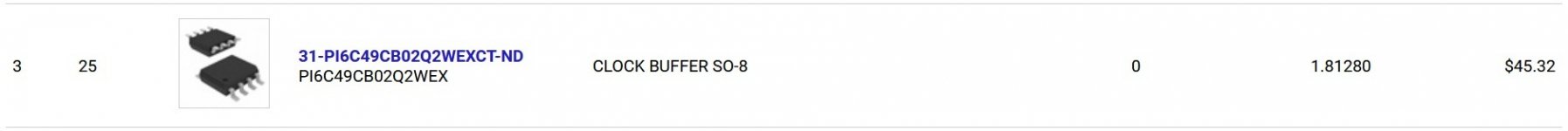

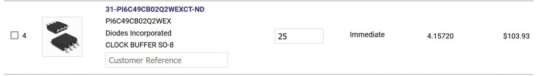

Found even more "audio boosting" goodies from ali.
The first one speaks for itself. Ngl i like the look of it and 8$ for a single dip8 chip cover.
Second is a "HI-END Audio Buffered Dual Op Amp Upgrade". Well this thing puts a second dual opamp as a buffer. It have 3 tiers of "grade of quality", the tiers are :
PG=Professional Audio Grade, IG=Instrument Grade, AG=Aerospace Grade and it increases in price as well. PG : 26$ IG : 46$ AG : 87$. The only thing changes are the capacitors.
Third one is a same type board with some added capacitors from the same seller. This one comes in 2 types, single or dual opamp and it comes in the same 3 flavors of PG,IG,AG.
The simpler one is PG : 10$ IG : 18$ AG : 36$ The one with the extra extra caps are PG : 15$ IG : 26$ AG : 47$ They probably create more problems than increasing sound quality.
The last one is a "High End custom opamp". Well its a mystery chip with some added capacitors since they sanded down the text. In one pic they kinda failed and some numbers are still visible on the chip. First row ???82, second row ???603. Surprisingly this one does not have the 3 grade but the price is just ridiculous. Left: 129$ Right: 214$
These are some nice "inventions" but the chance of them doing anything good is very low. I'm 100% there are even more of these out there that i haven't found. When i searched for the name, the first thing that popped up was a "vibrating phone app for women" so yeah.
EDIT: Trying to fix the pic ratios.

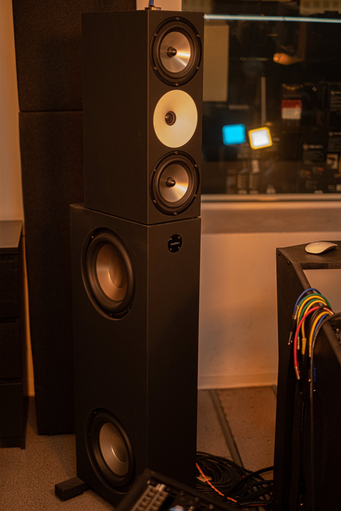

Fully active 2 way soundbar with MFB woofer
Hello all,
I would like to share the building result of my fully active 2 way soundbar made for my son. It is based on basic miniDSP 2x4, Wondom class D amplifiers, Dayton Audio PS95 wide range speakers and motion feedback old speakers Philips AD7066/W4 MFB.
The result is pretty impressive for the size and the sound is quite clear. I think I can make some improvements regarding filtering but it is already good !
Inputs are : analog (from miniDSP board), USB (miniStreamer through SPDIF), Bluetooth (TinySine through SPDIF), SPDIF coax and two SPDIF Toslink.

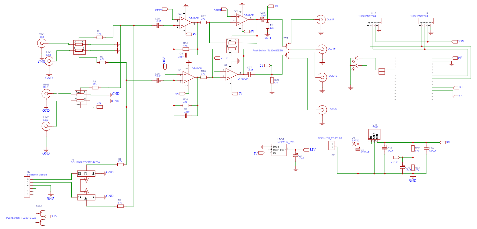

EQ Baxandall circuit
Hi all,
I need to build an EQ circuit to cut or boost LF and HF in a portable boom box system. A Baxandall EQ will do the trick. The circuits for a stereo signal are obviously two, with the need of stereo potentiometer.
My question is : would be ok to convert the L/R signals with the help of a summing amp into mono and then having just one EQ circuit with mono potentiometer?
How can I then convert the mono signal back to stereo?

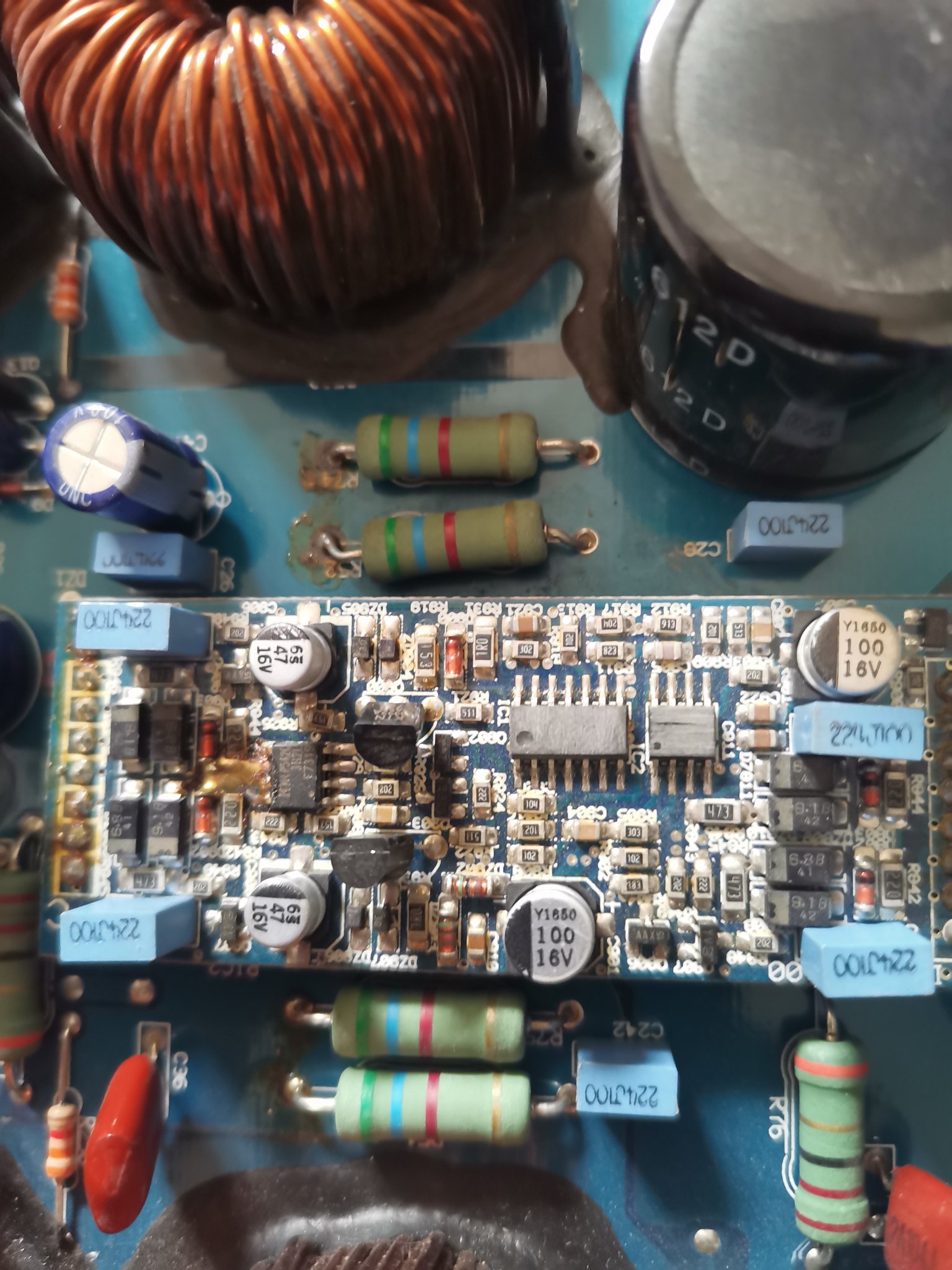

JBL PowerBass PB12 repair tips (aka how to get a nice sub for $42!)
The following experience applies ONLY to Revision 2 of the JBL Class D amp! Revision 1 uses an AMI module (rare, expensive and junk!) while Revision 2 uses a discrete output stage.
These tips may be useful with JBL E250P and JBL P12SW amplifiers as well. They are almost identical. Some component numbers may have changed but the topology is identical.
I bought this sub from a local electronic junk shop for $25 with a tag "lights up, no sound". My kind of project! It even had my Electronics I professor interested.
Upon disassembly, I found a badly damaged output filter. The caps in the first stage of the LC filter were destroyed. The NP electrolytic (C72) was vented and the SMD ceramic (C71) had been set alight with visible flame damage to the board. Ouch.
If it was just the electrolytic, I'd have chalked it up to cheap caps. This was obviously not that simple....I checked the output stage. To my surprise, the MOSFETs (IRF640, Q18, Q22) were good!
My attention was then drawn to a darkened section of the board in the power supply. It was obvious that the two large power resistors, R6 and R9 feeding the aux supplies had gotten extremely hot. They had burned the solder mask from the traces near the connection points but the traces were intact. The solder joints were in very poor condition. Suspecting a short, I tested the transistors and Zener diodes that were part of the simple pass regulators. (D6, D7, Q2, Q3) They were good. I replaced them anyway as it was obvious that they had become extremely hot.
I then changed out the caps in the aux supplies as they were also exposed to the excessive heat. (C9, C4, C2)
The resistors were also swapped out. They had become so hot that the color bands were discolored, almost like being sun bleached. I ordered them as prescribed in the service manual and I was surprised to see that the ones mentioned in the service manual were far larger than the ones originally installed. The schematic calls for a 1.2K 3W for R9 and a 1.2K 5W for R6. The ones installed from the factory looked to be 1 and 3W respectively.
The main filters were over 10 years old and only 85C units mounted near the heatsink, I figured these too should be changed for long term reliability. I used 105C units of slightly higher capacity. The board is silk screened for larger ones. A common 4700uF 80V fits just fine and inrush is manageable.
The flame damage was scraped away and the hole in the board filled with silicone. A new SMD cap was added 2mm away. A film cap was put in place of the 6.8uF NP electrolytic as that exact size wasn't obtainable locally in an NPE cap. The other NPE cap, a 4.7uF unit was swapped out for a new one. (if it fails, the output stage could fail with it)
Testing time....click...lights dim...bright flash. Dead. Uh oh. I made it worse, the outputs have failed shorted.
I realized that during the cap replacement,the via feeding -Vs to the aux supplies was removed with the old cap. They are very fragile on this unit; be careful! Fixing this allowed me to pop in a spare set of MOSFETs and try again.
Click...green lights! It's working...wait what's that noise? Before I could verify my input source, I was again greeted with the bright flash of a fuse blowing and I decided to shelve the project for the night.
The next day, I got smart and decided to test the waveforms. Clearly something was causing both outputs to simultaneously turn on. So with MOSFETs removed, I started testing ALL the little supplies. I found the mute voltage grossly out of spec and a badly deformed wave coming out of the modulator op amp (pin 7 of U6) I now had a lead on the MOSFET killer.
The culprit ended up being a small SMD transistor on the other side of the board that failed partially shorted. If I recall, it was Q26 and it was in the region that was overheated from R6 and R9.
I put in a fresh set of IRF640 MOSFETs, put on some silicone thermal pads (lower junction resistance than a mica+grease), bypassed L5 as prescribed in the service manual, swapped out C65 as a preventative measure and fired it up. Neighbor relations are at an all time low...luckily I've figured out when they go to class. 😀
So here's the condensed version:
When faced with a PB12 with the R2 board, replace R6 and R9 with the proper wattage resistors. This was the initial failure. Their heat caused Q26 to fail and also discolored the board. The failure of Q26 led to the modulator not working well, which destabilized the OPS. If changing the main filter caps, verify via continuity. Use a jumper if you break one.
For reliability's sake, change ALL the semiconductors and electrolytic caps in the overheated region. If the aux supplies go down, this amp will likely self destruct and the parts are inexpensive. C65 is critical to the half bridge driver (IR2111) and should be swapped for something newer to improve long term reliability as well. If you have a turn on chirp, C65 can be downsized to 47uF. (see E250P service bulletin)
Verify that a 100kHz 24Vpp square wave exists on pin 7 of U6 with respect to the negative speaker terminal. Bypass L5 if present via a thick jumper wire or just desolder L5 and use the single winding as the jumper after removing the ferrite. (This is far more elegant than a jumper, IMO). Install MOSFETs ,a new 2A time delay fuse and enjoy.

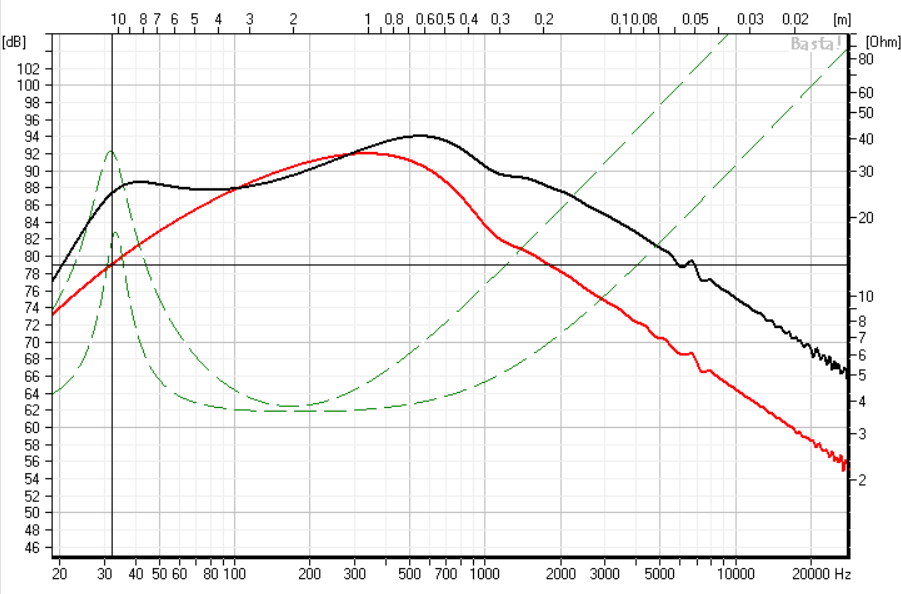

How do I lower tuning frequency with the same port?
Hi.
I'm building a subwoofer enclosure in my car, but I only need advice for normal ported box designing.
The box will be build inside of the trunk, so I can't precisely predict how big it will be.
I am estimating it would be between 180 and 250l big.
I have 8-10kW of power, so I need as big of a port as possible.
A 12" port would be Ideal, but it would be too long and take up too much air space inside the box, so I'm going with a 10" port.
I have had trouble finding one, but I finally did. A flared port with the inside diameter of 24cm, but it's only 50cm long.
I haven't really decided yet, but I'd want a tuning frequency of around 20-28Hz.
According to WinISD, if I get 250l out of the box, I'd get a 28Hz tuning with a 50cm long port.
But if I only get 200l, I'd get a 32Hz tuning.
Now this isn't that big of a difference, if the range was closer to 20Hz.
Now my question is, how could I lower thee tuning frequency?
I can't make the box bigger. I can't make the port smaller, because air velocity is already at like 60-70m/s.
I don't want to make a slot port, because the shape of the box is so odd, it's be hard, and I don't have the tools to round off all the edges easily.
I have heard, that by putting the port closer to one corner, or closer to the back wall, you can effectively lower the tuning. Is this true?
If so, how would I calculate the difference? Can HornResp simulate this somehow?
Are there any other ways?
They don't mention the outer diameter, but could it be, they are using normal waste pipe?
Could i saw the port in half and use waste pipe extenders to make it longer, without the integrity and air flow suffering too much?

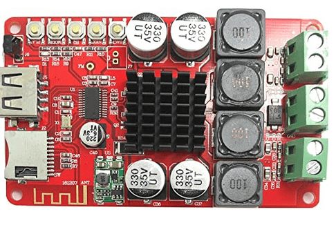

Fake chips: what has not been counterfeited yet?
Hello everyone,
I have been looking for cheap yet nice amplifier boards on Aliexpress and other chinese websites and I have seen many obviously fake chips.
One example is the TPA3116 32 pins often replaced by a replaced by a CS8673E 16 pins, but easy to hide as the boards come with a heatsink.
Another example is the TPA3118 that has 32 pins but is often replaced by another chip that has only 28 pins.
The forum is full of people complaining about fake NE5532

how do I find/estimate the transformer requirement for my relay attenuator?
as above.
to make sure everything works, I tried a spare 100VA transformer and it's working as expected. Obviously, that' overkill for this use so I'm wondering what's the minimum I can use.
quick glance looking at the main parts
  1. a bridge rectifier of unknown make/model (markings D4A60)
  2. 1x 7812 regulator (tracing the PCB, the output is sort connected to the other end of the relay coil (all 8 relays) via a diode)
  3. 1x 7806 regulator (The ADC0804 below has a max voltage of 6.5V. it's a good guess that this chip is powering that)
  4. 8x Omron G6S-2-12v (looking at the datasheet, the rated current on Page 2 for this model is around 11.7mA)
  5. 1x ULN2803APG (8ch Darlington Sink Driver - looking at the PCB trace, its output is connected to one side of the relay coil)
  6. 1x ADC0804 (pins 11 to 18 are connected to the input of the ULN2803APG)

866A rectifier: help needed
I need some help with the 866a rectifiers. My schematic is below. Here are some measurements.
HV Tx AC = 120Vac
Filament Tx AC = 120Vac
5Vac Filaments. Looks good.
Point A to Ground = 0Vdc
So, I know something is wrong because A to Gnd should be about 800Vdc, correct? Also, there is no blue light within the 866A. Filament is glowing orange, but no blue/purple glow.
So, I then used my voltmeter and touched the (+) probe to BC1 (bayonet 1) and the (-) probe to Gnd. This measured 800V and then the voltage slowly starts to decline. What is interesting is that when the probe is on BC1, the blue/purple glow appears in BC2. Yes, BC2. So, then I tried the opposite. Touched probe to BC2 (and Gnd) and then BC1 started to glow blue/purple.
I am completely confused at this point. Thoughts?
