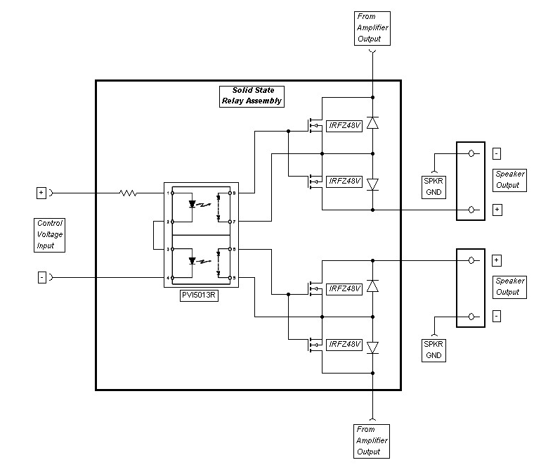

SSR used by @Bonsai in this speaker protection kit

I don't think EMR's are a good idea in an audio amplifier. Under fault conditions, you can have 10's of volts DC and 10's of amps to break and relays do not like that. They also get pitting on the contacts, so there is a wear out mechanism to consider - solid state relays have none of that. I have a commercial amplifier and one of the tests is driving a load with 50ms pulses at 60A. The protection disconnects the speaker at >60A using SSR's. This test can be repeated ad infinitum - no EMR could handle that. There are a lot of good SSR speaker protection designs on the forum to choose from.
If you just want speaker muting and are not concerned about protecting speakers under fault conditions, then use a relay, but don't expect anything more.
Here is Michael Bean's design that got me going down the SSR route 10 yrs ago
