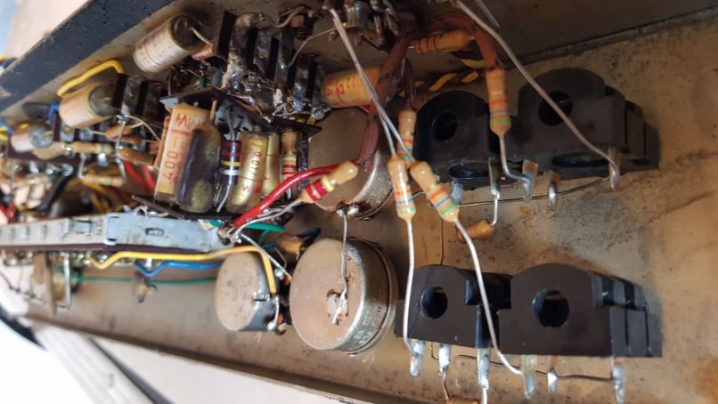

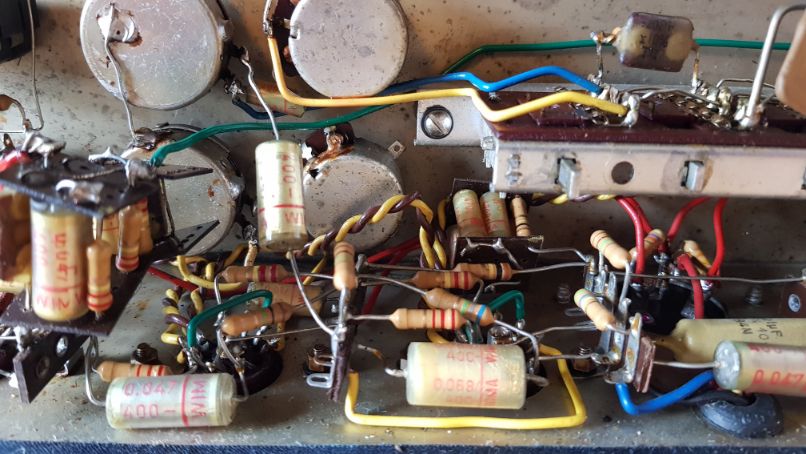

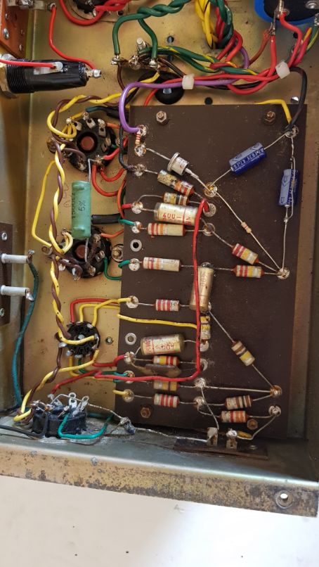

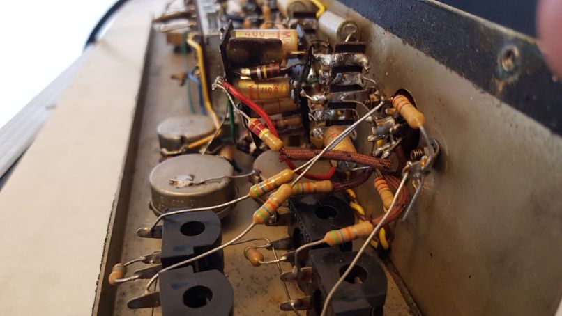

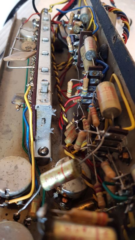

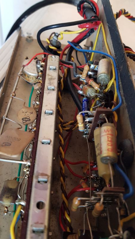

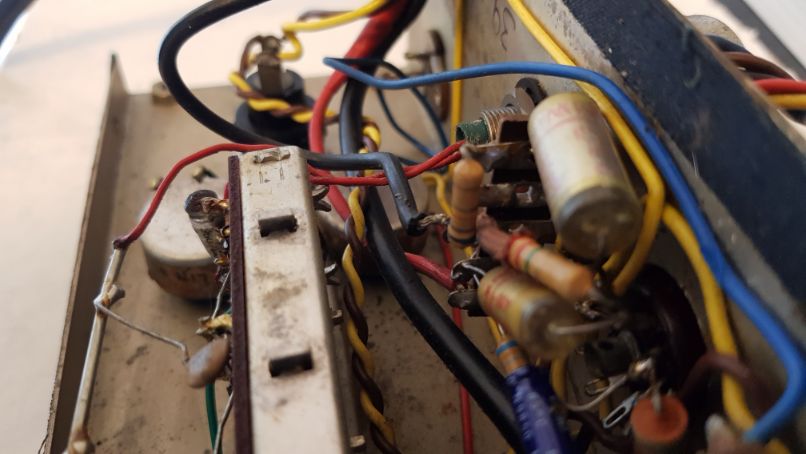

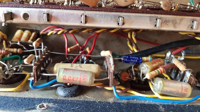

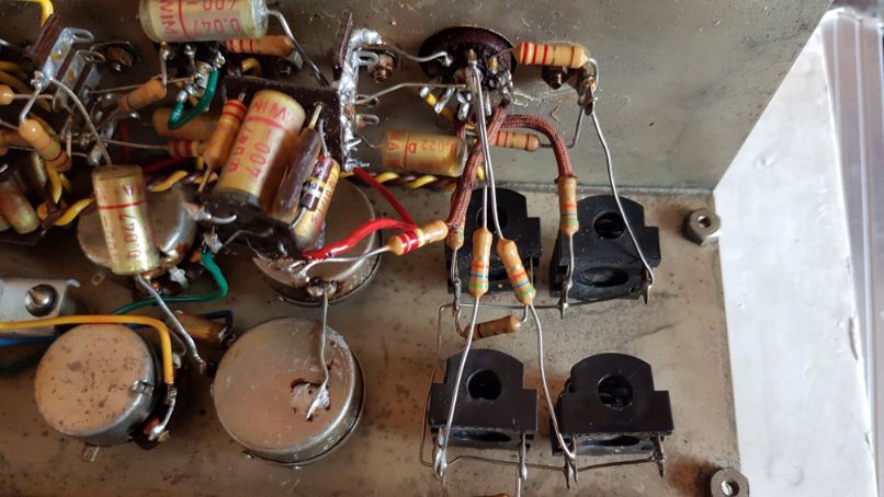

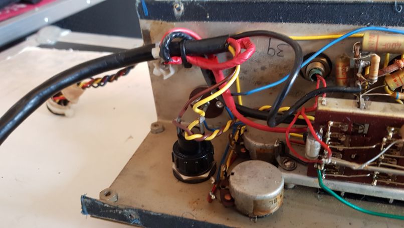

I'm working on a clone of the Selmer Zodiac Twin 30, with some minor mods/improvements. Got a good schematic to work from, but I'm looking for someone who actually owns the amp to send me some pictures of the wiring layout. I've heard this amp is quite quiet and low microphonics for one with a pentode gain stage early in the preamp, and a lot of the reason for that is the layout and lead dress etc. I'm familiar with the physical separation of the preamp and power amp, to opposite sides of the chassy (genius!), but I'd like to replicate as much of the rest of the fine craftsmanship as possible.
Anyone own this amp or know someone who does? If anyone has a similar Selmer amp from that era, such as the Thunderbird or a twin 50, I'd love to see pics of those as well - even though the circuits are pretty different, I'd imagine I could learn a lot.

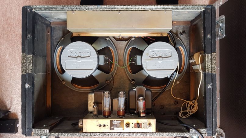

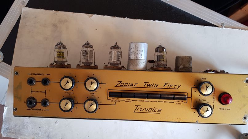

I have a 1964 Croc Skin Zodiac Twin 50 in reasonable condition, if that helps?
The power amp in the 50 is different to the 30; it is fixed bias rather than cathode bias; and the power transformer itself has been replaced; and the wiring is not totally original there as a result.
I believe the preamp sections are pretty much the same between the two though; and as far as I know the preamp in mine is pretty much as original.
What would you want pics of?

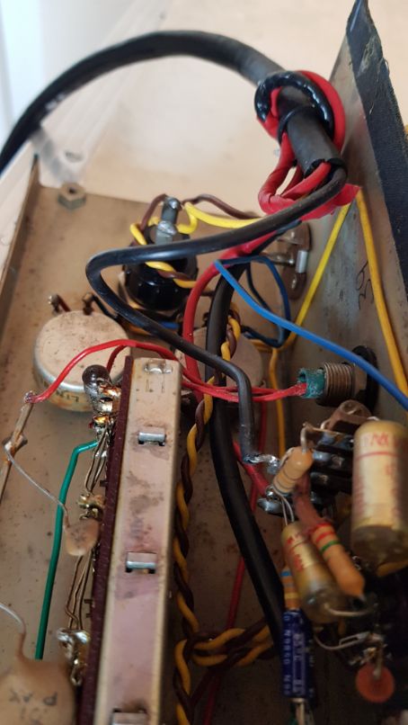

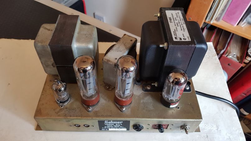

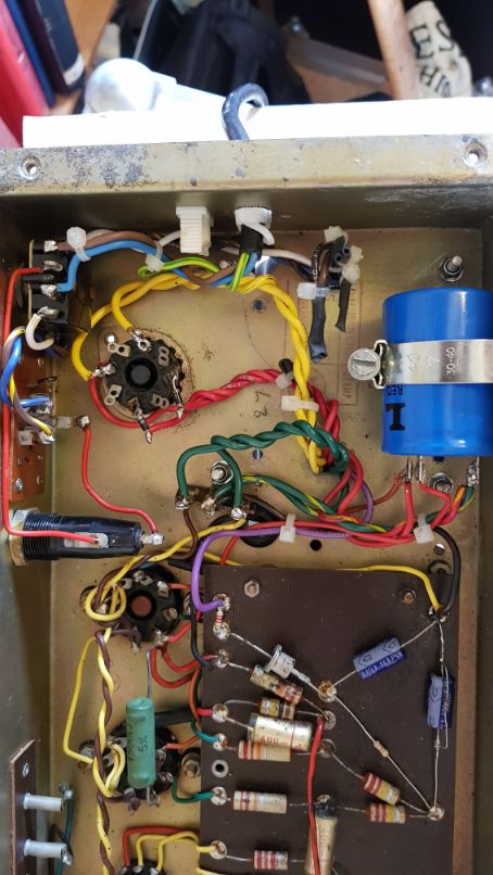

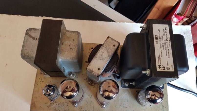

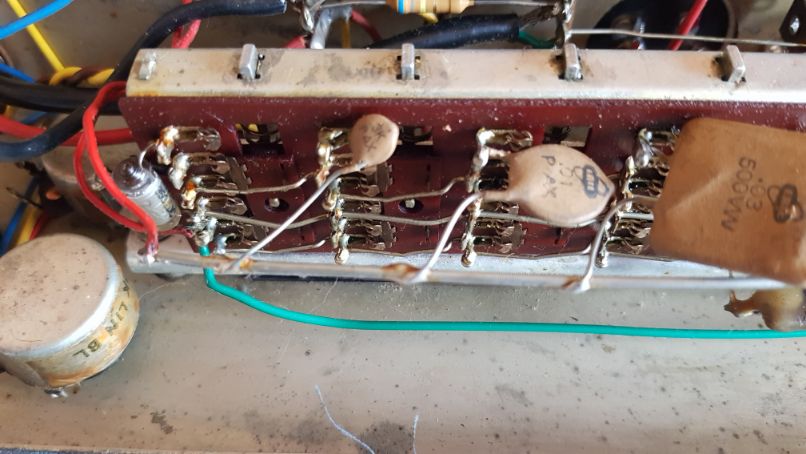

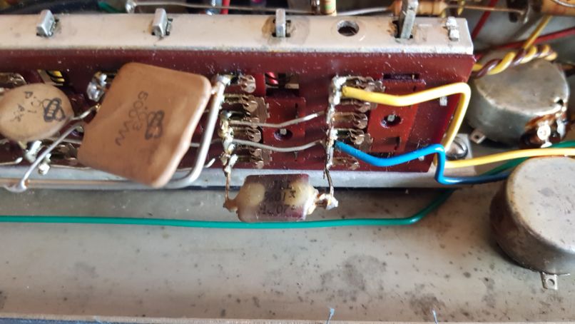

Ant, I would love to have pics of the wiring for both sections, especially the preamp. There's some very clear pics of the power amp layout from the link I previously commented on, but the preamp is so dense I could use some close ups at different angles.
Righty-ho.... took some photos of this ere Selmer.
Having trouble uploading them though. So I've stuck them onto Microsoft OneDrive; there's a link to them below.

These are excellent pics, Ant, much obliged! Very thorough. Between this and the other links folks posted, I should have what I need.
Doing my best to attach them here. I used bulkresizephotos.com reducing them to 20% of their original size, as some of them were around 3.5 Mb, to get them below the limit for JPEG's. Surprisingly, they all came out as less than 80 Kb! Even more surprisingly, they're still plenty large with good resolution. Here's hoping they come out well below:

Nice job on the posting of the images. Looks like it was the resize that I was missing; many thanks to you for sorting. :)
Hopefully the images you have are good enough that you can zoom into the details you want / need.
If I can help you further with any info for your build, then of course feel free to ask; happy to help if I can. I wish you good luck with your project - doesn't look the easiest thing to clone 50+ years later!

I think the amount of pictures you took should be more than sufficient for me to get what I need! not the easiest, no, but certainly not the toughest, and i'm going to simplify quite a bit. only going to include the second channel, for one thing, and can hopefully simplify the tone selector into some sort of custom 6-way switch.
