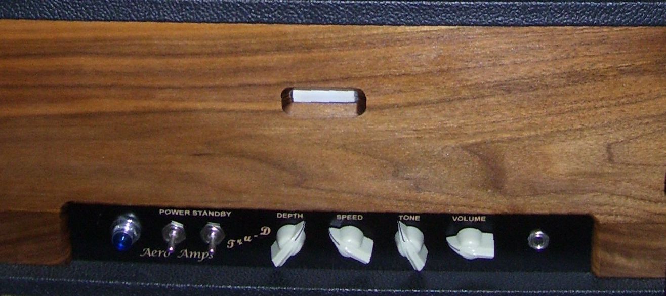

How is the clone coming along? I'm interested in building one, as well. Have you found a source for the 9.5H inductor in the tone circuit. I'm not having any luck with that yet. I ordered a PT, OT, and choke from Edcor. I haven't used them before, but thought I'd give them a try. I'm also planning to use six individual switches for the tone presets. I've read a couple of comments that it was possible to push in more than one preset selector at a time for different tone shaping. Years ago I built a version of a TruVoice Professional with an EM84 eye tube. It works great.
