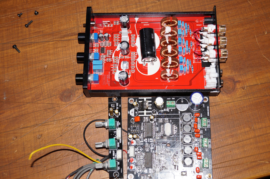

On sidenote I have purchased the 2.1 TPA3116 yuanjing amplifier and it is a waste of money.

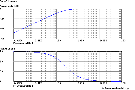

Yes, that's the first thing I have done since I have received these boards. Previously I had the cut at 1.3Hz and the bass was shy, now I have set the gain to 20dB and the cut is at 2.65Hz but it is definitly not a big difference and on my Tk2050 boards I have the hp cut set to 1.9Hz. I must be missing something or maybe I should give try on another tpa3116 based board.
On sidenote I have purchased the 2.1 TPA3116 yuanjing amplifier and it is a waste of money.[]'s
You're calling a 3 channel power amp for $22 a waste of money? Really?
As I have mentioned several times in this thread, I don't think the Yuan-Jing design is particularly good and I wouldn't buy it myself as I think they require modding of too vital many parts to live up to the chip's full potential. They are cheap though, so cheap in fact that they are less than what a large pizza from Domino's costs here.
I like the looks of the Feixiang (sp?) design much better, as I see it they require minimal, if any, modding and aren't much more expensive, just less readily available (for the time being).
I am sorry, let me explain myself.
I based my comment on the fact that you and TI have already stressed the fact that components should be located as close as possible to the chip and the 2.1 board has more than 3 times the area of a 2x50 yuanjing board that happens to be already too big.
Also I have purchased the finished version of the 2.1 board, with pots, case and stuff. I regret that I had purchase the 2.1 and the 2x50W yuanjing board at the same time, without paying proper attention to anything other than the comments on it's IC quality. I am just trying to get people aware that the 2.1 board is not the best bang for the buck and sure it is not the best TPA3116 performer.
I also may add to my previous statements concerning the TPA3116 sound quality by saying that the tripath boards I am using for comparison have been modded and are the result of a a big amount of time and money to get the Tk2050 to deliver the kind of performance I can get today. You have precisely resumed the problem with most of the Class D designs "They require modding of too many vital parts to live up to the chip's full potential". That was true with tripath and is true with the TPA3116.
Right out of the package, without mods I find the 2x50W yuanjing TPA3116 to outperform the stock hifimediy and sure tk2050 based amps in many aspects but I can't say the same about the 2.1 board.
