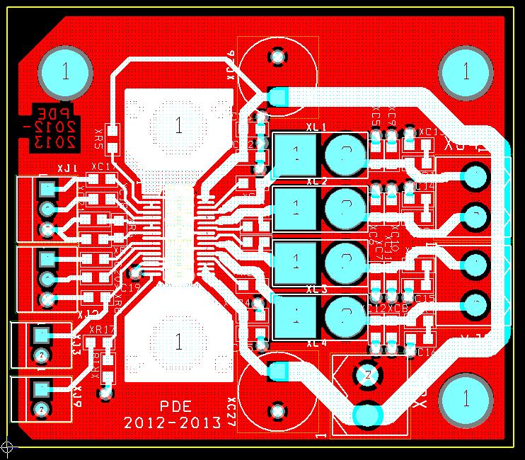

Working in a premium board
Well, I still had not the time to populate my 5cmx5cm board, but meanwhile I been thinking of a 5x10 with "premium" components... I started playing around with it in eagle, still need a couple of hours of work with the vias, but at the moment its looking good.
That board would be compatible with the TPA3118D2 as it has thermal down pad.
Anyway to make it so that the modsel pin can be switched from gnd to logic for 1spw mode?
I'd suggest mode pins to be made as shorted 0402 or 0603 place holders with another for pull up. This way no need to solder anything for these don't need this while others my just cut trace between pads (and restore if need by soldering them together). Hate thruhole jumpers

Anyone up to the task of designing a tpa3116 based 5x5cm pbtl pcb ?
I did, but never ordered them...
I refined my first board for mass use but never went past design.

What would have been the cost for producing this board?
The idea here -and I think all those who asked for a DIY board agree on it- is to have a better quality amp with an optimized design. Price is a factor, but we're not aiming to compete with the chinese ones.
Well, my "future TPA3116" PCB is not going to have 4 layers
I hear you about electronic design economics, but for me to make two 30 sq in pcb, 4 layer pcb, it cost me $50.00 USD each. I needed 4 layers because of the component density, need quiet grounds, since it a very sensitive radio with many clock sources, including a class "D" PA.
I understand how they "Asia" can can offer these products for the prices they do. It is hard to compete unless you follow their mfg model. Last job I was at, we brought electronic ballasts over by ship, in containers. Every penny counted if you want to under cut the likes of Philips/Panasonic at their own game.
4 Layers is so much more expensive. And I don't think it will get much cheaper since you need good/expensive equipment to produce pcb's with 4 layers.
And it's indeed very hard to compete with Asia! Yet, hard does not mean impossible!

That seems like a rather good start!Well, I still had not the time to populate my 5cmx5cm board, but meanwhile I been thinking of a 5x10 with "premium" components... I started playing around with it in eagle, still need a couple of hours of work with the vias, but at the moment its looking good.
Once you have finished it, could you send it to me?
I am thinking of creating some different versions which leaves many options left for everybody. (different inductors, different capacitors etc.)
