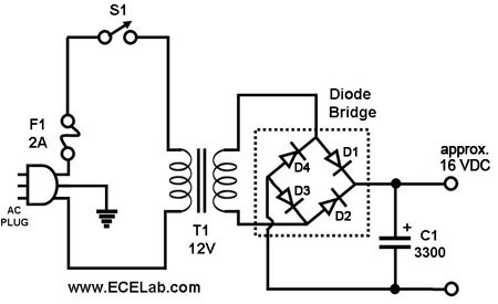

I'm sorry but you should really read some basics about electronics before venturing into trying to build a power supply from scratch. It will serve you well in the future as you will know why some things works, and others don't. I apologize if this comes across as blunt but at the end of the day there is no getting around learning it the hard way (by reading books).
Disabled Account
Joined 2002
You have to take into account that the 22 V AC will be approx. 1.4 x a DC voltage after rectifying and buffering. So lets say more than 30 V DC unregulated. The chip will fry.
For 22 V DC a 15 V 3 A (or more) "real" transformer (so copper wires around a iron/ferrite core) will work with a rectifier and large buffer cap. I would use 10.000 or 22.000 µF rated for 35 V or higher. You won't be able to adjust voltage and it will be unregulated voltage unlike switched PSU's. The chip won't fry but any experiments like running it at exactly 20.5 V won't be possible. Can't be beat for simplicity and reliability though. With switchers you have one certainty: they will fail, you only don't know when.
I am exaggerating of course but old fashioned transformers are reliable.
See this very simple schematic and use a 15 V transformer with primaries that are suitable for your local mains voltage and the 10.000 µF or 22.000 µF 35 V for C1. Use a diode bridge that can handle the inrush current. An 100 V 8 A rated bridge will certainly suffice. The ones with Faston connectors are easy to work with and most are rated way more than 8 A. The link matthtvr gave is a good one but for TPA3116 you don't need symmetrical supplies ( so +, 0, -), you only need + 20 V and GND. If all this is too much then don't bother and use a laptop adapter.
