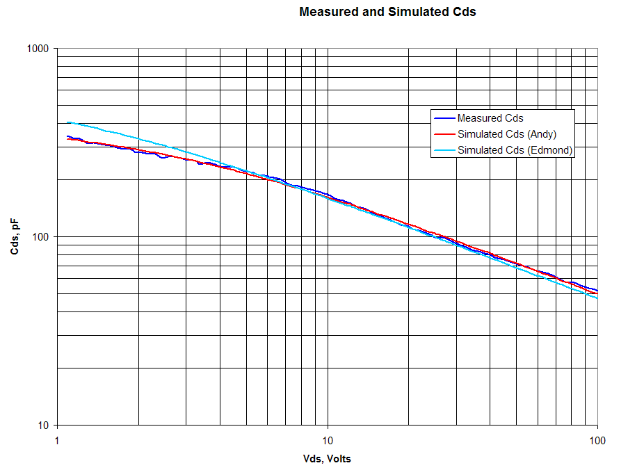

Here is the LTSpice subcircuit model for the 2SK1530. I've attached two LTSpice test circuits, one for the DC parameters and another for the capacitances. The spreadsheet used for all parameter fitting is also attached. The spreadsheet has more worksheet tabs than it looks like at first, so use the tab scroll controls at the lower left of the Excel window to navigate them.
In the spreadsheet, you'll see graphs of measured and simulated Id vs. Vgs, Cds vs. Vds, body diode Id vs. Vd, Cgd vs. Vgs and some other data. To get the spreadsheet to run, you'll need to go to Tools, Macro, security and set the security to "medium". This will allow you to accept or reject macro usage on a per-file basis. The EKV function is included - just press Alt-F11 to see the VBA code. One VBA module (Module1) has the EKV function. The second module requires a bit of explanation.
When fitting the body diode capacitance, the measured Cds value is needed, which means subtracting Crss from Coss. But when the Engauge Digitizer software is used to capture the Coss and Crss curves, the x values captured (Vds) are in general different for the two curves. So I wrote a simple linear search function with linear interpolation that calculates a new Crss vs Vds curve, with the Vds values from the Coss vs. Vds curve. Then the curves can be subtracted. This is done with the interp_lookup() function in Module2.
There is no body diode DC data on the 2SK1530 datasheet, so I captured the data from the IRFP240 and used that. I don't think this is too important, as this diode is, of course, normally off. You can see in the Excel graphs that the simulated body diode capacitance matches the datasheet Cds very closely.
In the subcircuit text file, you can see the usage of the "if" statement with a charge function to specify the nonlinear Cgd. The variable "x" in that expression is an LTSpice-specific variable meaning "the voltage across the capacitor" (pin 1 minus pin 2). So "x" corresponds to Vgd. I also added a 0.383 Ohm drain resistor to better fit the datasheet data in the triode region. It's easier to include it and set it to a near-zero value if one decides it's not appropriate than to add it later if it's decided that it's necessary.
Now that I've got the techniques down, along with a working spreadsheet, it should be much easier and quicker to do parameter extraction for other devices. Next will be the 2SJ201, then the IRFP240 and FQA12P20 (IRFP9240 substitute).

Also, I noticed you are using different body diode capacitance parameters than what I got from a best fit using the solver. I like the idea of modeling breakdown using the BV of the diode as you have done. How did you get TT though? I've attached a plot showing the measured Cds (= Coss - Crss) and the simulated Cds using the parameters I extracted and your parameters. Both are close.
Hi Andy,
You're quite right regarding CGD. ii's C*tanh. Apperently. I got trapped in one of your previous equations, where it says: A*tanh.
Regarding the diode, again you're right. I just forgot to replace my old model by yours, which indeed is better. Thanks for the plot.
I don't know exactly, it is five years ago I made this model. Probably, I just copied the diode from model of a comparable MOSFET from NEC.

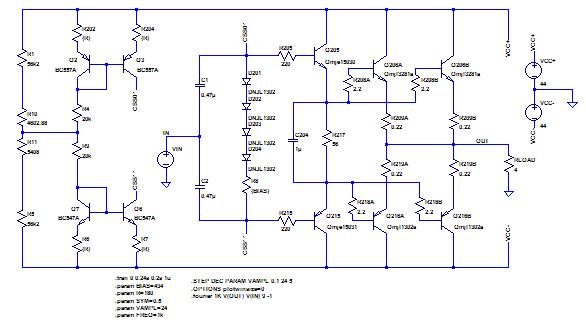

teodorom said:
I compared the results I can get, using the same models, with two different packages: PSPICE and LTSpice.
Even if I get absolutely the same results about idle currents, bias voltages, amplitudes, ..., I get very different results when I analyze the distortion on the output (by the Fourier analysis).
Not sure about PSPICE, but LTSpice requires some manual tweaking to get good distortion results. You'll need to use a SPICE directive ".OPTIONS plotwinsize=0" to disable waveform compression. The LTSpice default of doing an FFT of the entire waveform is not appropriate for distortion analysis. Try simulating, say, 10-16 cycles of the waveform, doing an FFT on the last 4-6 cycles. This allows the transient at the beginning to settle out. Take the time span of the FFT and divide it by the (number of FFT points - 1) and specify this as the maximum time step in transient.
Also, using the ".FOUR" directive in LTSpice is convenient. It automatically takes the FFT of the last cycle. In this case, use as a time step the time for one cycle divided by (FFT_point_count - 1). To see the results of the .FOUR analysis, do a "View, SPICE error log".
Finally, there is a sticky thread for SPICE simulation issues. Feel free to ask SPICE questions there also. There is currently some specialized model development discussion going on in that thread, but it's meant for all SPICE discussion. I don't want to be seen as "hogging" that thread :).

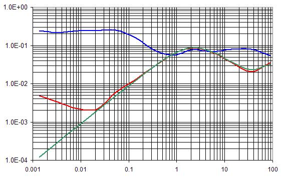

I had already made a simulation of the circuit
I had first used (in LTSpice) the directive
.tran 0 0.24s 0.2s 1u
You can see that I had already disgregarded the first milliseconds that the circuit takes to settle down.
I "measured" the distortion of bot input and output:
.fourier 1K V(OUT) V(IN) 9 -1
and I realized that even the distortion of the input was unacceptable. So I repeteated the simutation with 0.01us timestep. It took a whole night. The result, taken from the log file, is
In green there is the 0.01us results, in red the 1us results.
Now, with the ".OPTIONS plotwinsize=0", even with a timestep of 1us I get exactly the same results in a very short time.
In blue there are the PSPICE results. 1us timestep, one night of simulations and the result is very different.
The NJL models are the ones you proposed.
I don't contribute to the other SPICE forum because I'm interested in mathematics and physics, not in religion.
Thanks again.
