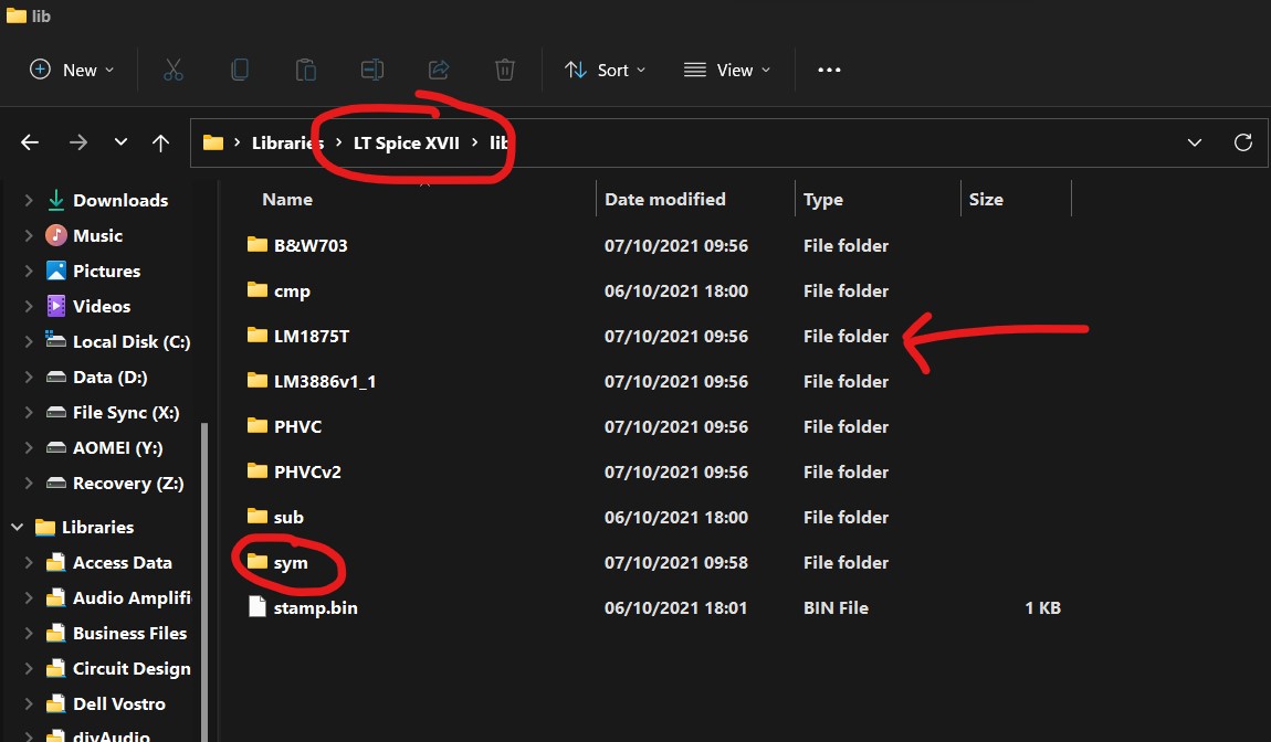

Good question. I haven't got that model on my current installation but I do have an LM1875T which is similar if you just want a play which is attached here :)
It would only take a little while to recreate the TDA2050 if you want a go:
Post #2272
Installing and using LTspice IV (now including LTXVII). From beginner to advanced.

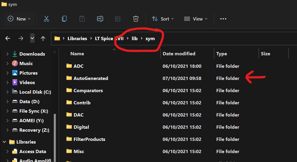

1/ Extract the files in the zipped Models folder.
2/ Copy and paste the LM1875T folder into the 'Lib' folder that will be under LTSpice in your Documents folder.
3/ Create a folder called 'AutoGenerated' (no space between words) into the 'sym' folder which is in the same Lib folder above.
4/ Copy and paste the symbol into the AutoGenerated folder.
You should now be able to call that model up from the AutoGenerated folder which will appear in the component selector.
