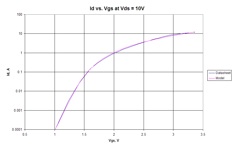

Also, I've used the Engauge digitizer to grab the output curves and the Id vs Vgs curve from the 2SK1530 datasheet. There are almost 400 data points from this!
I am trying to figure out how to combine the subthreshold data you measured with the datasheet data. They don't match up in the region where the Vgs values are nearly equal. One thought I had was to just multiply your measured data by a constant. This would preserve the log slope. Another possibility would be to scale the other 400 points somehow, but I'm not sure I want to do that :).
Edmond Stuart said:
Hi Andy,
What about adjusting VTH0?
Hi Edmond,
Well, I'm free to adjust whatever model parameters I need to, in order to match the data. The question is, "which data?". My concern is not regarding model parameters, but rather conflicting data due to measurements being taken on two different devices.

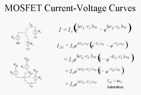

I've attached the equations for the subthreshold region (from the Ga. Tech course here below.
If it could be shown that one or the other of I0 or K is fairly constant from device to device, then I'd be comfortable scaling the other parameter so that your subthreshold data and the datasheet data join together smoothly.
Here's another thought. I took the Id vs. Vgs data captured from the datasheets and modified the plot so I was looking at sqrt(Id) vs. Vgs. From the latter plot, it looks like the threshold voltage of the datasheet device is maybe 1.35V. But looking at your data, the smallest Vgs for the N-channel device is 1.36V, where the current is 10 uA. So I guess the threshold voltage is larger for the device you measured than the one in the datasheet.
Okay, so I just went through the math, and if you assume that K (Kappa) is the same for both devices, and I0 is different, the solution would be to subtract VT/K * ln(I01/I02) from the Vgs values of the measured subthreshold data to get them to match the datasheet (where VT=kT/q). Also "big K" is Kappa from the MOSFET equations and little k is Boltzmann's constant.
I tried shifting the Vgs values in the subthreshold data measured by Edmond, to get the data to line up with the datasheet curves for higher currents. The datasheet device appears to have a threshold voltage a fet tenths of a Volt lower than the device Edmond measured. In plotting Id vs. Vgs, I ended up with a nice smooth plot. So I thought I'd try using the Excel solver with the EKV function to fit the EKV parameters. I've attached a plot of the results below. Looks like it can be made to fit the data quite well over a 5-decade range of current :).

andy_c said:
Hi Edmond,
Hi Andy,
According to the data-sheet, VTHO shows a large variability from device to device. For the 2SK1530-O from 0.8 to 1.6V and for the 2SK1530-Y from 1.4 to 2.8V (that is, @Ids=0.1A)
My data is based on a sample from the latter group and measures VTHO=2.06V, while the curve in the data-sheet is apparently based on an avarage value, being 1.6V. No wonder that my data don't fit the curve in the data sheet.
So, to answer your question: which parameter to adjust, I would say Vgs, as this one looks like the most obvious candidate.
According to your latest results, you have done just that and it really looks nice. You did an excellent job, Andy!
Cheers, Edmond.
Hi Edmond,
Yes, it took me a while to realize that simply shifting Vgs would keep the log slope of Id vs. Vgs unchanged in subthreshold. Duh!
Another funny thing that happened was when I originally tried fitting the data, I included the output curves in the big data set. I ended up getting nonsense results. Then after I looked at the data, I realized that the output curves were measured with a different device than the Id vs. Vgs curves :). So I ended up adjusting the Vgs values for the output curves as well. I'm getting simulated output curves that are not as flat as the measured data, so I have to figure out how to fix that.
