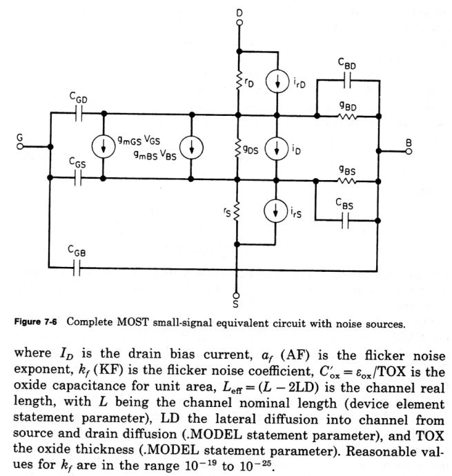

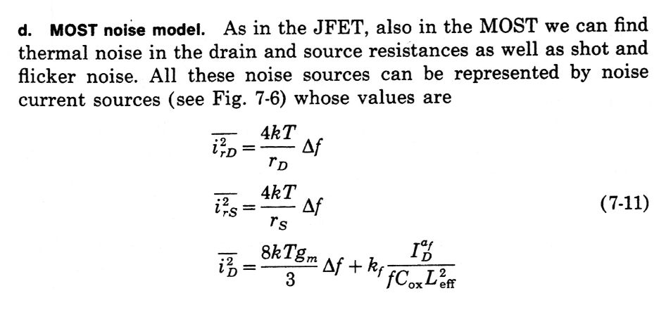

MOSFET Noise models
Do any of you guys have an opinion on the accuracy of the noise behavior for the MOSFET SPICE models in LTSPICE?
BTW, I've always been under the impression that MOSFETs are a lot noisier than JFETs in general, but I've never really looked at the noise characteristics of MOSFETs. Any thoughts?
Thanks,
Bob
Hi Bob,
This is the only information I have on the MOSFET noise model. Page 1 of 2 is below.
