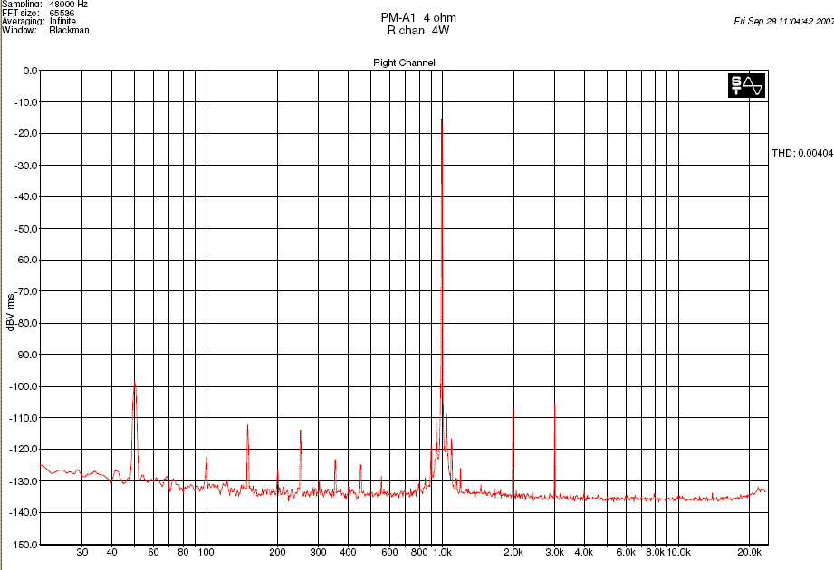

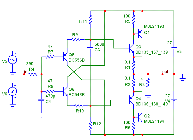

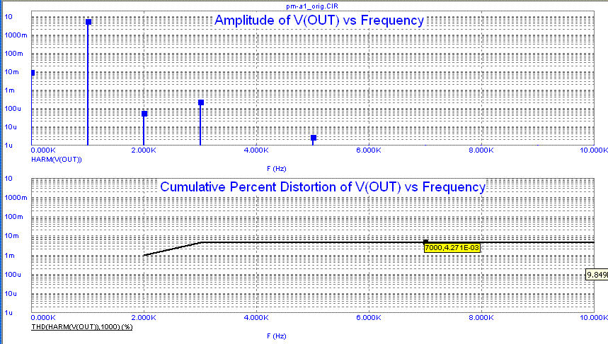

Distortion measurement and SPICE
I compared the results I can get, using the same models, with two different packages: PSPICE and LTSpice.
Even if I get absolutely the same results about idle currents, bias voltages, amplitudes, ..., I get very different results when I analyze the distortion on the output (by the Fourier analysis).
So ... who is telling (the better approximation of) the truth ?
Anybody, that compared simulation with measurement, can advice me about the "better" simulation package ?
My results for PM-A1 amplifier, 4W/4ohm. Measurement:
