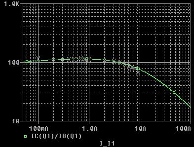

I'm working to make the approach of andy_c more usable.
However I'm encountering some problems ...
The main problem is that the function to be minimized has so many fake minima that it's realy hard, once reached a solution, to say that is the best solution or, at least, a good solution.
The methodology I have depicted seems to give some good and stable solution. By "good" I mean a solution that fits well the specifications sheet data, by "stable" I mean a solution that stays the same even if the initial, guess, parameters are slightly changed.
Unfortunately, for the MJE1302 I get (for the static parameters) values
+IS=2.683E-9
+BF=286.774
+NF=1.323
+VAF=119.762
+IKF=10.525
+ISE=9.803E-11
+NE=1.475
+BR=0.5
+NR=1.09511
+VAR=58.672
+IKR=0.3
+ISC=1E-13
+RB=2.237
different from the ones proposed by andy_c.

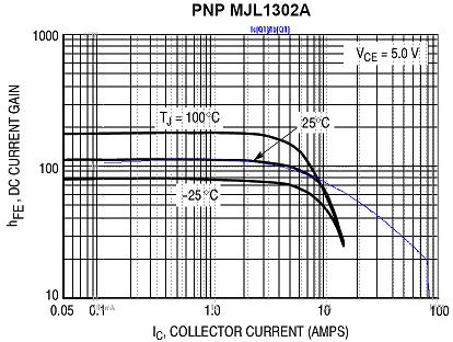

In LTSpice I see some sort of discontinuity at 80A, even if if this discontinuity is not there in PSPICE:
So, my question is: at what condition a solution is a good solution ? is there any "sanity check" to apply ?

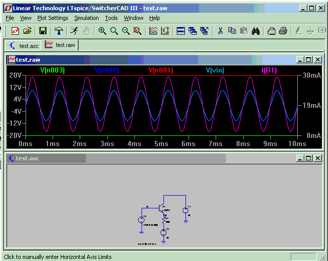

LTspice for dummies
I have finally decided to give up on Multisim and have installed LTspice. I’ve got the schematic entry, waveform viewer sussed and have worked out how to add components into the model list.
I have started with a simple emitter follower using Andy’s RET model.
Now that’s all fine and dandy, but how the hell do I analyse THD then? I can’t find no pretty THD box like in Multisim. The help files that come with LTspice are pretty hopeless here.
Glen
Re: LTspice for dummies
Glen
Does this help: http://www.diyaudio.com/forums/showthread.php?postid=1309200#post1309200
Or: http://www.diyaudio.com/forums/showthread.php?postid=1288439#post1288439

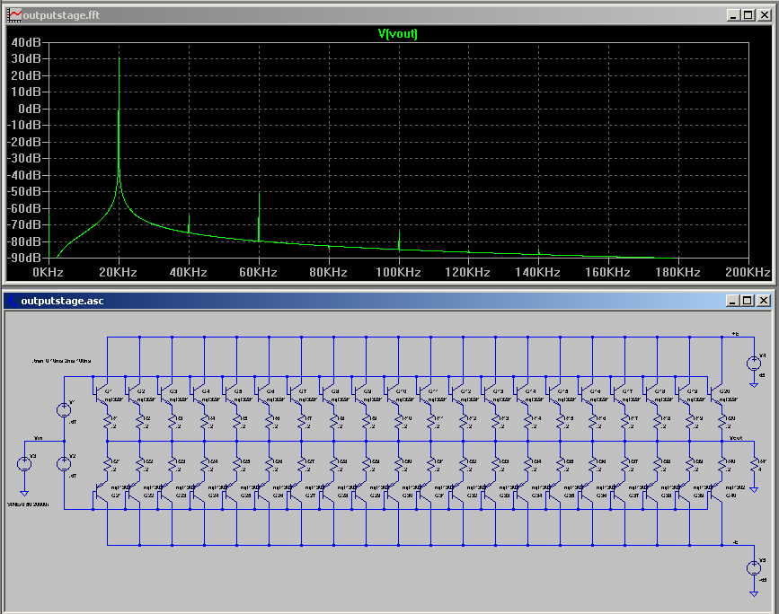

More LTspice for dummies
Okayyyyy............ I've got the FFT working on a little class A output stage.
So how do I make the program give me a numerical readout of the THD then?
Glen
