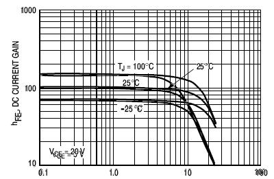

I'm trying to understand the limitations (if any) of the Gummel-Poon model. I'm looking to what happen with different values of VCE. The effect seems quite dramatical:
The gain is sightly modified, but the beta droop is highly enhanced. I see that in every case the two diagrams are provided.
However, even using the (widely accepted parameters proposed by andy_c) parameters the effect is much milder.
Is there any explanation ?

I imported the LTspice BJT library into a spread sheet that makes it a bit easier to look up and compare various model values.
I have about 10 of the older common small signal transistors, 2N2222, 2N2907, 2N5401, 2N5550, 2N4401, 2N4403 etc. mixed from Fairchild and Phillips and they all have Rb = 10 ohms. 2N3906/04 have Rb = 20 ohms.
The Onsemi models seem to have Rb ranging from below 1 ohm to several hundreds of ohms - probably the result of a poor curve fit and blindly trusting the results. I'd rather have a reasonable default value than an erroneous value resulting in a worthless model.
Nearly all of the models either do not spec Re, it defaults to zero as I recall, and those that do seem to have values below .1, even .01 ohms.
Rc seems to range from .01 ohm or less to 2 or 3 ohms max for the small sample that I'm looking at.
Seems Vce sat provides at least a sanity check for Re and Rc. It is less than .2 V @ 100 mA for the 2SC3601. Re is 5.63, Rc = 2.25 for the model provided on the forum here for that transistor. At 100 mA we have: .1 * (5.63+2.25) = .79 V which indicates that they're far too high. Rc alone is too high.
I too am trying to find a way to do a sanity check and determine a good enough fix for many of these models.
I started looking at Rb when I noticed that some med power transistors used as drivers tended to oscillate without base stoppers. Then checked the model to see that they often had less than 1 ohm Rb, those that were more stable had a value of 2 ohms or more and I think were all around better models which probably also contributed to better stability.
Would be nice if a semiconductor design specialist would comment on the Rb issue.

Bob,
I have just developed (with Mathematica) a procedure able to extract (without any explicit, manual, recursion) those static, forward, parameters. For the others I assume the "typical" value.
The great uncertainty is the value of VAF: many times there is no way to get it.
I've got reasonable results for MJL1302A, MJL3281A, MJL4302A, MJL4281A. With the MJE15030 I had some problems (BF too high, when compared to hFE, convergence problems).
More over I have problems with the displacement of the "beta droop" when varying VCE (I guess it is a problem of the SGP model).
