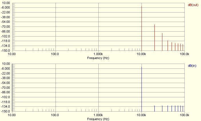

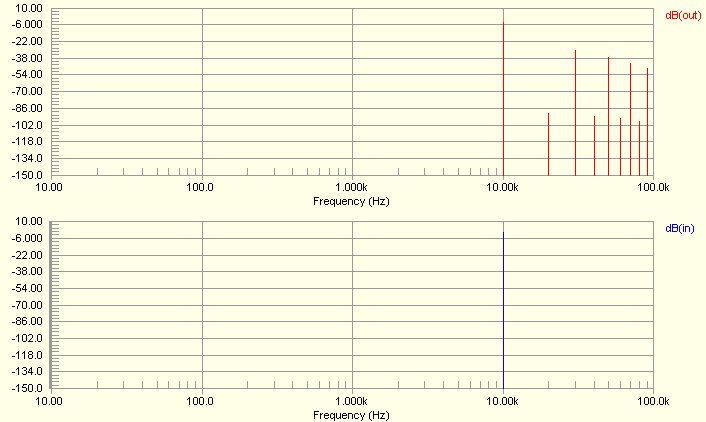

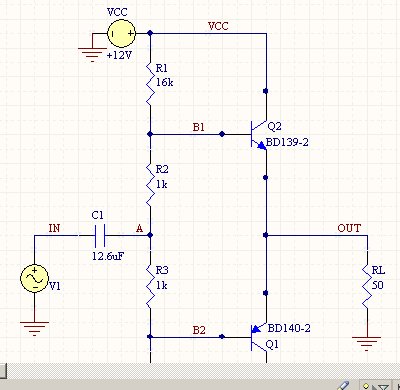

Hi, Everybody,
I'm learning simulation. I try to simulate this simple pushpull cct. The signal generator is 10khz, 1V. The FFT is with 10khz fundamental frequency.
I got very different FFT result with BD139-BFD140 model from 2 manufacturers (with exactly the same CCT). Which is the right one?
This is the CCT being simmed.
the predictions are only as good as the models (data) input into the equations.
Different models will give different results.
Wrong models will give useless results.
Trying to get distortion results from these simulators is stretching the manufacturers' standard models to or beyond their limits.
That's why the experienced among us say design, build, test.
Disabled Account
Joined 2007
Not really true. Some models have problems, but you don't end up with useless results. There have been many warnings about the ONsemi models (BD139/140 among them).
Simulation gives distortion figures that are very close to the real thing. In fact, I find the simulation errs on the side of caution, and the real circuit may well have lower distortion than predicted.
For example: my predicted distortion for this amp (Andrew, you were involved) was <.010%. The results were better than that.
Nice to design on paper, but using a simulation would be the next logical step, certainly before building it.
