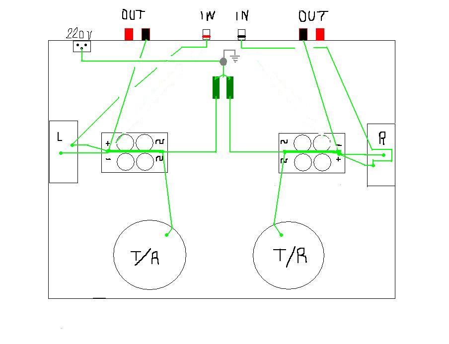

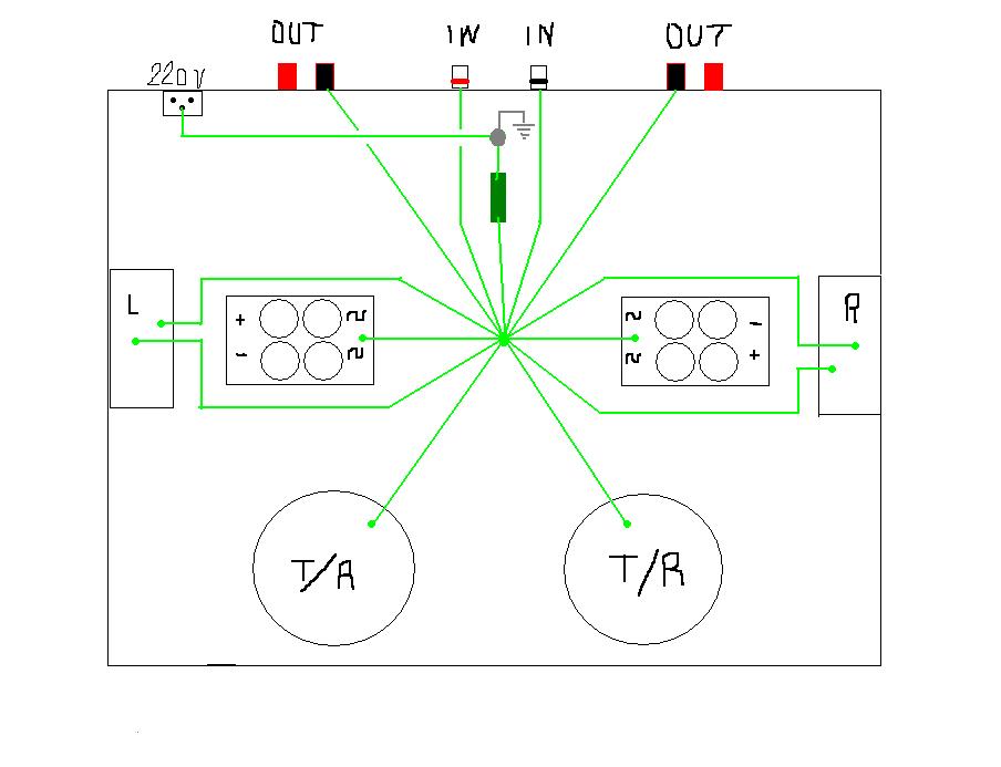

Need a little help with grounding
I've finally finished the construction of my GB150D, everything seems to be great except a noise that comes from both channels when there is no signal. I'll try to describe it to you; It's loud, I'm able to hear it even from 3 meters away. It sounds like a buzz or more like the sound of boiling water but thinner. I think it's a grounding problem and I'm going to apply a new grounding schema. Please look carefully to the attachment files and tell me which is correct/best. The Light green lines are the earth,
grey is the ground to chassis and dark green is the chassis ground circuit. If you have another suggestion to make, please do. The mains power voltage in Greece is 220V/50HZ. I use two trafos of 33-0-33 at 200VA and two psus of 40.000ìF, one for each channel.
Thanasis.
Thanasis.

I would do neither.
You have kept the mains safety earth separate - very good.
Keep the power ground separate. Connect all the big power returns to this ground. Include the speaker returns, Zobel ground, decoupling ground.
Keep the transformer centre tap away from the power ground, take it straight to the PSU common by the shortest, straightest route - even move some components to achieve this.
Then connect the centre tap to power ground.
Make a signal ground for each amplifier, connect the RCA ground wire, PCB input ground and PCB feedback to each of these. No decoupling connected here. Check all four grounds are insulated from each other. They could for convenience be very close or widely separated if that suits your layout better.
Now the options.
You have three types of grounds;- Mains, power , signal,
Mains and power direct together with a link wire and resistor to signal ground.
or power and signal direct together with a link wire and mains via a resistor (10r) as your diagram.
or all three direct together.
or an option I have not tried, resistor connections between all three grounds.
Experiment with where you put that resistor. By keeping all three ground separate you can experiment with very few changes.

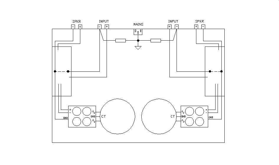

I have only two comments on the latest schematic/layout.
The star ground on board the PCB relies on the amp designer getting it right.
Maybe connect the mains earth via a resistor to Star ground in lieu of the twin resistors to input RCA grounds.
All else looks workable.
Terry, this grounding is wrong : you must not lead input ground by common wire with output ground into PS, but by two separated wires. You must imagine, that output ground have not " zero " resistance and by continuous current from load is " modulated " input ground = positive feedback = instability.

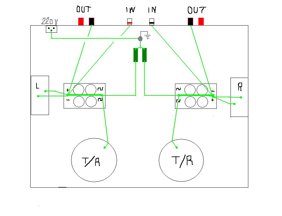

Thank you both for your suggestions...
Andrew, can you please make a drawing with your suggestion because my English is too poor to figure out what you suggest?
Terry, have you also constructed the GB150? If so, did you apply this grounding schema that you suggest? You have connected the input jacks earths to the chassis ground. What circuit did you put between them? Is it the same that Greg suggests (1 resistor 2,7 ohm and two anti-parallel diodes) or just a resistor?
I've tried both of my drawings but none had solved the problem. I even tried a third one that appears to make some improvement. The noise is reduced but not enough. When I disconnect the mains power ground from the chassis and connect only the star's earth to the chassis, then the noise disappears completely. When I only disconnect the star's earth from the chassis, then the noise is reduced so much that I have to get my ear close to the speaker to hear it.
Can you figure out what is happening here? What is producing the noise?
Thanasis.
Thanasis.
