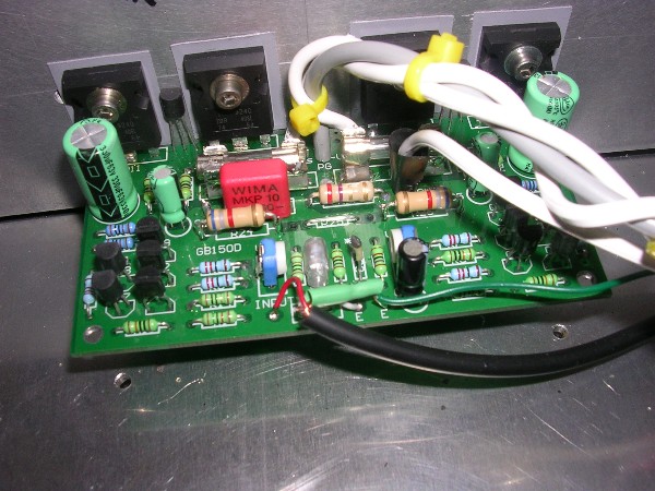

Macka,
Great idea! As I build I will also try and post some key step pics. Looks like the detail in this constructors section is from a different amp - the input wires look like different colours. I was wondering what the green sleeve-like component was at the input? I'm starting to do some comparisons between the other pics you've posted (http://www.diyaudio.com/forums/showthread.php?s=&threadid=72172&perpage=10&pagenumber=9) with the ones here and also at http://www.diyaudio.com/forums/showthread.php?s=&threadid=72172&perpage=10&pagenumber=23 and trying to relate these to the instructions Greg sent. I guess the only items that remain obscure is to see the photo's of point to point wiring between transformer, PS, amplifier boards and the RCA inputs and binding post outputs. I realize this is pretty general at this point but when the kit gets here I should have more specific questions - so far as I do the thought experriments things seem to be falling into place.

ShinOBIWAN said:I've got a good one here:
Hi Macka
How did you screw in the last fet's on heatsink. I've got the green caps block the hole. Could desolder but then I've got to mess around dismantling the case so as to be able to get back at the rear of the PCB.

Greg has suggested:
If you tilt the C's to L or R while heating the connections they will tilt and raise a little from the PCB maybe 1 mm. Enough to clear the screws/driver.
I have thought about it and as I recall Greg suggested using clips to provide pressure on the power Fets.
Another alternative is to mount the Fets on the heatsink and install green capacitors last.
