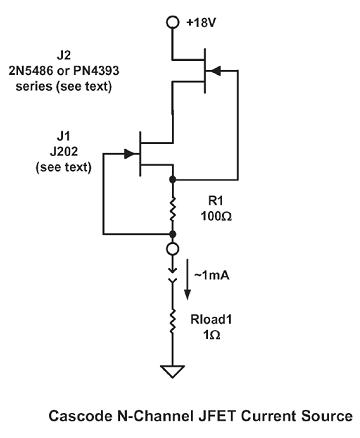

On another mod altogether - I'm looking to make my SKA GB150 capable of accepting balanced inputs as I have a DIY preamp which outputs true balanced signals.
According to Greg, it's a simple mod to the front which I can probably make as an switchable option (perhaps?).
My thoughts about this made me wonder if the CCS tweak would still be effective or how would I find the new values for the synergy of this mod to be effective. One way is to run a simulation but I need to download simulation s/w, learn how to use it & possibly not trust it being a first time user.
So I got to thinking about doing the CCS off-board and playing with different CCS circuits/ running off batteries, etc. I seem to remember a SKA owner using his own CCS but can't find the post. Anybody here have more info?
