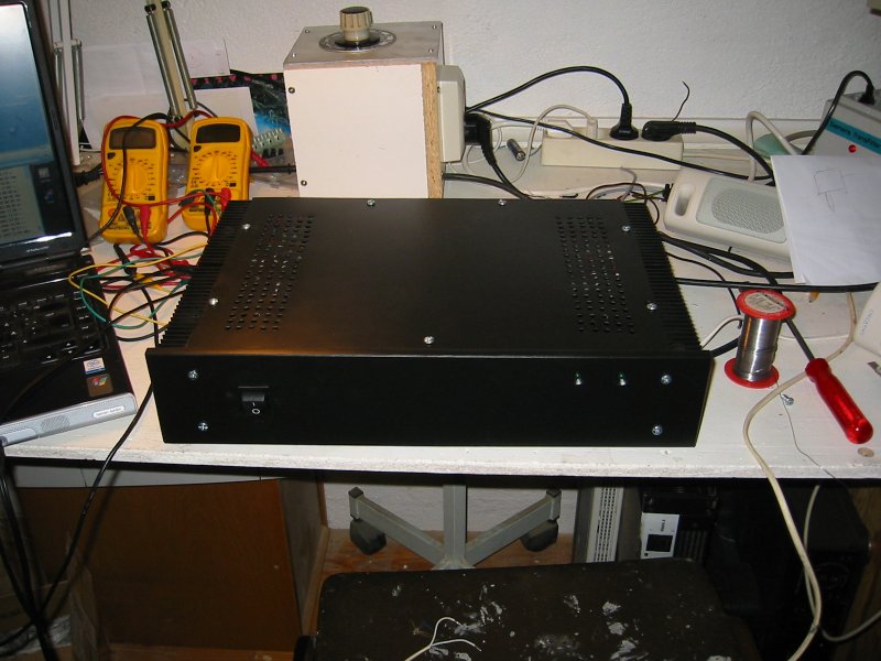

I thought about swapping the heatsinks around and putting the modules on the other side. This puts the heatsink under the ventilation slots and puts a nice chunk of metal inbetween the toroids/psu and amps and more space between them, and keeps the signal and power wires further apart as well.
Requires more ventilation holes cut like this perhaps:
Richard is this what you meant by the idea in your email:?
It's a tight fit, but the heatsinks in this pic do have a larger footprint. I think this is what Jacco was referring to as well and the idea is growing on me. I'd get some new heatsinks with the same foorprint as the long ones in the pics above, but 100mm high for better chimney effect and black anodised which should all help I think.
Always looking forward to your suggestions...
Vikash said:referring to as well
Added bonus if you can size the heatsinks exactly to the inner height of the case:
- thermally coupling the heatsinks to the bottom and top of the case for additional cooling.
- transfering weight more evenly to the corners, instead of having it in the center.
- short wiring, the SKA likes that.
- possibility to seal the case, means no dust. I loathe dust in amps, shame i never fancied GoldyMundo

Thanks Jacco, I took to the points you outlined as they are quite appealing. This is the arrangement I have (pretty much) decided on. The sinks are SK416 114mm high (coupled to bottom and top of chassis). Thermal rating is 0.6K/W each. The sinks are slighly overlapped to cover the vents evenly, but the concern is that only ~60% of the sinks are vented.
I've turned the transformers around to create more space.
I'll *try* not to deliberate on this further, but please chip in if anything else comes to mind!

Vikash, that last one is perfect but maybe you could make holes underneath bigger and completely evenly placed... it will be really effective, but ofcourse there will only come in what goes out...air, that is
Remember to have something isolating between upright trafo and chassis.... cork is nice

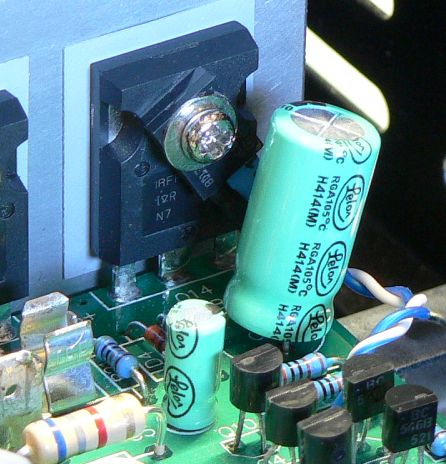

GB150 D5, D6.... TO92 be gone.
I disliked the TO92 devices for D5, D6 on the GB150, as being an old engineer, I like a good solid mechanical mounting. I asked Greg for some other alternatives in a more suitable package and he came up with the BD139 (D6), BD140 (D5) which required R10, R12 to be changed to 1K1.
The change has been done and I much happier with using the TO126 devices. The base and collector were joined at the device, heatshrink added over the legs and joins, and the wires run to the top of the PCB to the - + locations. They were mounted on top of the Mosfets (Q11, Q14) and not on the heatsink. The amp has been tested all afternoon in the workshop with an ambient temperature of 28° and the heatsink didn't get over 50°C, so an increase of only 22°C. The bias didn't drift as much as before and stayed within a range of around 0.03V after the amp stabilised.
So far it's all good and I'll see how it fares over the next couple of weeks. I've added a pic showing the TO126 device on top of the mosfet and the blue and white wires going to the PCB.

My GB150D is in transit. I'm interested in trying out your mod. Mounting the TO126 devise directly on top of the mosfet should result in better coupling and less lag. How is it performing now? Do you have the measurement before the mod is done?
rabbitz said:I disliked the TO92 devices for D5, D6 on the GB150, as being an old engineer, I like a good solid mechanical mounting. I asked Greg for some other alternatives in a more suitable package and he came up with the BD139 (D6), BD140 (D5) which required R10, R12 to be changed to 1K1.

I swapped the BD139's & BD140's into my 300D's about four days ago and am very happy with the results. I bolted them to Q16 & Q21 and moved the wire attachment point from bottom of board to top. The initial bias stabilzed much more quickly than before and, after monitoring the bias off and on for several hours under load, bias seems to stay spot on at 2.0v where before it would drift +/- .05v or more. Sorry, I've no temp. measurements but, they are certainly not running any warmer than before! HTH.
Gordy
Edit: Thank you Rabbitz and Greg for your help and input!
