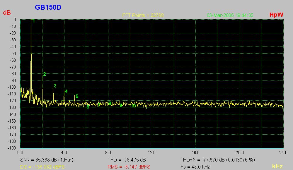

wwood said:Attached is an FFT of the GB150D. 5Watts into 8 Ohms. The signal source is an HP339a and it contributes a bit to the noise floor.
Bill
Thanks Bill,
The figures look great to me. No misbehaving in the HF, looks like the measurements match the subjective opinions already posted.
Could you post an FFT at 10Khz, 20Khz and 50hz please?
Bill
I would think that what you are seeing is the sig gen or
analyser residual distortion.
Sorry to say, but that is pretty poor performance for 5 watts /
8 ohms for a 150Watt SS design with global feedback.
Can you do a loop through test to check the equipment residual?
Terry
Hi Terry,
The data presented is accurate, and represents my unit.
1.) Both analyzer and generator have residual distortion more than 20 dB below measured distortion.
2.) The data is consistent with the designer's claims and his published data.
3.) The distortion drops smoothly with increased bias, dropping below 0.01% at about 100mA per device.
4.) Within the limits of my 150MHz scope, there is no sign oscillation.
5.) Why are you "sorry", it is what it is ?
Bill

Hi Bill,
My post has a potentially negative slant and so I wanted to make
sure the measurements were accurate.
The spectrum is very good with a steep drop into the noise
floor as the harmonics rise.. You could say this is theoretically
textbook.
But the levels are relatively high for such a low power and into
8 ohms and 1k
The SKA acheives a lot of open loop gain with simple circuit. As such
it has the potential to very low measured distortion levels.
Is there any way you can push it a bit harder into 4 ohms and
higher frequencies?
I ask this as usually these are the measurements I do when
really looking for how a power amp performs. If I am shooting
for low THD, then I will try and give the amp a real stress test.
I am thinking with my designer hat on and trying to get a real feel
for this circuits technical strengths and weaknesses as you can be
sure that I am working on something that may better it.
As an example, a while back I was testing a power amp OP stage
and didn't have a lot of voltage level to drive it. So I loaded it with
2 ohms and drove 10kHz and 10V RMS to see what would really
unsettle it.
The meaured performance was in 0.00x % range with mainly low
harmonics.
Terry
