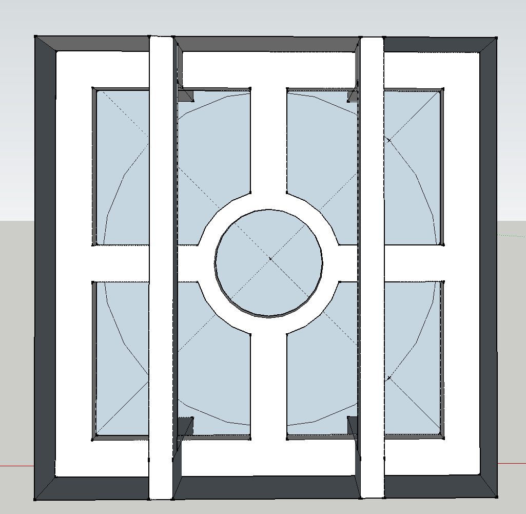

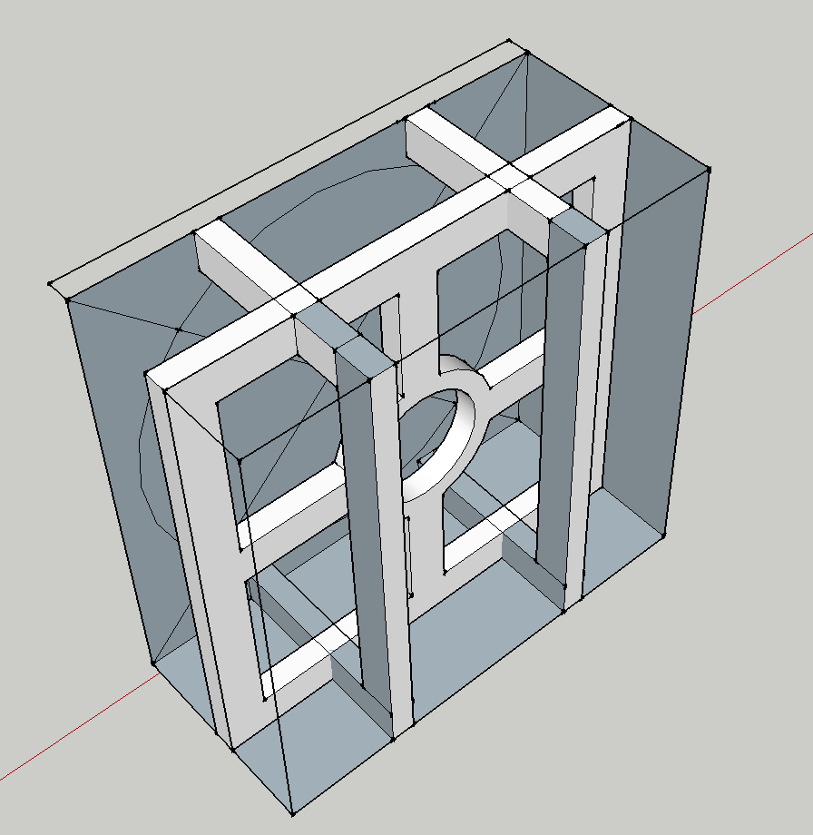

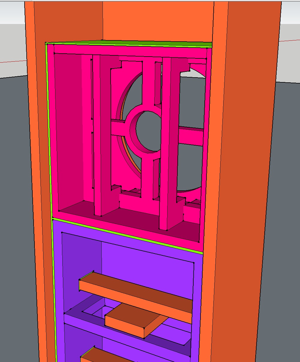

Here is a rough sketch of the box for the woofer. It will be ~18.5 liters after taking into consideration volume lost from bracing & woofer and ~20% gained from loose fiberglass fill.
.707 Q
F3 95hz
Fc 95hz
It will be a CLD box in box, and that will be in a larger cosmetic box that houses the SEOS.
Please let me know what you think. If I get the green light then it's on to the next step.

Your bracing looks nice but complicated. Perhaps try a simple cross that goes top to bottom and side to side (2 pieces with middle notch to snap together). Make the cross almost touching the magnet and use compliant rubber or EVA foam sheets to make contact to magnet with slight pressure. Offset to side enough to clear magnet vent if there is one. Cross should touch and be glued to back and side panels.

For crossover design, the closer the better. 1/4" - 1/2" visible gap on the front is adequate since there is enough wood hidden behind the driver flanges.
Also, consider bracing the front baffle to the rear panel with a cross brace stick centered right between the drivers. It makes a huge SQ difference because that is a weak location on the front baffle due to the two large driver holes in the baffle.

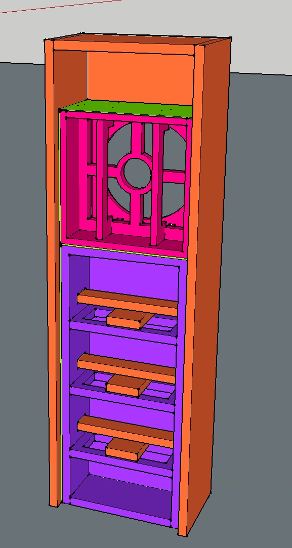

My design is almost complete. I have a question about box dimensions and nulls. My internal box dimensions are in cm.
Width 31.4
Depth 16
Height 34
My crossover is likely to be around the 1200hz. Are these internal box dimensions likely to cause any nulls? How does that work?

If you are talking about modes and resonance within the box then yes you will get them unless your internal dimensions are less than half the wavelength of the crossover frequency. But that's what absorption is for. Waste cotton / denim insulation like ultratouch works well.
Box dimensions are mostly irrelevant. Box construction matters a lot. Cross bracing, joint rigidity, panel absorption, but the actual dimension don't matter very much. No matter what the dimension are there will always be the same number of modes in a given band as long as the volume remains the same.

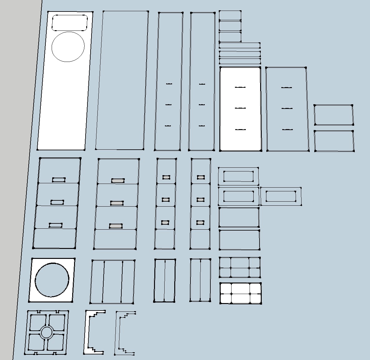

So just an update. My design is more or less done. I'm just on cnczone.com right now getting some advice and making sure what I'm doing is right. This is my first time designing anything for cnc. But the dimensions of the enclosure are pretty set. I'm just making sure my cut lines are correct. In the meantime I am organizing the file so I can post some pictures on here of the enclosures and get some feedback. I'll probably have that posted in the next few hours.

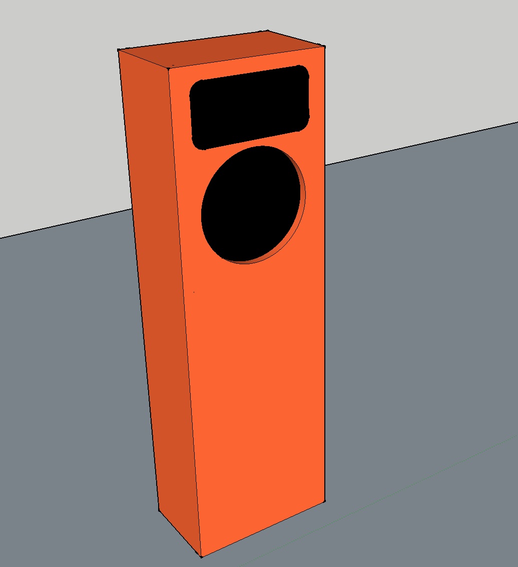

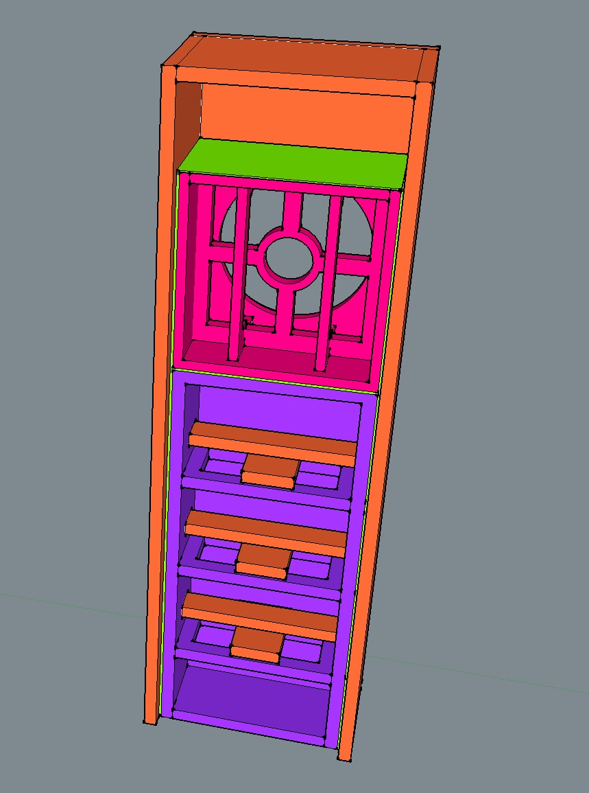

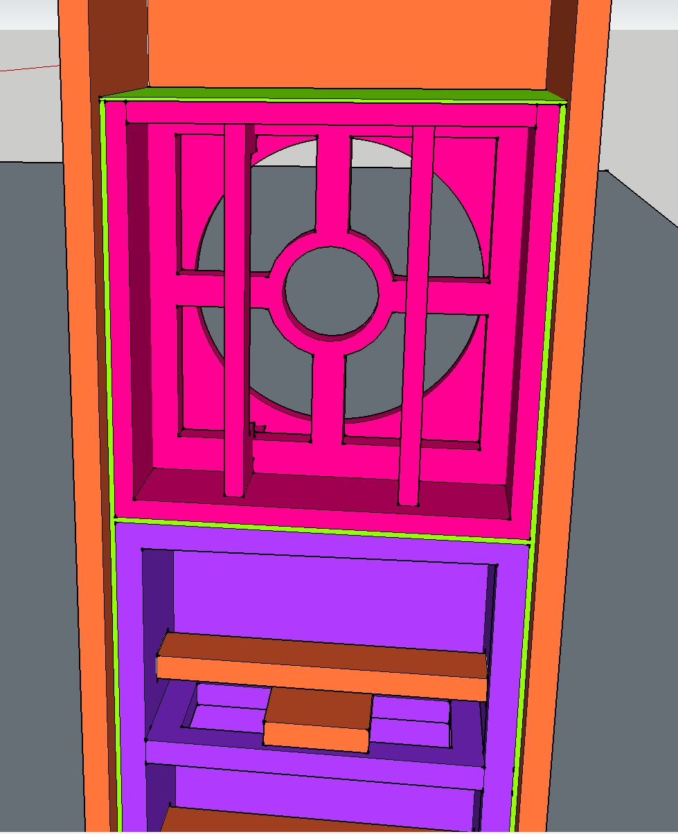

Ok, I spent the afternoon making a 3D image of the speaker, It's not totally accurate but enough to get the idea. The speaker itself is coloured so you can tell the different parts. The lime green between panels is a visco elastic layer of green glue. The box with the woofer kind of 'floats' in a layer of green glue. But it is sealed in tight on all sides. Contrary to the 3D image all the outside edges are rounded over and the joints are lap joints not butt joints.
Just wanted to get this on here today like I said I would. I'll update it more in the coming days.
Let me know what you think!
Shawn
Shawn
