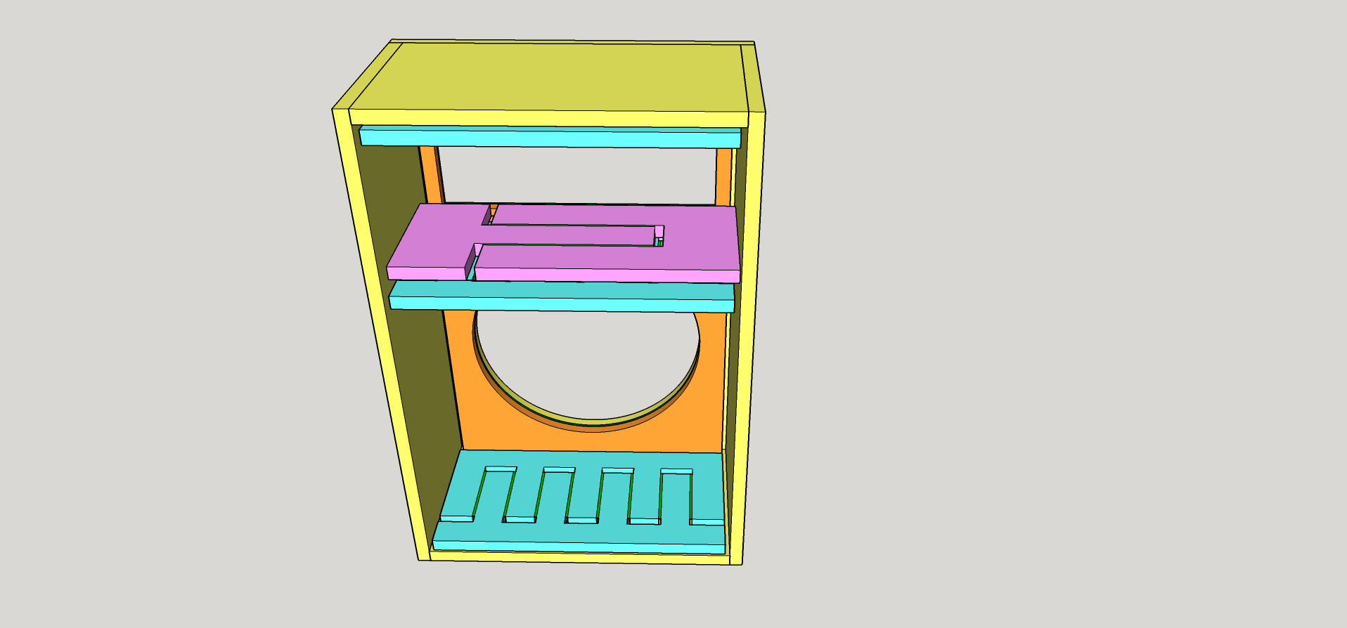

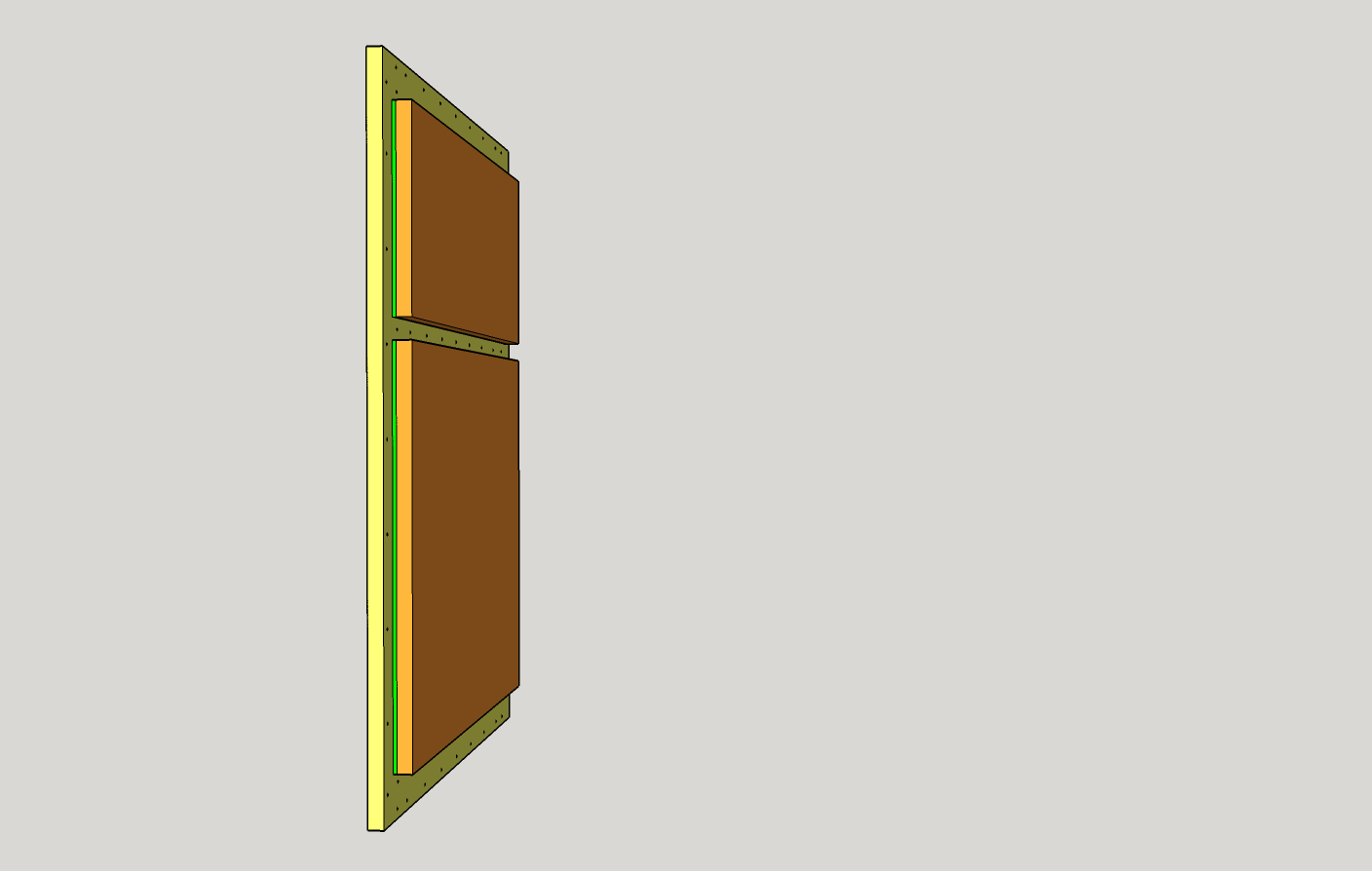

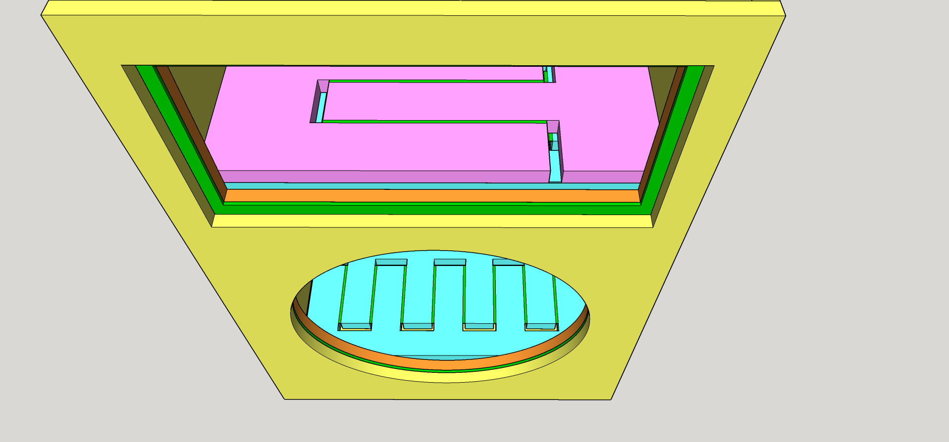

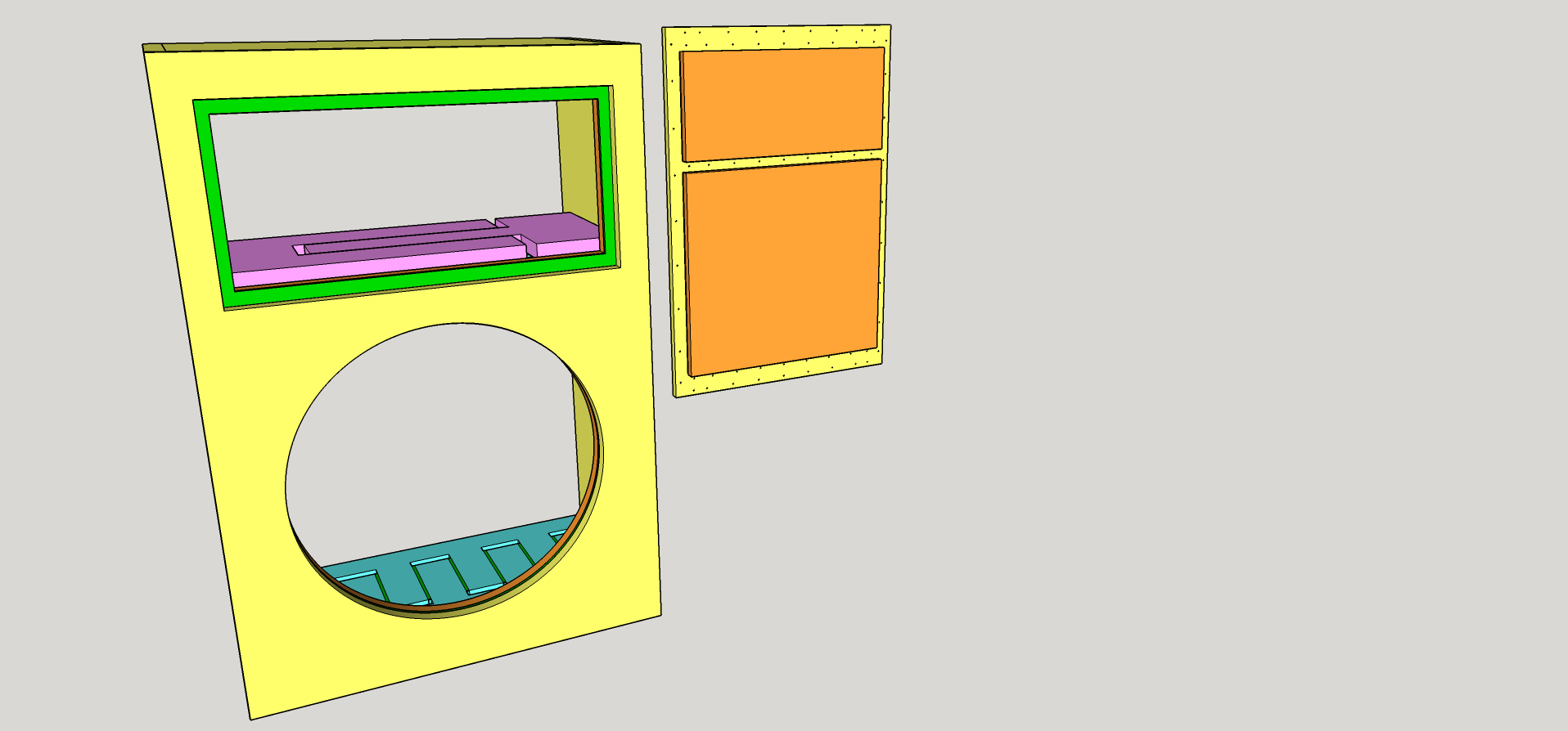

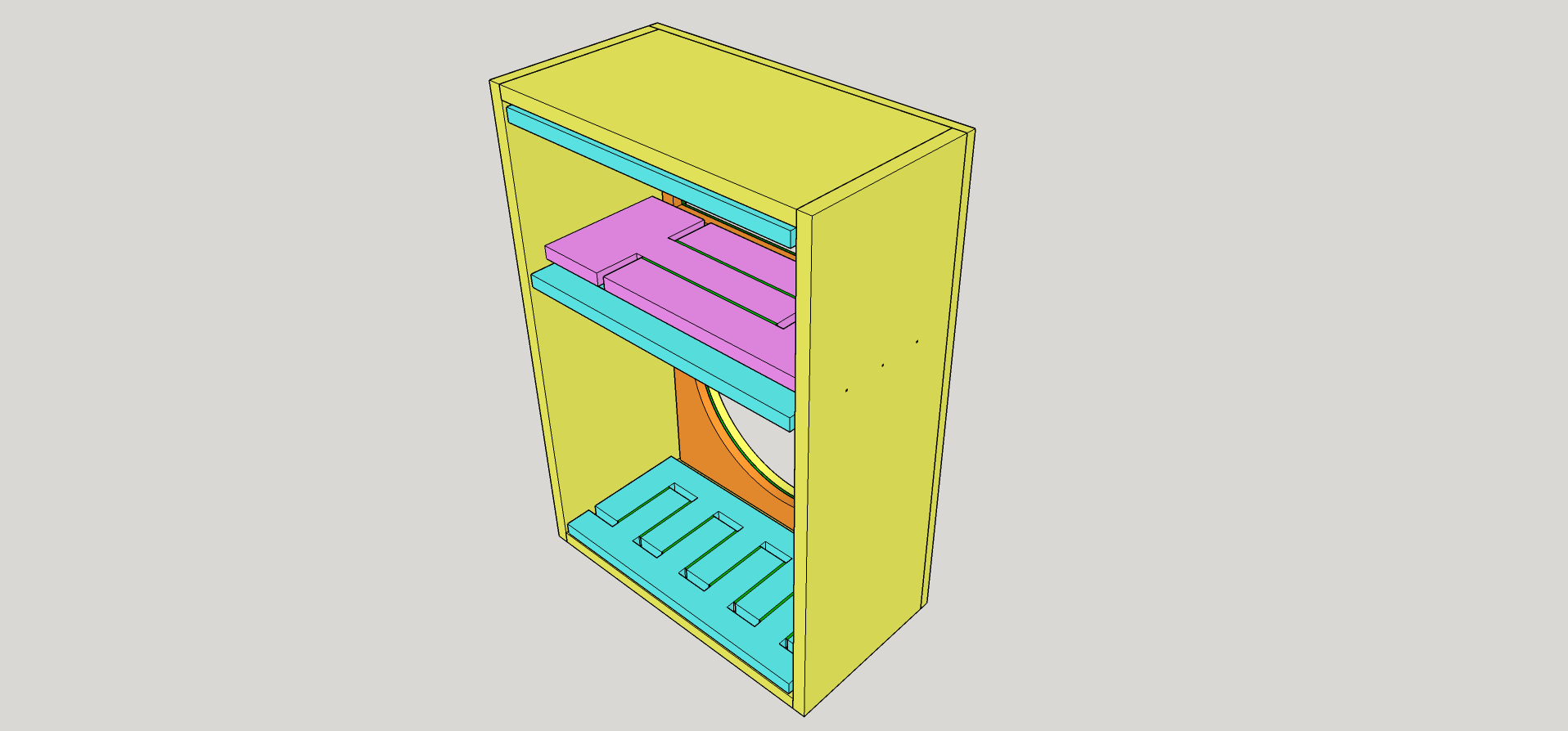

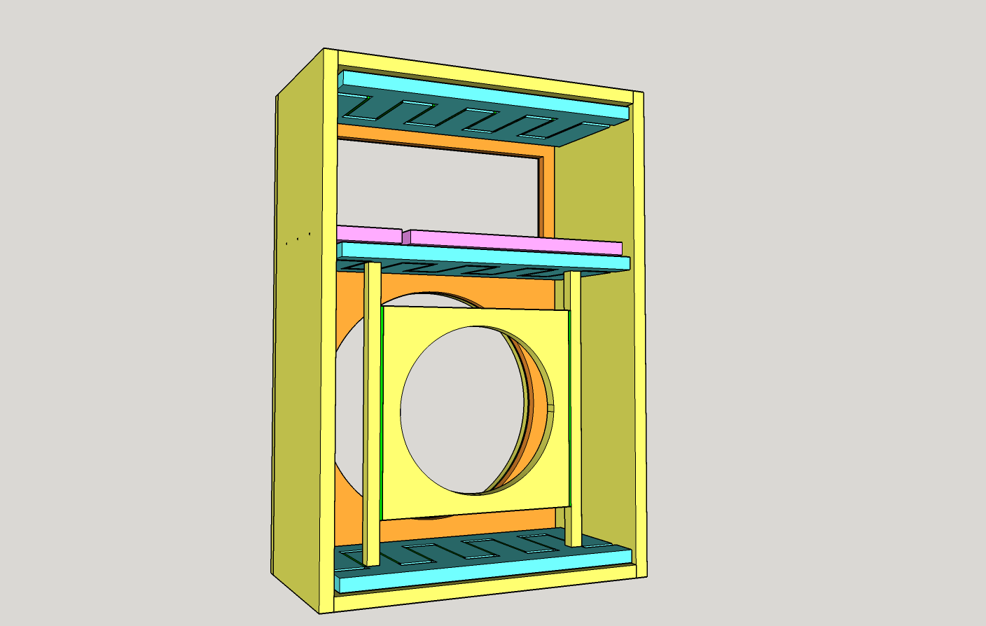

New Design
Hello,
It's been a while. I keep hoping I'll have some time to finish this, and then something else comes up. So I redesigned it to make it a easier to cut and assemble. I have a couple questions.
1. The front and rear panels are each 2 x 12mm (1/2") baltic birch ply with 3mm damping layer. Driver is rear mounted to the inside panel, little magnet brace, round-overs on outside edges, outside edge driver hole. Are these baffles stiff enough? (all other panels are 15mm, 12 ply)
If not, then instead I use 2 x 15mm (12 ply) with 3mm damping layer. The woodshop only has 1" round over bit, might be only 3/4". Between rear mount driver and round over edge on front baffle driver hole there will be hollow cylinder. Is this ok?
2. 3mm "Sikabond Construction Adhesive" mixed with 3M Microballoons. Good enough for damping layer? See attached product sheet.
Thanks,
p.s.
Round overs are not shown in images. But all outside edges will be rounded.
If the cuts look complicated, it will be CNC so not hard.
Green color is damping layer.
I can get Sikaflex 292 but it is 4x the price of Sikabond construction adhesive.
Speaker is designed to be as small as possible.
