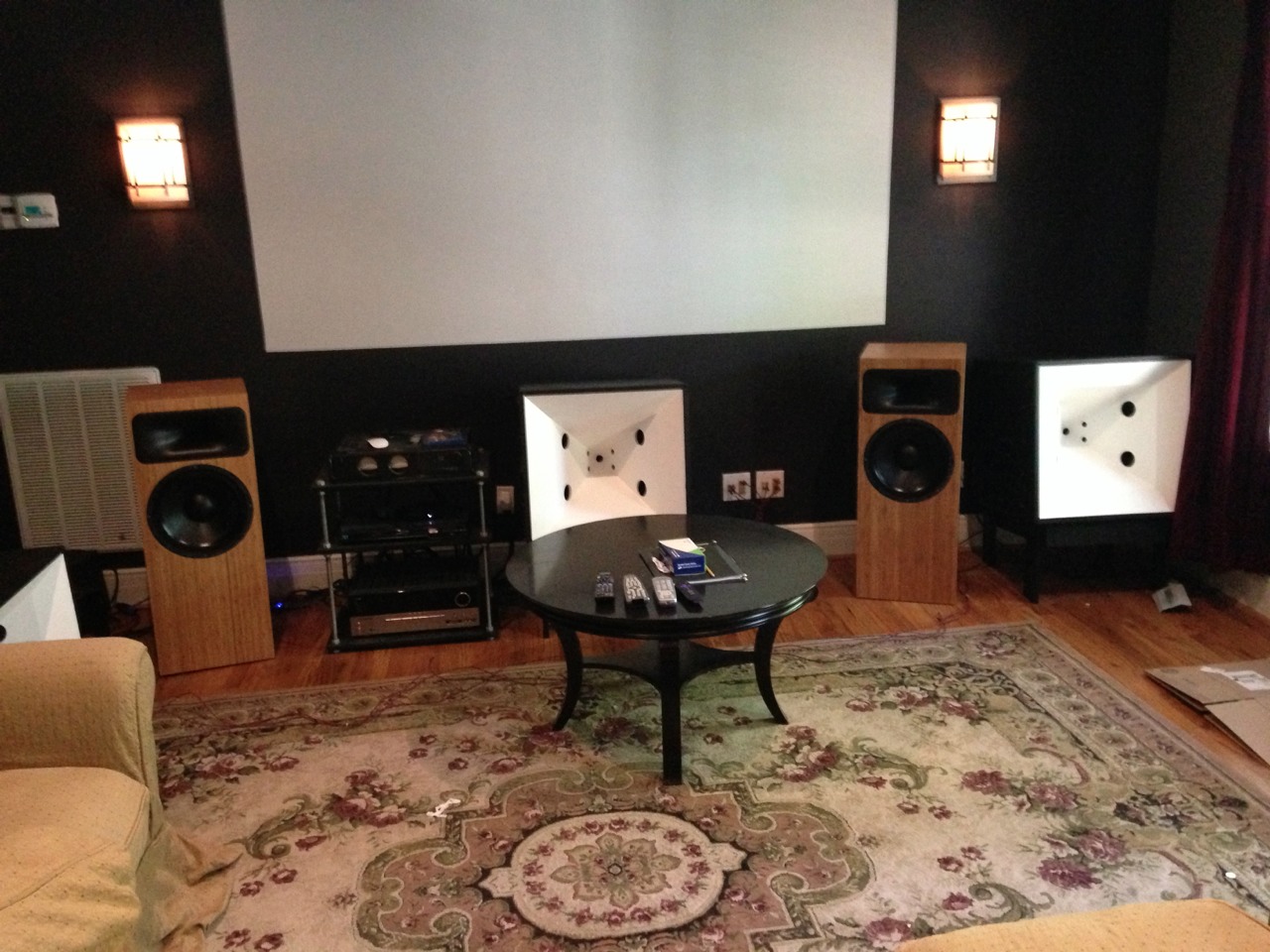

I’m nearly ready to purchase these components for another project - a large two-way, horn + woofer. I liked the idea of the Econowave but when I realized the efficiency was brought down to approximately 92db per watt I thought I’d try something else.
Dayton D250P
Dayton Audio D250P-8 1" Polyimide Compression Horn Driver
Dayton H6512
Dayton Audio H6512 6-1/2" x 12" Waveguide 1-3/8"- 18 TPI
Dayton PA310-8
Dayton Audio PA310-8 12" Pro Woofer
Eminence PXB2: 1K6 crossover
Eminence PXB2:1K6 2-Way Speaker Crossover Board 1,600 Hz
L-pad
Parts Express Speaker L-Pad Attenuator 100W Mono 3/8" Shaft 8 Ohm
I’d like help with the crossover. I wonder if I should just purchase the pre-made Eminence and tweak from there or build from scratch?
The Dayton waveguide keeps the project “all Dayton”. I’ve heard this waveguide playing in a Chinese restaurant and it sounded really great - sweet and detailed - I want it.
I’ve been enjoying an open baffle system consisting of all Eminence components based around the 12LTA on open baffle (supported by a compression tweeter and Alpha 15 for bass in an H-frame). It’s very efficient (the 12LTA is rated at 97db per watt and is clearly more efficient than anything I’ve used before - I love the detail and effortless way this system fills my room).
I want to try something different. Can someone advise on the crossover?

The pre made crossover may be a good way to 'hit the ground running'. As to whether any of it will remain once it evolves into the best it can be, there's no guarantee. It would be nice to know that at least some of those parts will be useable in the final iteration but who knows at this point. The variable L-pads are an interesting tool.
Godzilla,
Here's what Wayne remembers as the parts values for that network.
The inclusion of the variable Lpad will be critical for HF balance to the woofer.
I'd recommend kludging together an RC-based , HF compensation network ( to be placed between the HF output of the stock network & the variable Lpad.
-That's R1,R2,C3 in the picture.
Follow Zilch's network ( for layout guidance ).
Flex-Your-PCD-Mettle
SRC Project Summary
PS; the better bet ( when one can't design their own network ) is to follow an existing design to the letter ( which in this case means building up Zilch's Econowave SRC ).

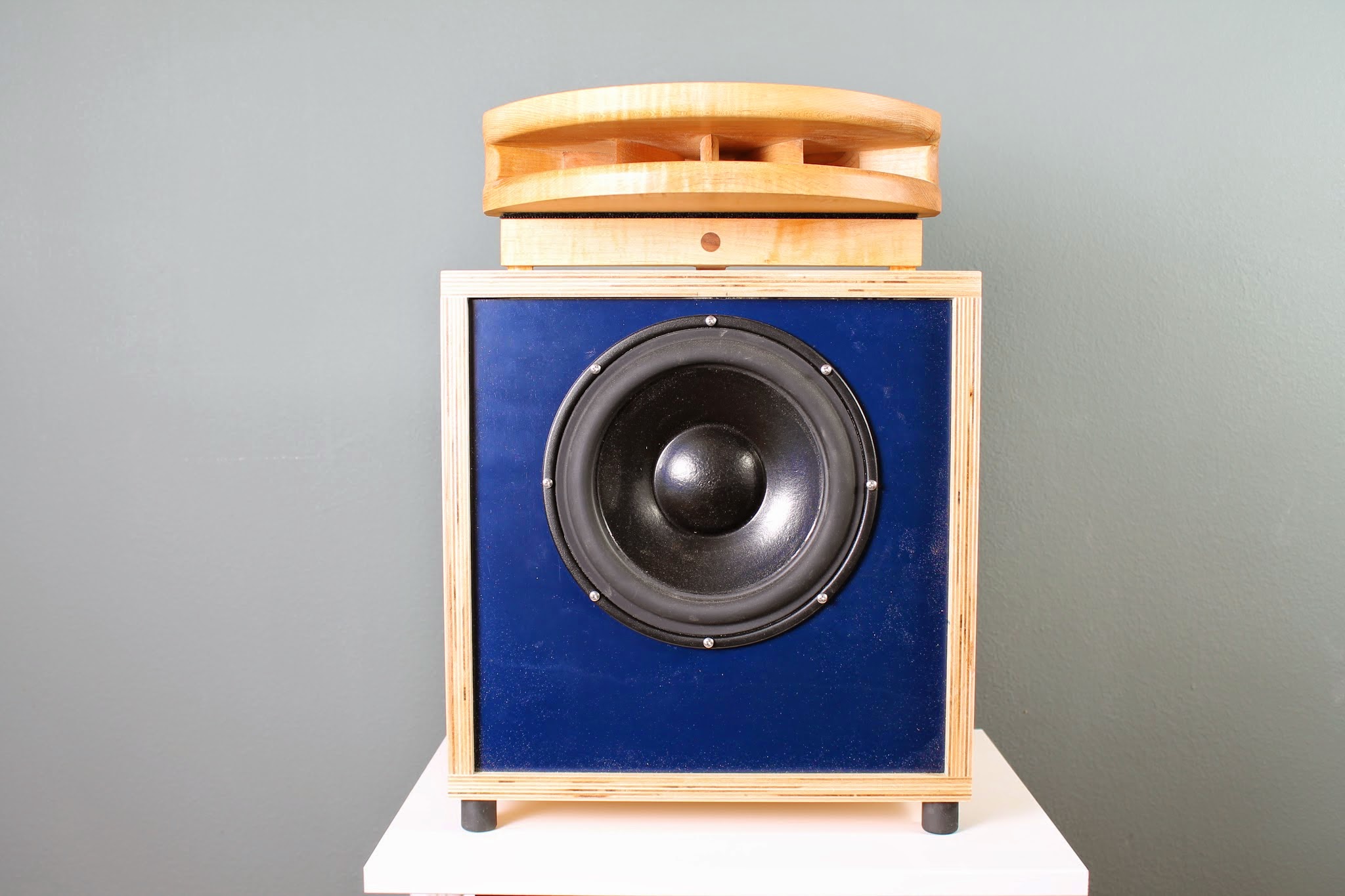

SpeakerScott, where are you setting your crossover on this speaker (the blue one)? What size woofer is this?
