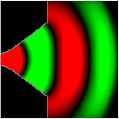

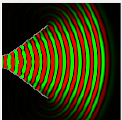

Broadly speaking, the highs will separate from the horn and travel as previously directed, whereas the the lows will spill onto the outer surface. This is dependent on the wavelength and horn size.
The interruption at the end of the horn (its shape) will cause a disturbance to the edges of the higher frequency wavefront, whereas the lower frequency reflection is more straight back through the horn axis although this may be difficult to see in these pictures.

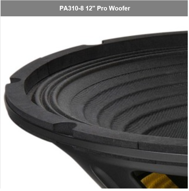

I realize that most pro 12" drivers have a foam lip on the frame surround. On this Dayton driver it is particularly pronounced. What is the reason for this and is this a source of diffraction?
It is so the driver can be mounted on the inside of the enclosure and seal against the baffle board. This was common back in the days of Altec and JBL front loaded horns. It also aids in hiding the glue line of the surround so that the surround is a bit prettier. These days it's a bit of a holdover...but a useful one.
Yes it could possible have some diffraction, but the driver will likely be beaming at any frequency high enough to diffract off that lip, so in practice the impact is negligible.
