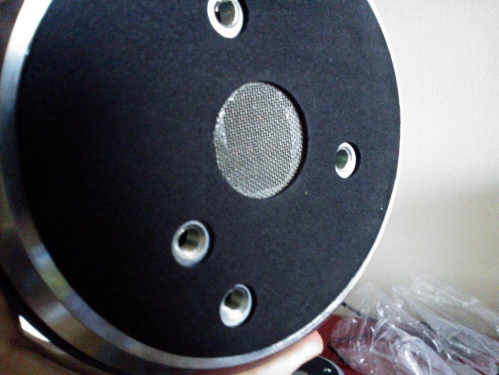

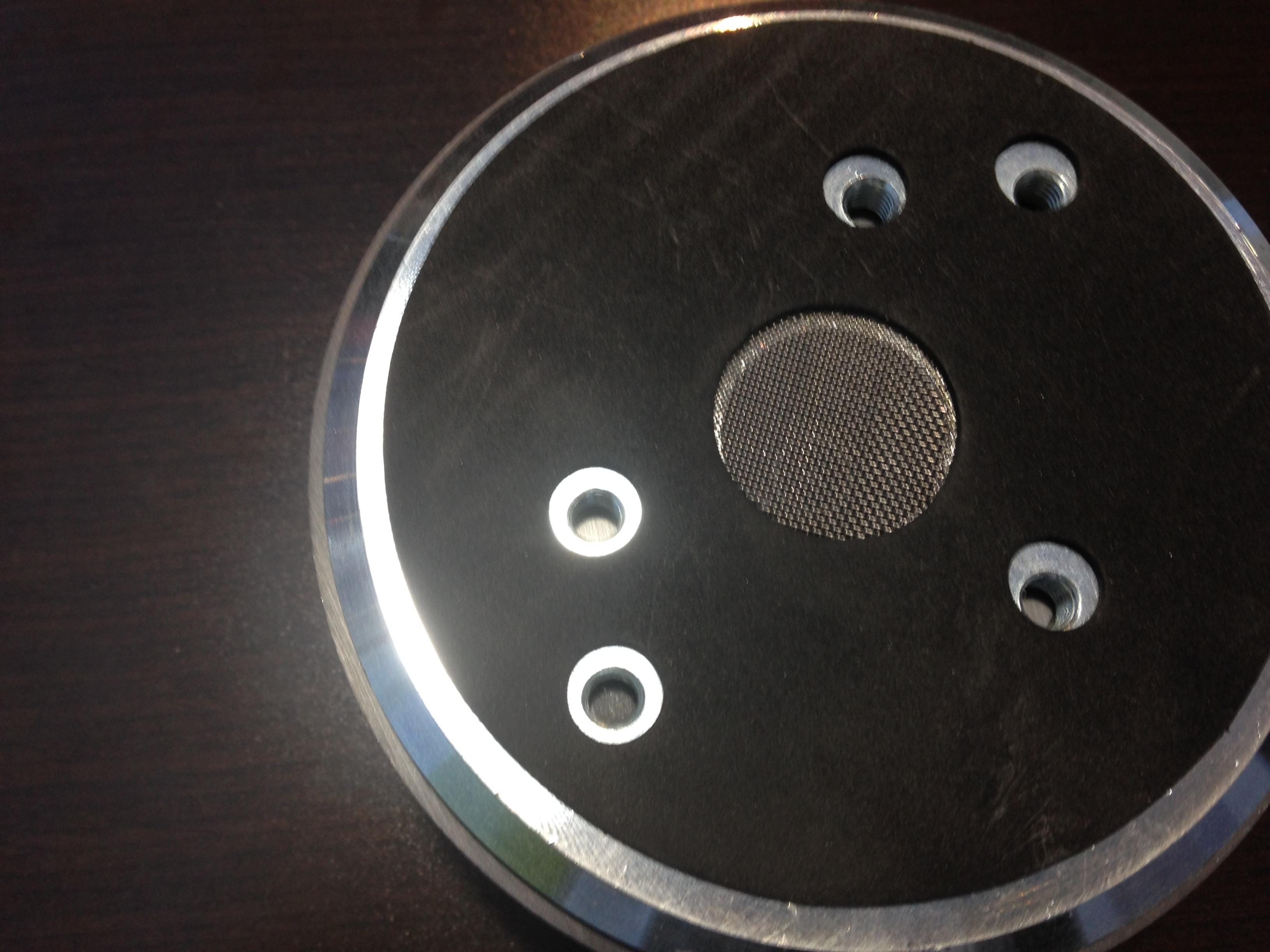

One of the compression drivers has some kind of film or something on the front metal mesh. It is kind of sticking in from the edges around the circular exit and 'is one' with the mesh. The other driver is perfectly fine, just mesh.
Has anyone seen this before? Is it worth returning? :sigh:

That film is at the critical throat. The worst place to have an obstruction. Maybe you can peel back the gasket and carefully lift up the screen and pick off the plastic film with good tweezers. I would normally return them but you mentioned having horror stories with all the back and forth with PE and being in Can doesn't help. What compression drivers are those?
They are Dayton D250P. I got them from Solen so it will hopefully be a little easier to return as they're in Canada... I may just return them. I specifically asked for a visual inspection to be done too. As you know I'm having no luck ordering drivers. lol.
What do you think? Return it or no?
BTW here are pics of the compression drivers.
Return....that'll definitely mess up the wave-front leaving the driver.
(Edit: Unless you can clean out...but I don't think you can isolate that mesh from the driver without damaging it...there is a planer wavefront that leaves that exit...it needs to be intact without diffraction or your HF will be all messed up.)
Is there an around the house solvent y'all can think of that on a q-tip might be able to dissolve it.... mind you it would probably dissolve the gasket too. p.o.s.

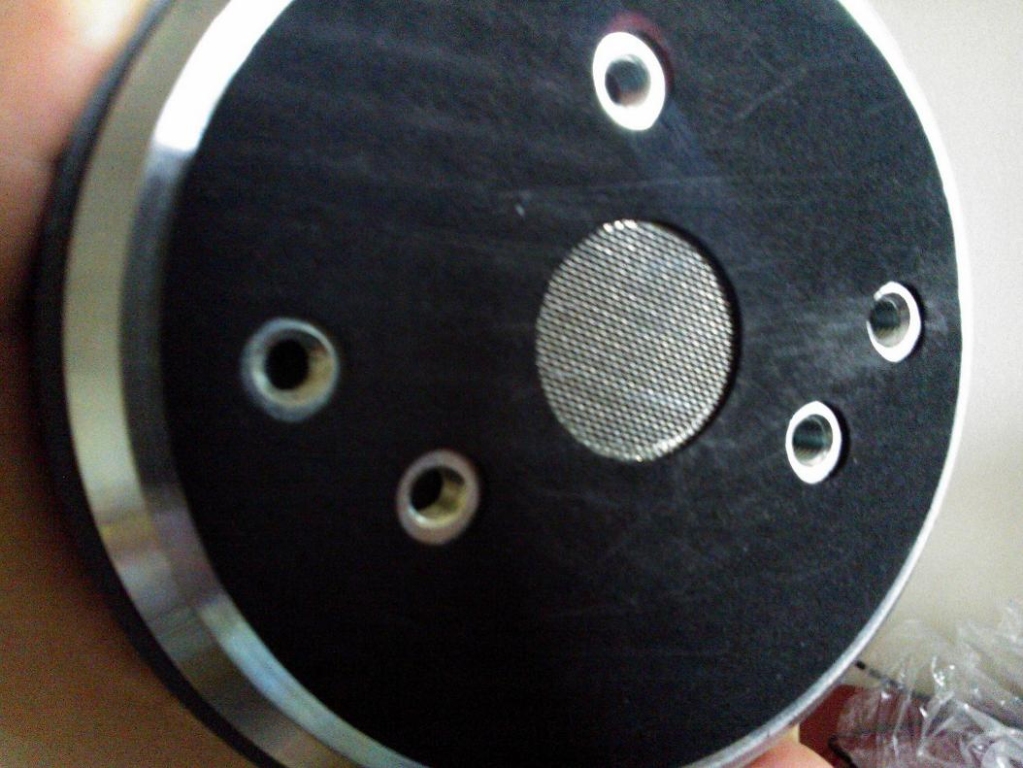

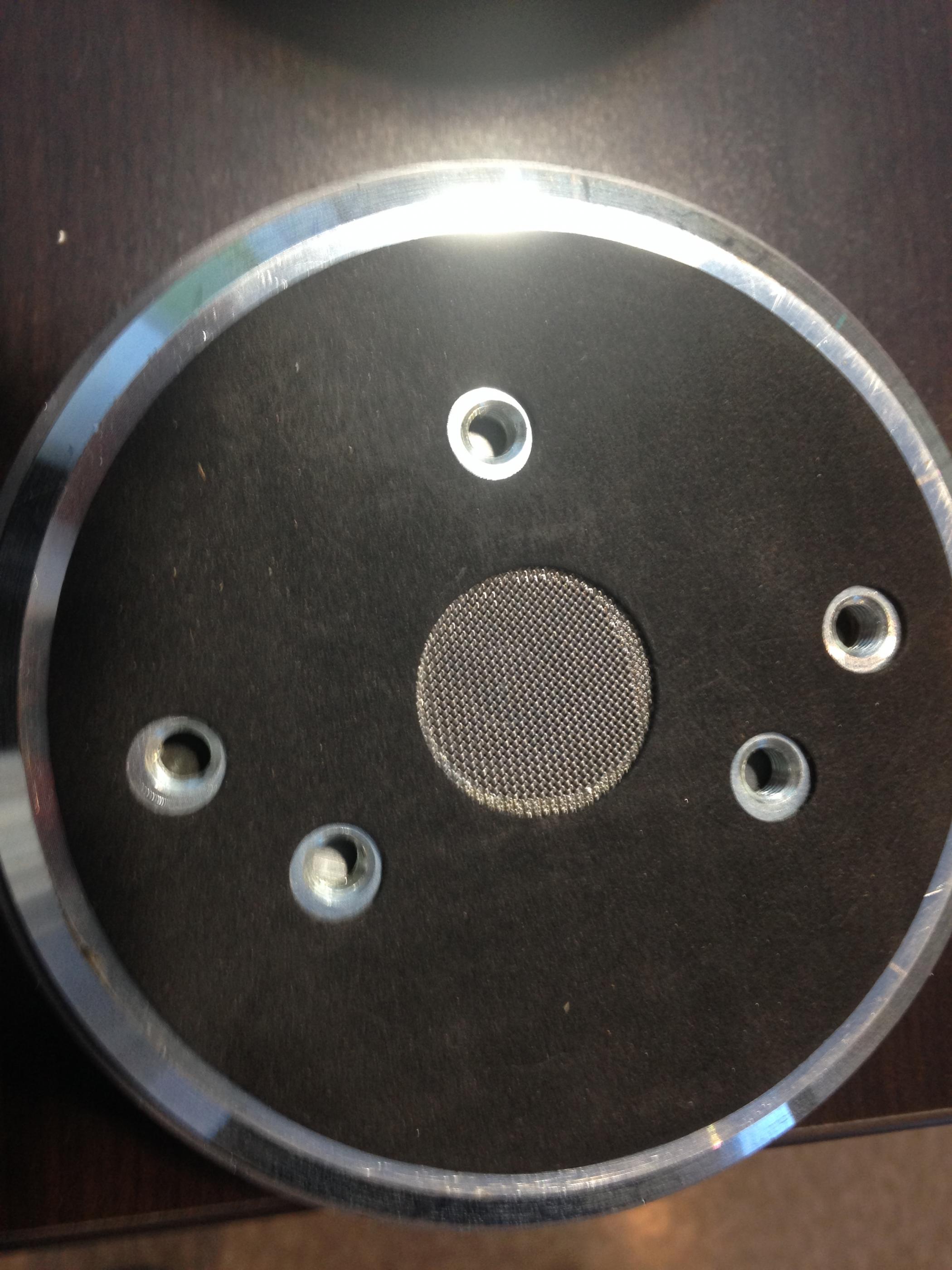

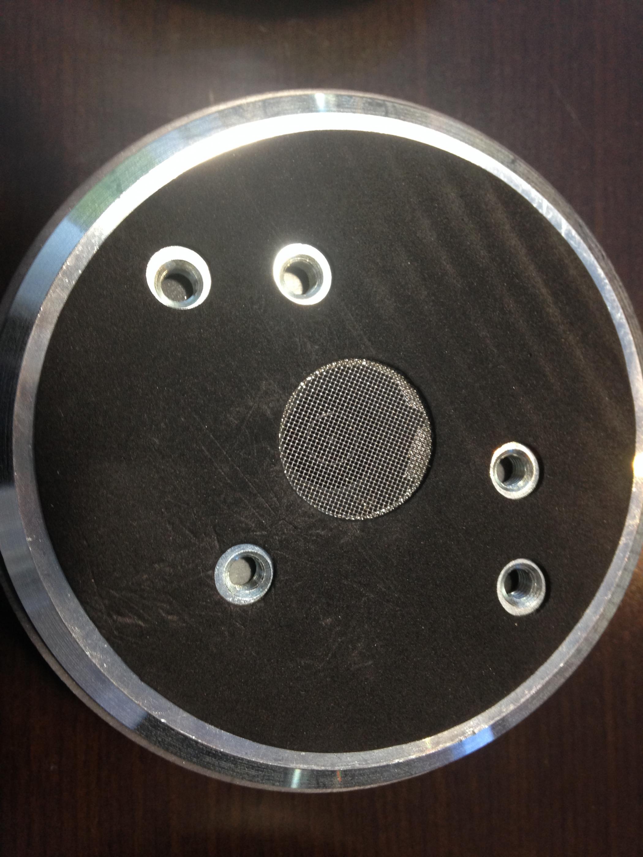

I found a place nearby that has the stuff for marine upholstery, it's 33ppm. And they can cut it for me too. I heard back from Solen today and apparently their whole stock is like that! They sent me pictures and some are worse then mine. I see why some people stick to the B&C DE250 for quality control instead of these knockoffs.
I will have to get crafty to take the mesh off... the gasket material is on there snug. I am going to try lightly touching the film with a solvent on a Q-tip or toothpick first.

Huh...I've purchased three of those tweeters....none of mine had that. Yikes...
If you put the 30PPI reticulated foam in front you can pull them off...no worries. The rub and buzz from a dead bug is no good.
Solen pics
Here are 3 of the pictures they sent me. I am starting to wonder if it is actually the same metal that makes the mesh... It quite hard to tell with the naked eye and a flashlight.
