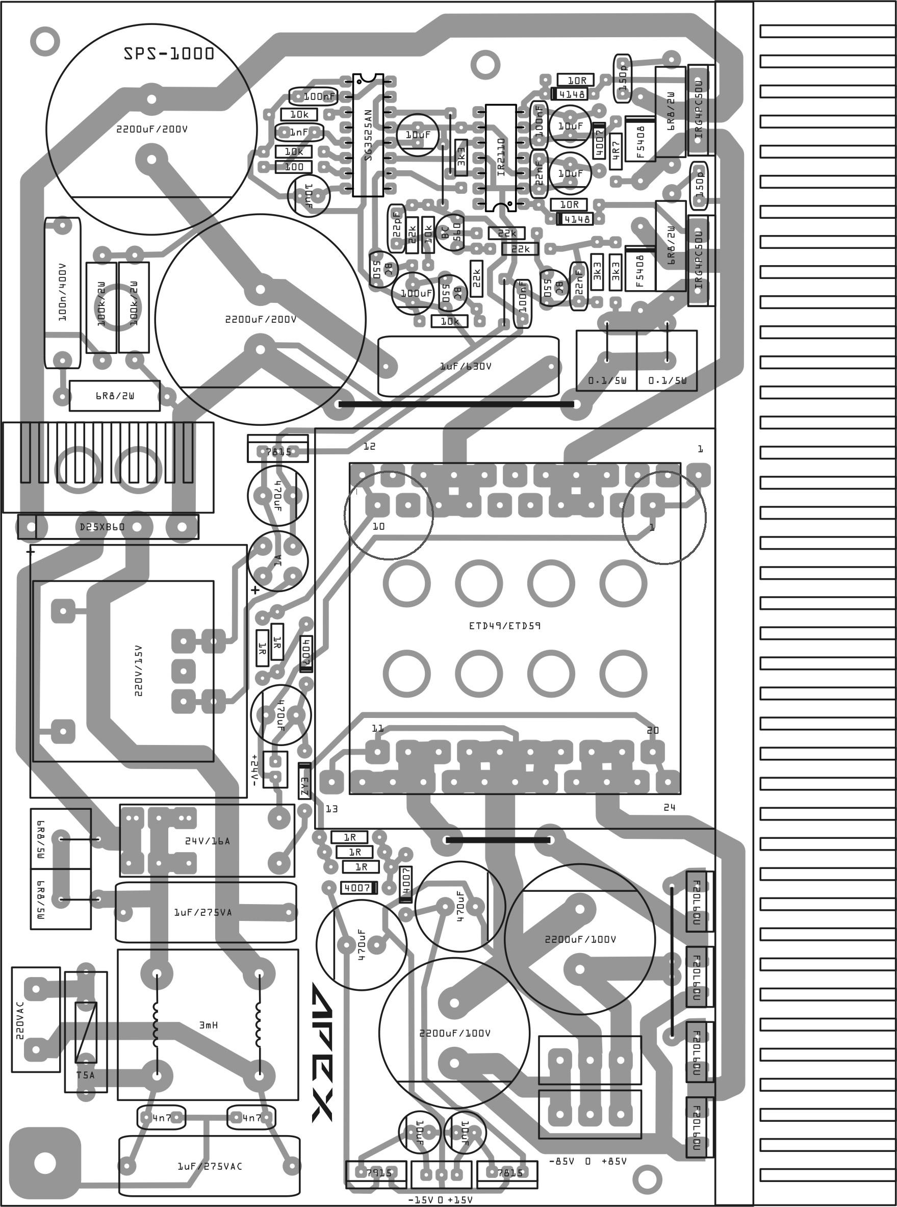

Are we speaking about this smps?

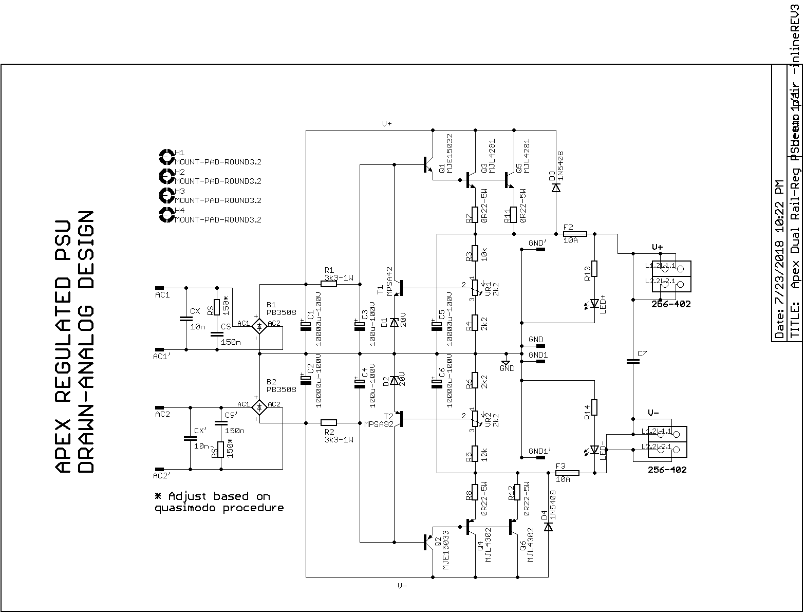

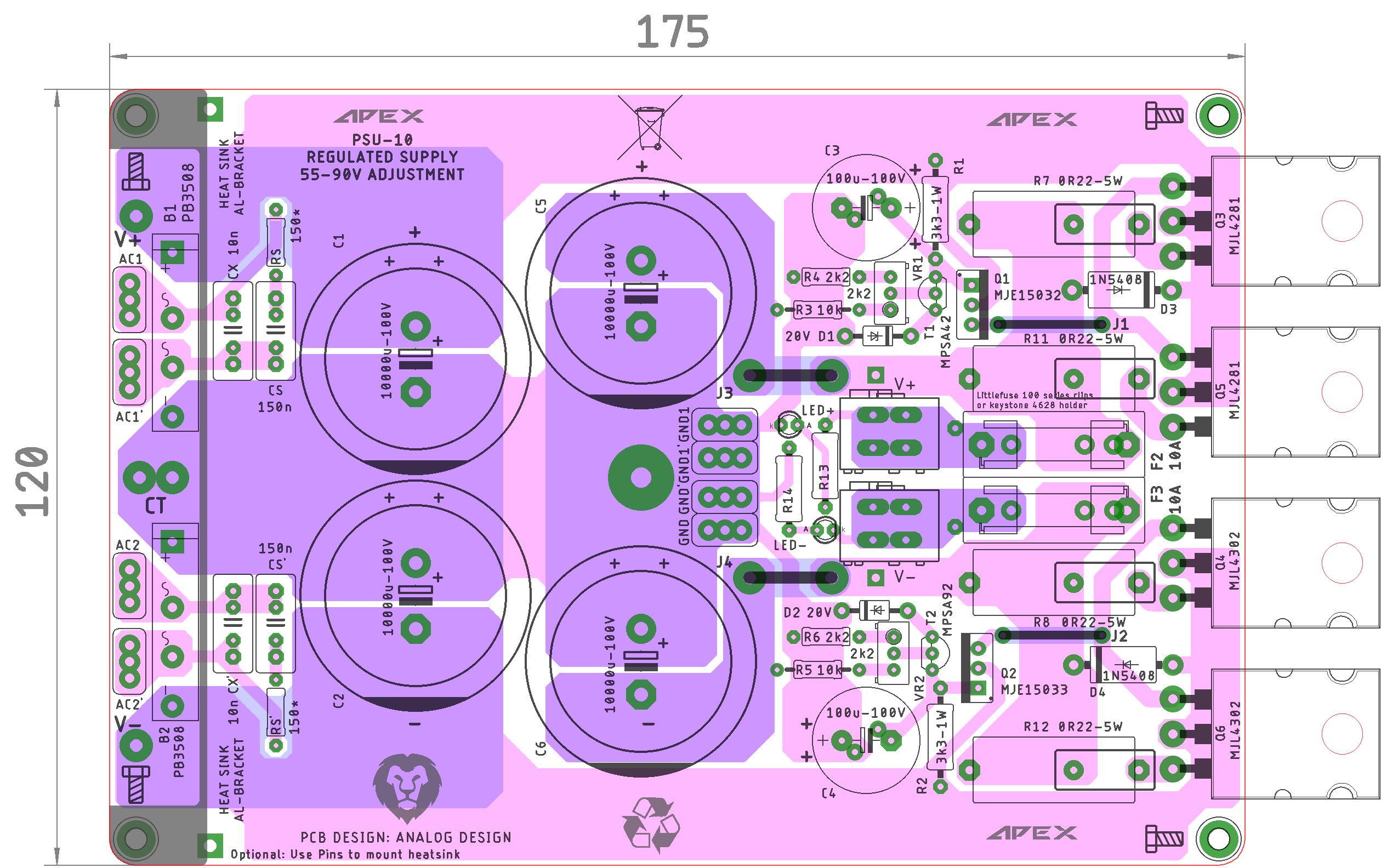

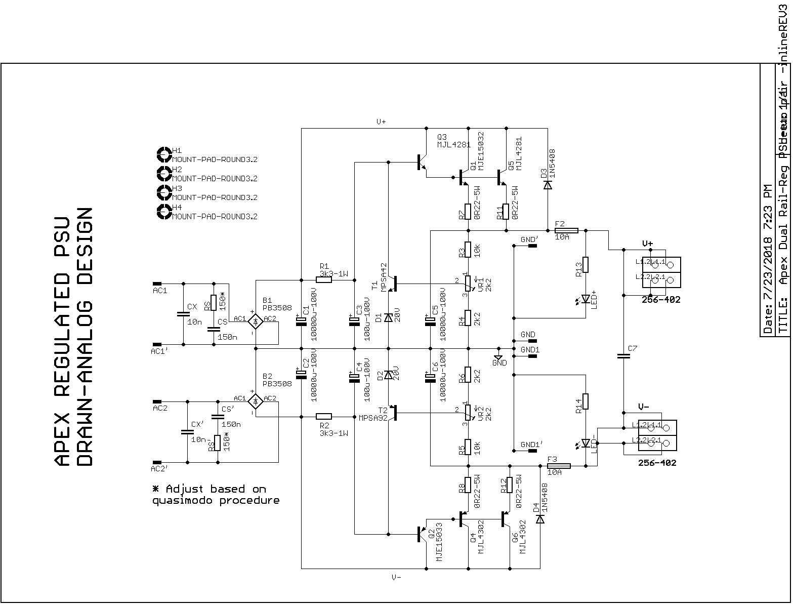

here is a final version of APEX regulated PSU made fine tuned with transformer snubbers and the premium wago 256-402 connectors for the o/p. The layout is single sided and can be etched at home. Or can be produced at boardhouse as a 2 sided layout.
regards
Prasi
