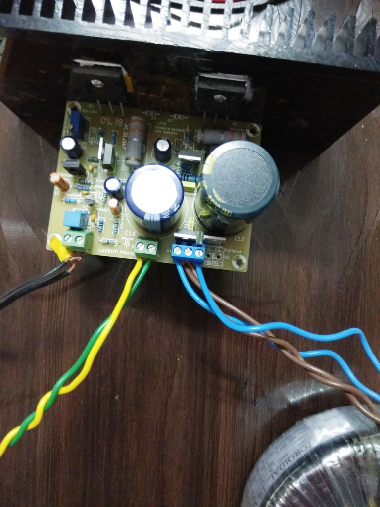

Hi all,
Success!!. It fired up without any trouble.
Transformer , a big hefty 400VA 2x 35VAC that I had.
On - board PSU used consisting of 2 rectifier diodes and 10kuF cap.
PSU voltage 53.7 V
Mid-point voltage - 27.6V
no hum or hiss or any kind., transistors and zobel cool.

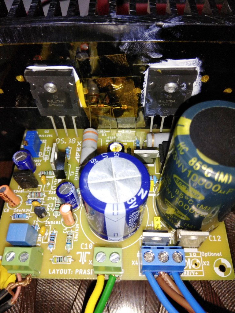

bias set to 15mV across 0.33R emitter, so bias current is =45mA.

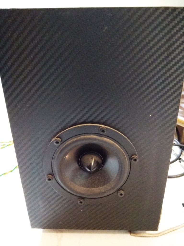

Sound: very nice, relaxed sound, although caps haven't been broken-in and only a single channel. Still using ordinary caps. When building stereo, I intend use good ones I have. Test speaker is a full ranger with Dayton reference series RS100-8, 4" in a 3.2 liter box, that was gathering dust (you can see)
It seems on board PSU is sufficient to get a good sound without any hum. SO two channels of these and a transformer would make a compact amplifier with some other hardware like chassis and connectors thrown in.
attached: some pics and sound recorded thro mobile phone, so not good quality.
regards
Prasi
edit: o/p device MJL21194. pic shows how the bias diodes mounted to heatsink with kapton tape, forgot to put in heatsink blob. will do it with stereo build.
