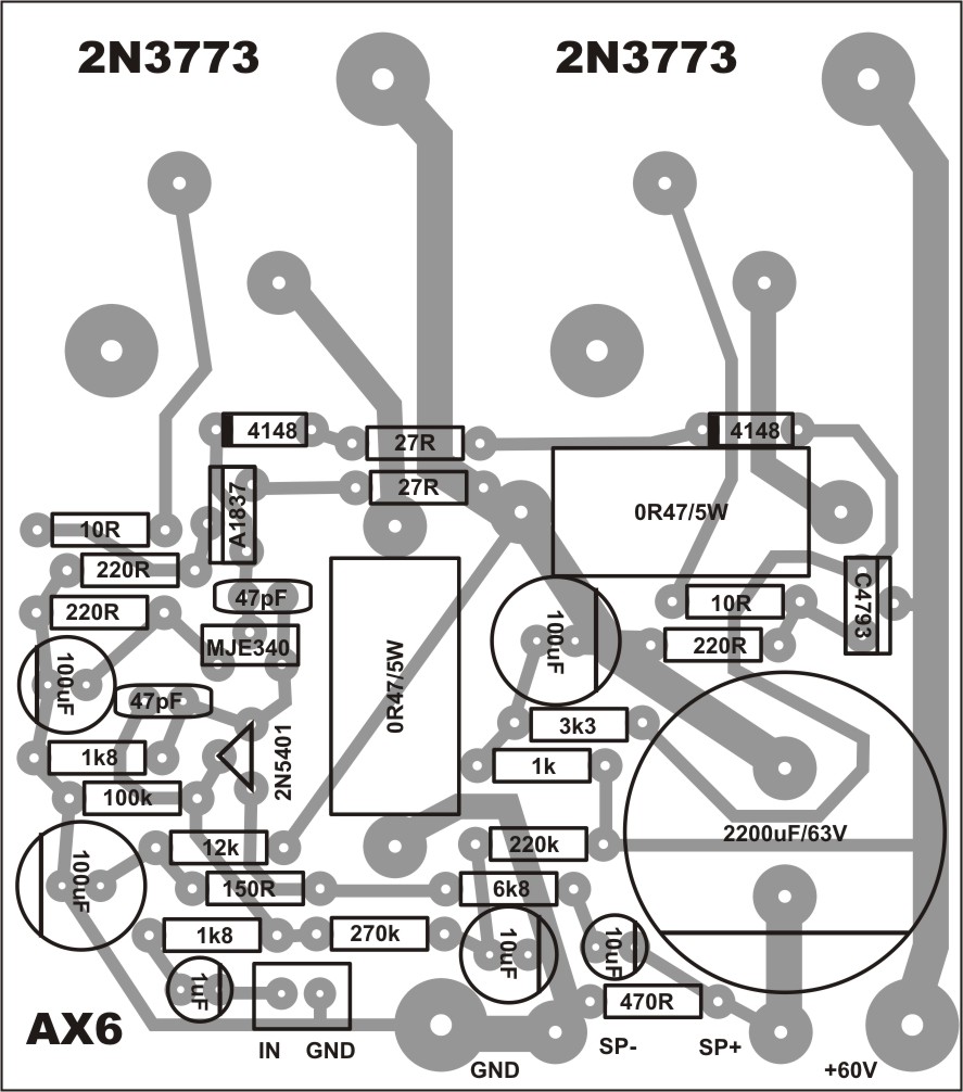

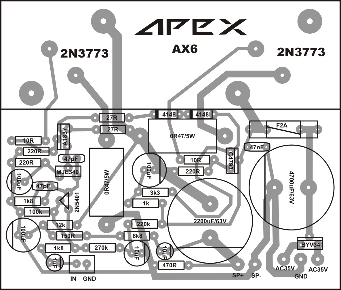

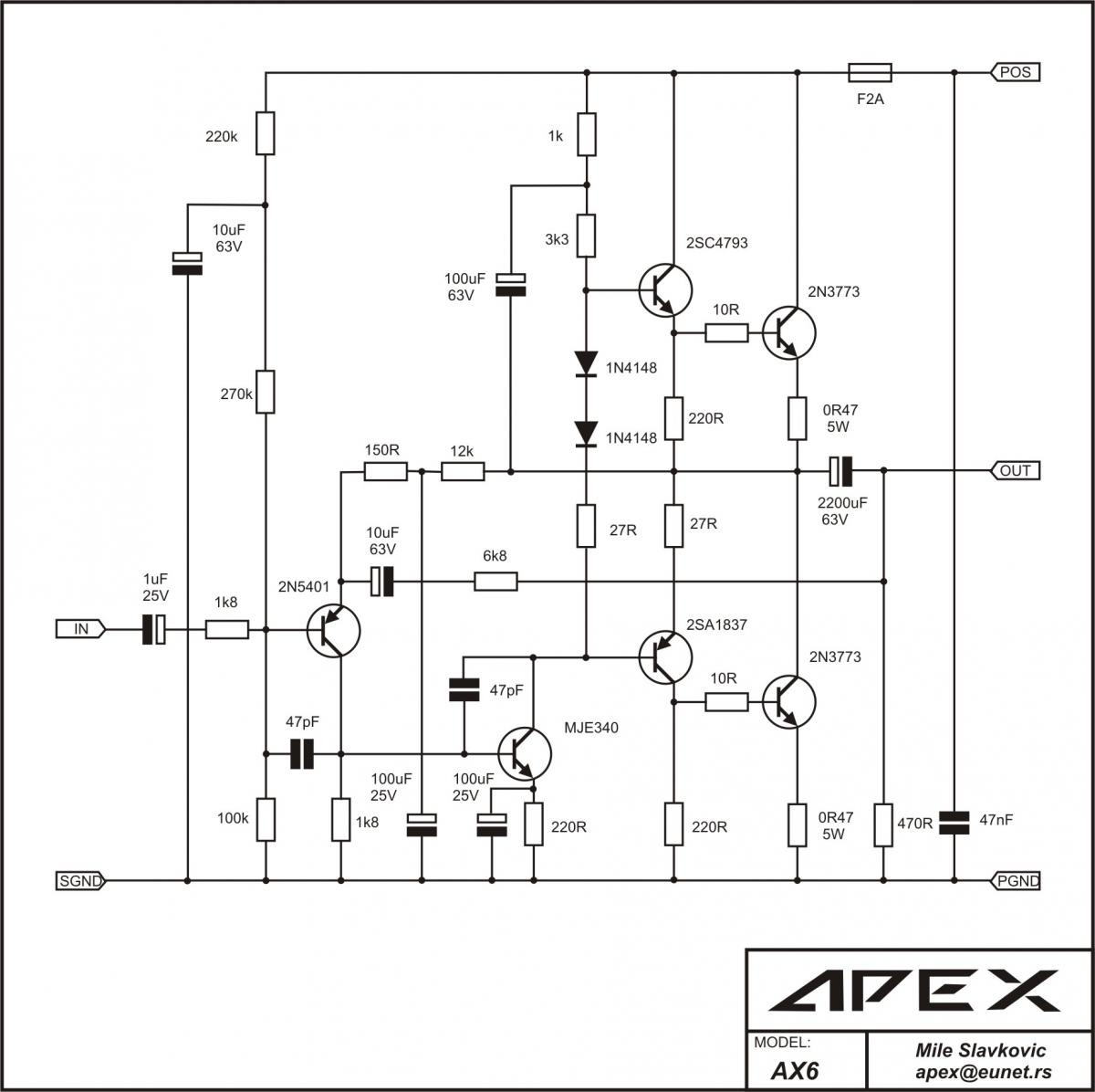

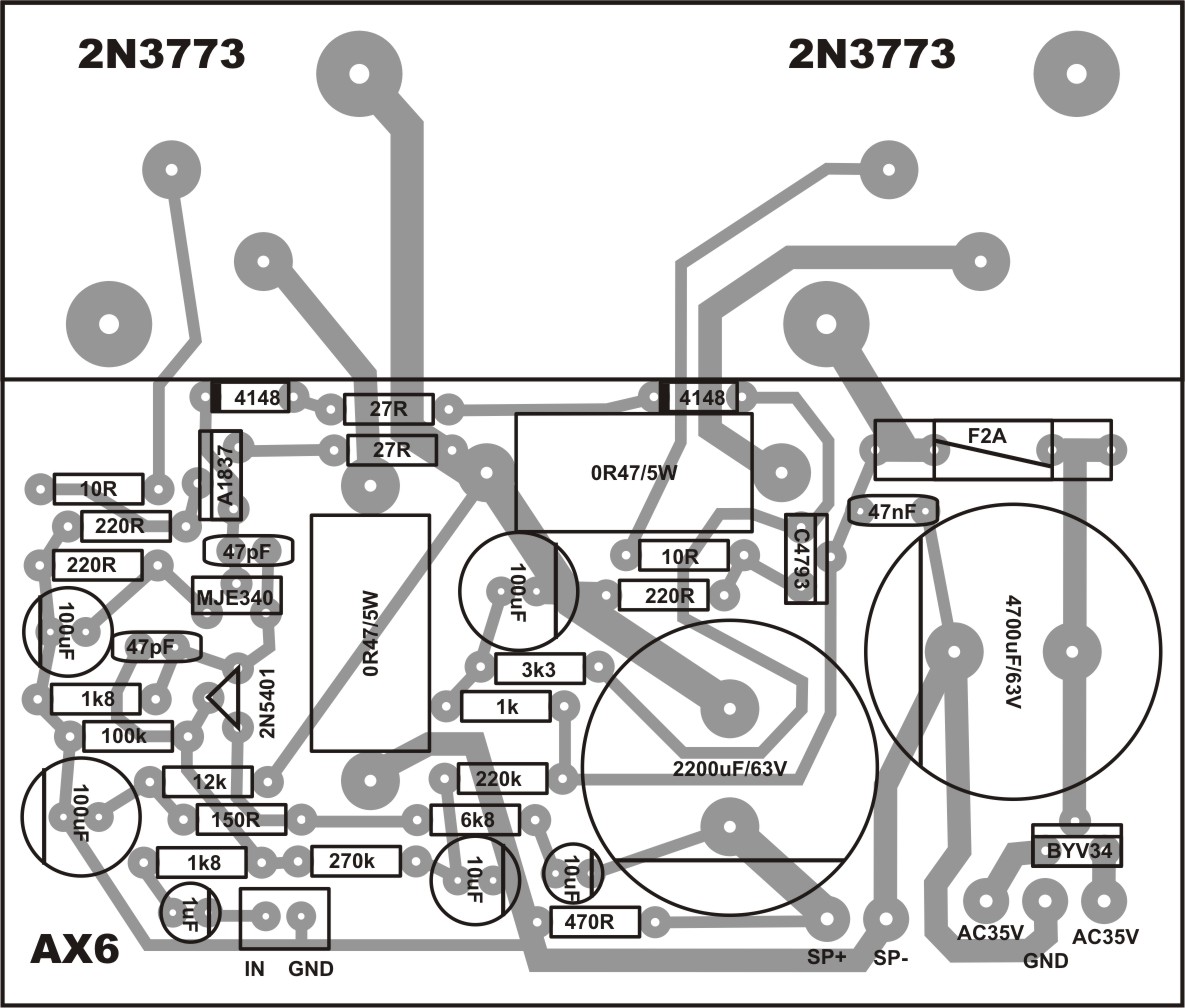

Retro Amp 50W Single Supply
Old single supply topology no need DC protect :)

Me too have built my first amp based on a circuit similar to this one.
The output cap is within the ac feedback loop - this lessen output cap size requirements somewhat. But a small output cap will limit power bandwidth. Better use to use 4700uF or more.

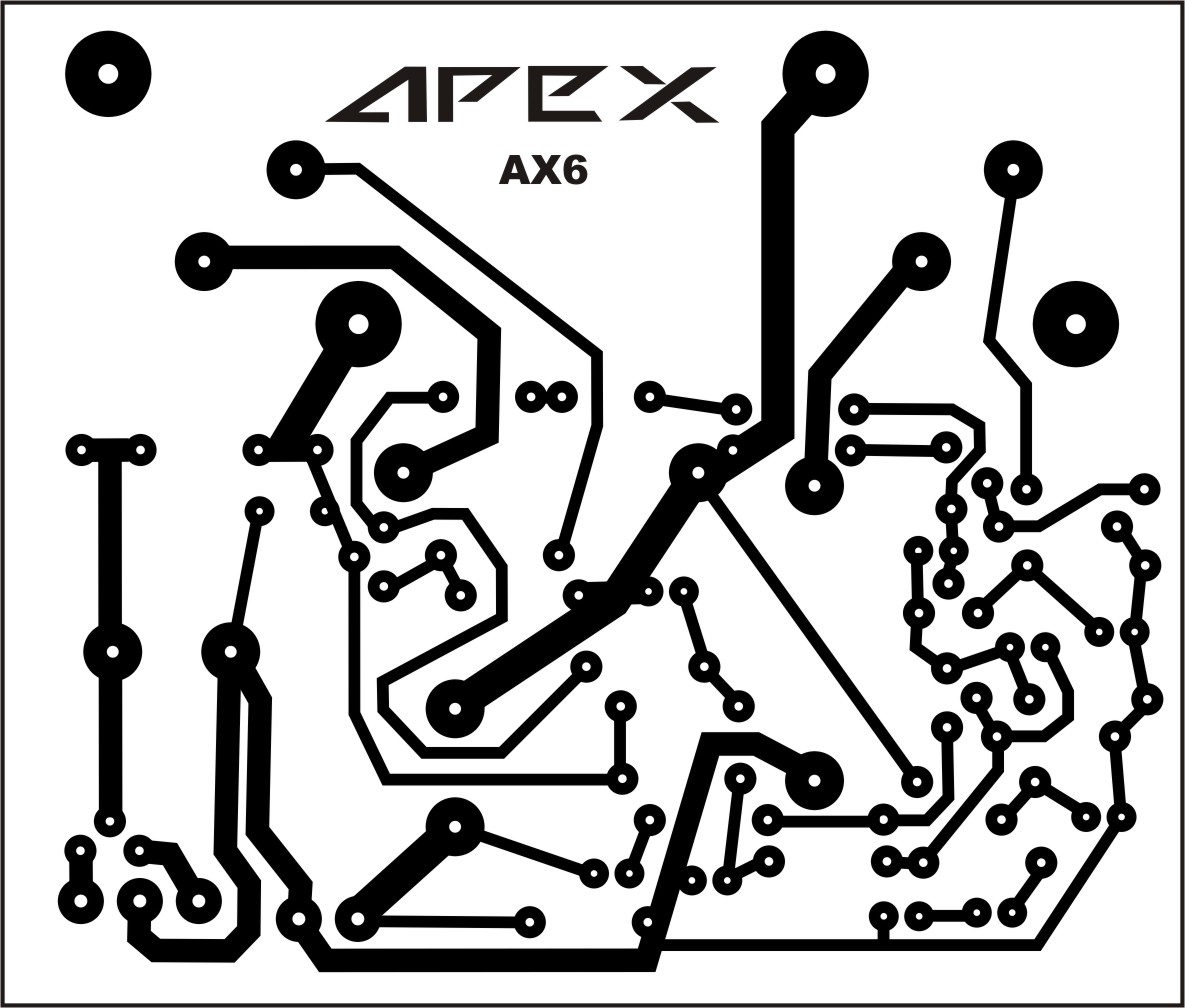

This amp is very different compare to Leak Delta 70. I don't selling stuff, you must diy PWB's for this amp :)
Regards

Is it good practice to have the input of the amplifier absolutely not guarded against RF ?
is it good practice to have extremely fast drivers to drive too slow outputs ?
Also 2200ufd in the output will only serve as a memory of the past now days i think far more is needed
Kind regards
Sakis
You can use BD241/242, TIP31/32... if you want slow drivers, and 6800uF/50V can fit on this PCB if you want (25mm diametar)
Regards
