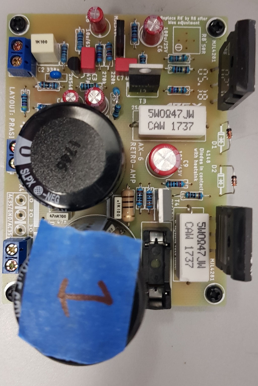

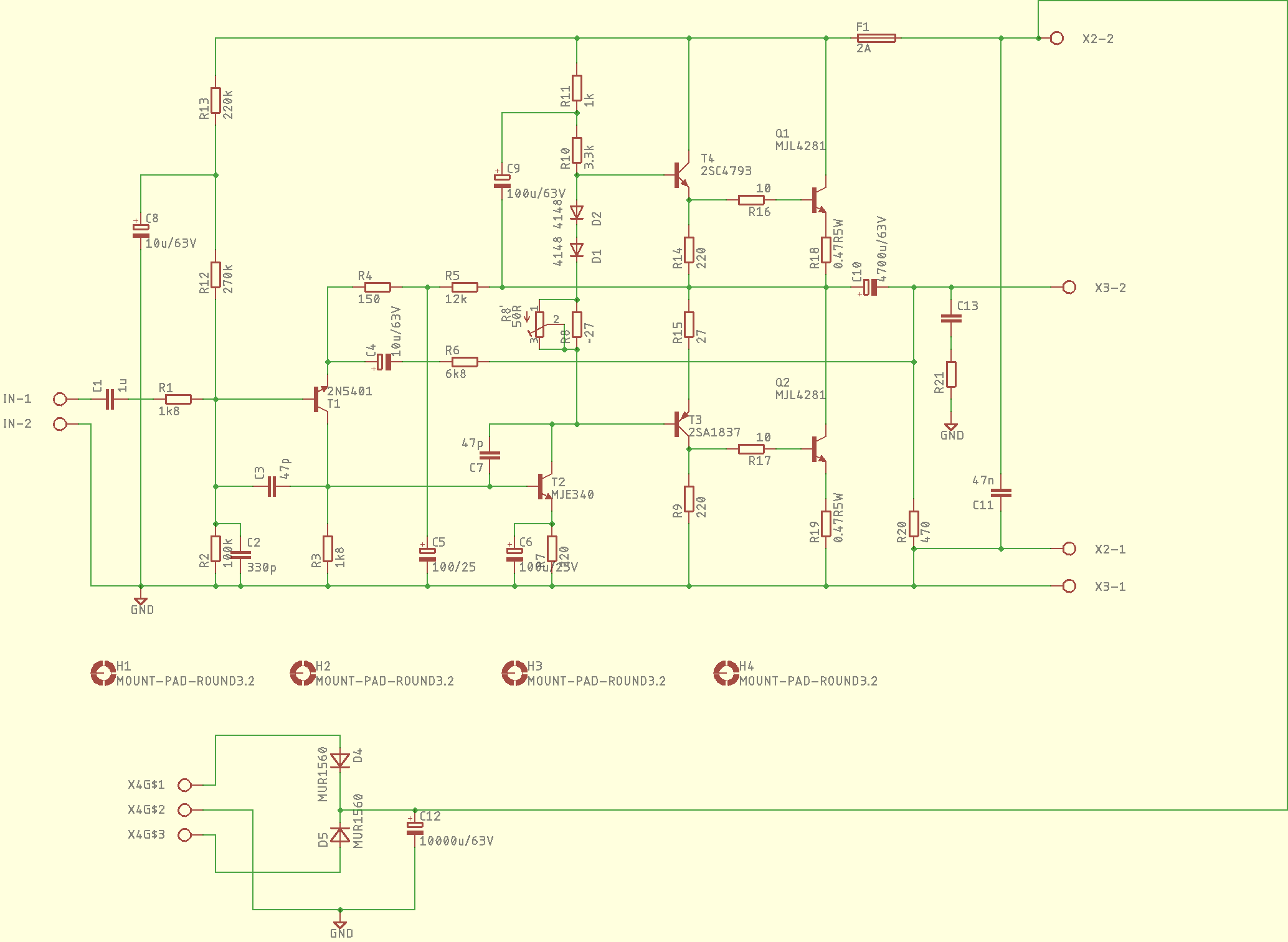

Just powered up the second board (AX-6) but seem to have a problem.
I see some bias across R18 which then falls to 0.
I have pretty much rail voltage between the R18-C10 junction (where I expect to see approx. half voltage).
Anybody have any ideas what to concentrate on before I pull this board to bits again?
All components are brand new, genuine and double checked for value and solder joints. This board is physically identical to the working board.
Cheers

I've attached a small video to demonstrate the noise and feedback that I've got on the ax-6.
I wonder if someone can help me out - I've got 2SC5200 as outputs in lieu of MJL4281. Everything else as per ax-6 schematic (except R5=14k).
Are the 2SC5200s unstable in this configuration?
Is there anything in particular spec wise with the 2SC5200 versus the MJL4281 that would indicate incompatibility to someone more experienced?
Can I do anything to make this amp happy with the 2SC5200?
Thanks!!

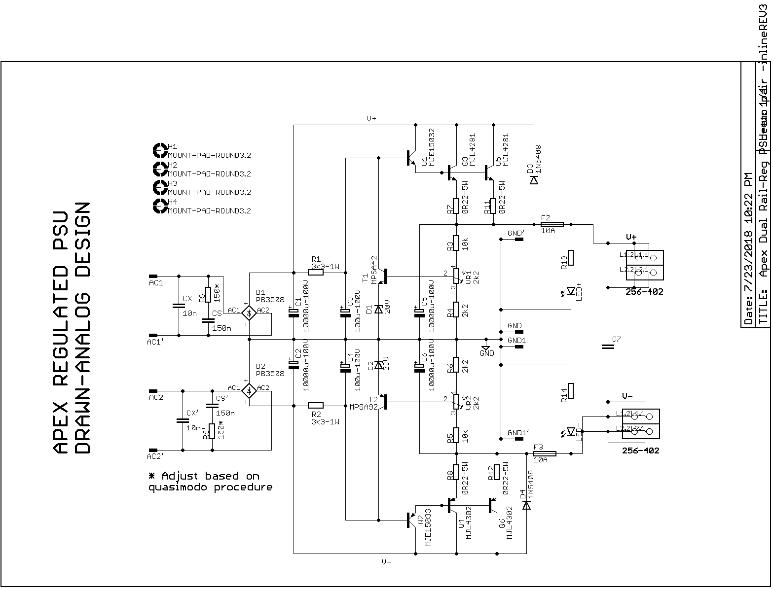

Just coming in late here but my observation is that this PSU is basically an amplifier without any capacitor compensation on the feedback loop. You are not going for audio bandwidth on the control feedback loop so maybe add 22nF film cap across R3 and R5. That should dampen any feedback induced oscillation. Also, I noticed that there is a lack of usual 100nF bypass film caps on all of the larger electrolytic caps. That might help on C1 directly.
693356d1532364891-retro-amp-50w-single-supply-apex-hv-reg-psu-2pair-sch-fin_rev3-png
