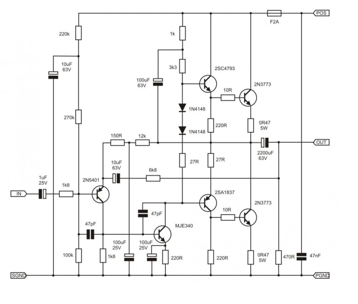

I'm using the pcb layout posted by wiljj78 at post #72. Transformer is 250va dual 28v secondaries, which gives a rectified 42v DC. Mid point voltage is set to 21v DC and bias is set at 25mA. Output Transistors are 2N3055H (Magnatec), these were £10.40 for 10 so I knew they were going to be good, cos you have to pay for quality!
Here's the thing though, it's cool, like the John Candy film (movie) "Cool Runnings". I expected the things to be finger meltingly hot but the transistor casings remain cool so I know I've done something wrong. I really should put it on the scope to see if I can work out what the problem is (I have to work out how to use the oscilloscope first though)
Had it singing the "blues" for an hour this afternoon, it has a certain warmth and depth to it, and more than adequate volume for my apartment. I think the AX6 is going to replace the MX50 (ebay kit).

Reference post #212. I had to take that AX6 (mod) board out of service because a couple of loose solder joints (p2p build) had come loose causing large popping. A new hotter soldering iron fixed that: while I had it out I addressed the perceived lack of high frequency response versus the original dynakit ST120 PC15 board still in the case with 1970 RCA TO5 drivers. I replaced the TIP31c/32c I had used as drivers with MJE15028/29. Voila! AX6 high frequency response is great, just as good as the PC15. Test tracks included top octave piano (Peter Nero Young & Warm & Wonderful, When I fall in Love) and Martin Denny Hawaii LP with high freq percussion instruments. So the 3 mhz Ft of the TIP31c/32c was really holding back the NTE181 outputs ( rebranded MJE15003 possibly), which were set free on high frequencies by the 30 mhz Ft MJE15028/29. I'm still using a GE Semi D44R2 TO220 VAS transistor, which is not a problem my ears tell me.
I'm still using the original dynaco 6.5 amp 72 vac transformer, regulated by 5 parallel TIP147 transistors to 70 vdc. That was the point of the project for me, not buying a transformer & case from a source I disrespect. Also protecting my $600 each speakers with a cap instead of a relay rated for AC loads which might weld shut under DC fault current. The original PC15 board had become damaged beyond repair due to TO220 transistors twisted in place to replace to unavailable TO5 driver transistors blown before I bought the amp.

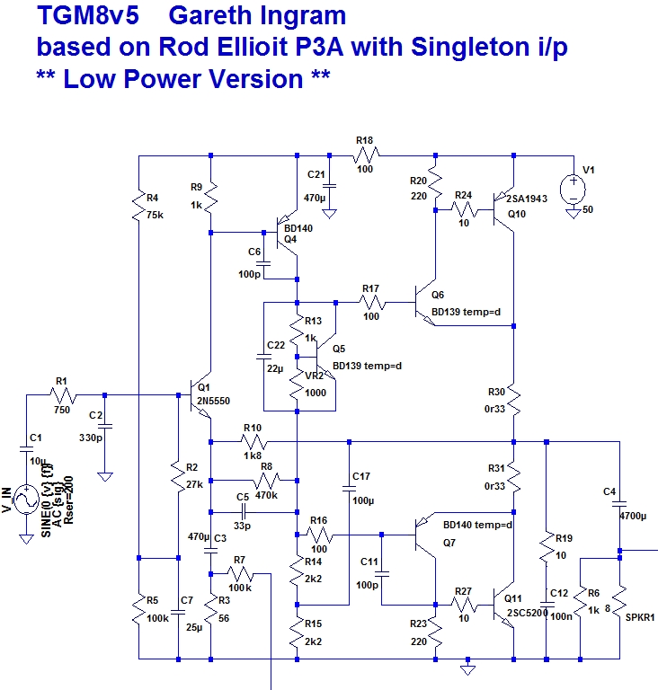

Hi ... which of these three has better performance at 50VDC ... Apex AX6, TGM8 Retro or Elektor Equin?
Depends what your definition of 'performance' is.
What are your goals or parameters?

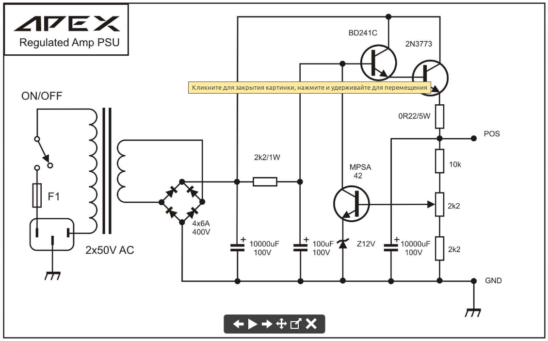

Can i use this simple power supply with an 80VAC transformer to power the AX6 without changes?
2* 40vac or 80vac?
I suspect the voltage will be too high without making changes to suit.
