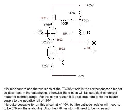

Hi out there,
so for anyone interested in a tubebuffer:
Here it is....
Thanks to george who recommended this
too and linked me this schematic.
ulf

le´flu said:
Hi out there,
Here it is....
ulf
yup
that's sort of SLCF - origin (according to AW) coming from ancient Tectronix 'scopes
CCS as load (lower triode) , working triode cascoded - so working in constant voltage conditions

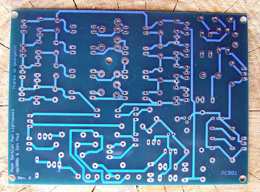

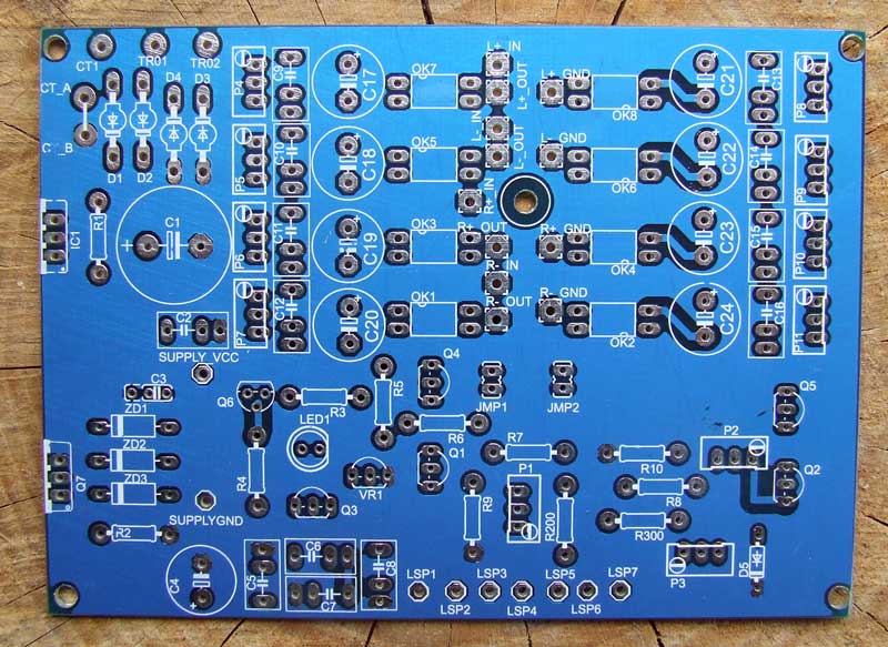

well ....... we received today small batch of final pcbs .....
pcb01 - PSM LS
pcb02 - dedicated buffer
also - adequate number of Silonex LDRs is ready for extensive matching session .
as important note - entire project is made for balanced stereo mode , where you can also make it unbalanced , simply omitting half LDRs and two buffers .
I'll post later this evening few pics , with more details regarding construction etc.
