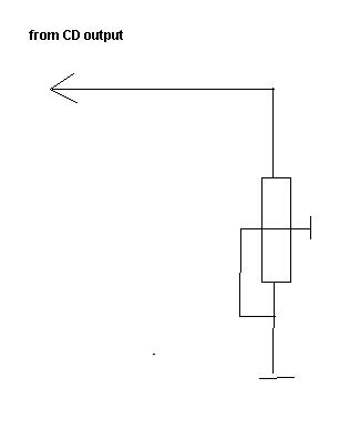

measuring output impedance is easy ;
first you need CD with recorded steady sine wave sig with frequency between 400 and 1KHz
put it in CD player ; disconnect all signal cables from CD - so it isn't connected to any load
play that CD - and measure output voltage ( directly at output RCA ) ;
write it down .
then take one pot - wire it as shown on sketch ;
pot can have 4k7 or 3k3 value
connect it qas shown - between hot and gnd on RCA CD output
play same track
measure output voltage with DMM as previously ( between RCA hot and gnd) , and decrease pot untill you have exactly 50% of previously measured voltage ;
power off
disconnect everything
measure with DMM what is resistance of pot in that position ;
that's output impedance of your superdoopertweaked CD
easy - isn't it ?
:clown:

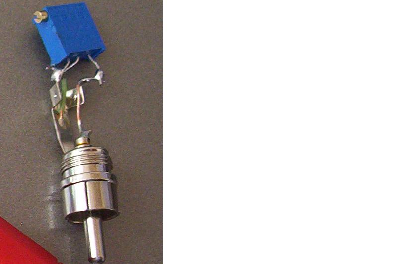

That was interesting. 1K sine wave used.
830 ohms measured off of pot enabled RCA once removed from CDP.
So it's a highish output....
Mike

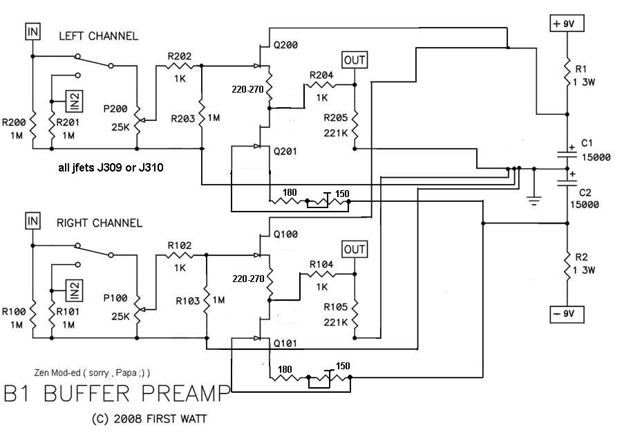

Re: Re: Re: PSMLS dedicated buffer - schematic
Zen Mod said:
you need buffer on CD xformer output to ease that signal to reach outer world
you can make it easily - not as B1 , because B1 is pot+buffer , but as sole buffer ...... probably as integrated part od CD alone ;
any kind - either JC , or EB , or whatever .....
you can use Poor Serbian (B1) Buffer - with two J310 ; they're cheap and easy to find .
ZM -
I find no reference elsewhere of Poor Serbian Buffer - does a schematic exist, or this part subbing in papa's design?
I assume buffer of some sort w.o. volume control can lower impendence for the best ... for going into the solid state world.
Not sure the reference to JC or EB is. :confused:
Tea-Bag.
Official Court Jester
Joined 2003
Re: Re: Re: Re: PSMLS dedicated buffer - schematic
Tea-Bag said:
ZM -
Tea-Bag.
schematic is in post 5 of this thread .........
or find final version attached .
JC = John Curl
EB = Erno Borbely
  • pcb02_el_schematic_rev_b.pdf

Would the power supply in the PSMLS function well in Zen Mod's B1 ? Of course design would be modified to change +-12V to +-10V.
What sort of power supply did Zen Mod have in mind for B1? :)
I only ask because I need to build one for my B1 but if I build a PSMLS I won't need a B1 since PSMLS performs same function. :xeye: :confused:

anyway - you can implement 47nF ceramic cap from B to E of both Darlingtons ......
or even better - use exact schematic od shunt reg as in PSM LS buffer stage ( post #127 ) ;
I'll change few values , to accommodate it for J310 B1
depending of exact Ids of your J310 - source resistances are chosen for ~ 5mA through jfets
