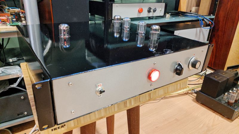

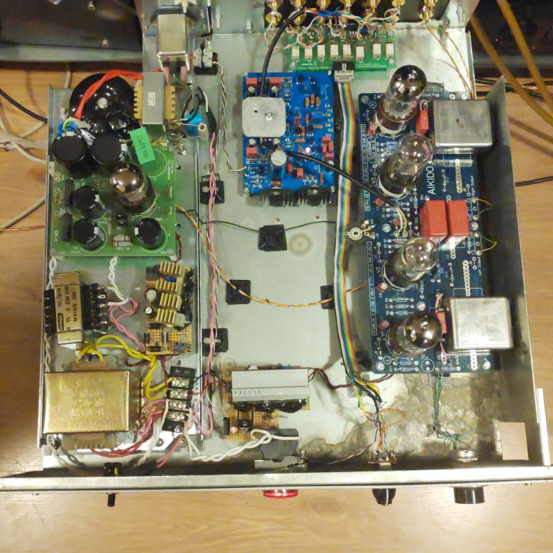

Ok, I had a look at the iron pumpkin! That's quite the piece of kit!
So the 10k linear pot arrived, easier to use for sure. The voltage on the bases of Q1 and 2 are pretty much the same, varying from 0.7V to 1.4V. Temperature definitely affects the total current though, I did an experiment where I left it in the workshop at 4deg c and current was 8mA per string. Inside in the house at 19dec C and current was 13mA without any other adjustments made.
It works great, sounds great, I'm a happy camper.
I've attached a few pics of the build - an old twisted pear relay source selector, into psmls, then to a tube rectified 6sn7 aikido. It sounds very good.
Thanks for all the help (assuming that you don't see anything wrong in the readings above)
Fran
