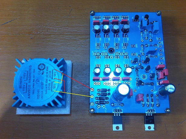

about the transformer wiring, i have soldered four diodes, is that TR wiring correct?

about the transformers, wasn't there are two options? (CT and nonCT)
and in my case, 4 diodes are soldered, so i make the dual sec trafo into single out by paralleling the outputs.
(sorry, i'm not patronizing) :D
btw still need to make sure if everything okay.

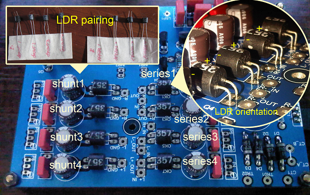

about the LDR orientation,
and the LDR match pairing positions,
whether it is appropriate?
thanks.

except in case when I know for sure that windings are bifillary wound ; that's why we made those options

regarding placement and orientation , you got it right , according to your pictures
