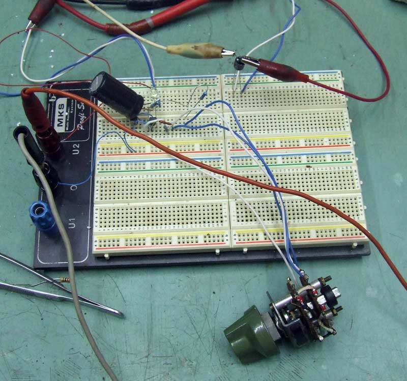

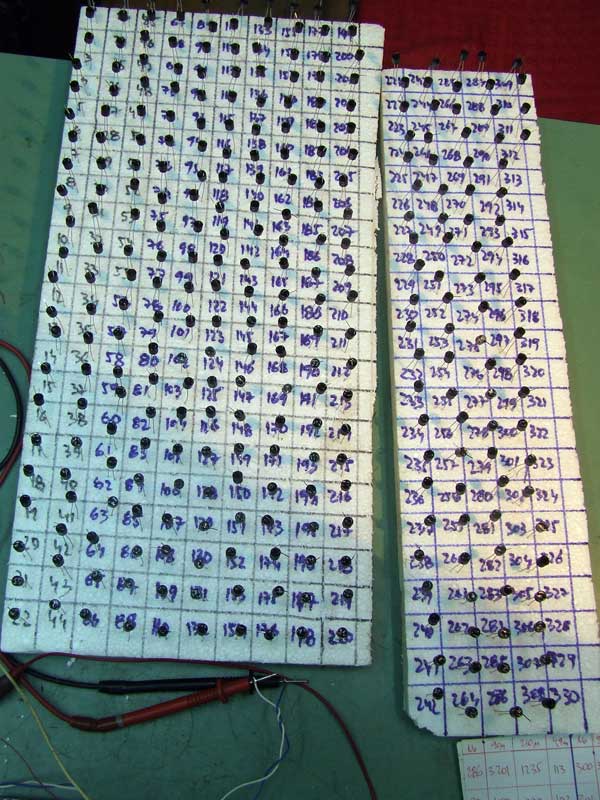

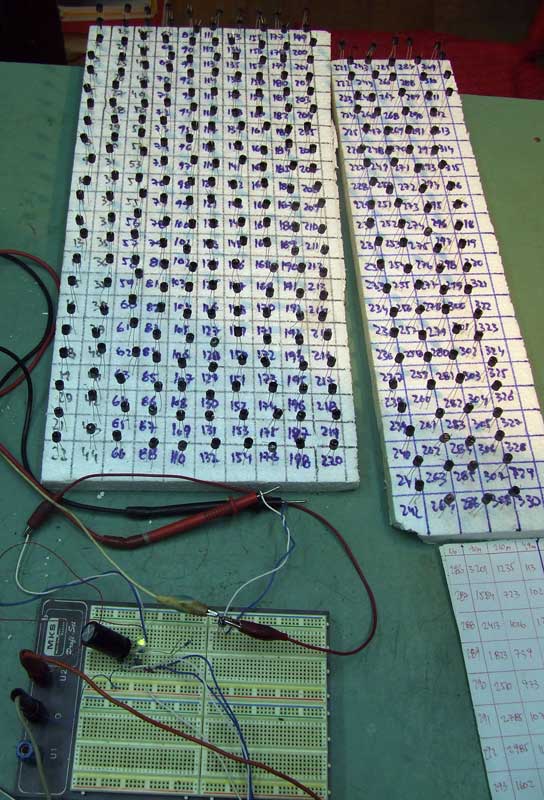

Hi Choky,
I just finished the matching procedure of my (small) batch of 50.
I've encountered, however, a problem: my basement is quite cold (abt. 10° C), and the LDRs are veeeeery temperature-sensitive.
The R value (@ 30mA) vary of even 10% in a few minutes.
Could it preferable matching LDRs at a hottest ambient temperature? How much time do you wait for a correct reading?
Or can a reading "at the flight" after few (3-4) seconds be correct (for matching purposes)?
Guido
Guido
GuidoR said:Hi Choky,
Guido
that wasn't problem when I measure mine batch , maybe because temp in my workshop was ~22C ;
anyway - with higher currents , settling time is much shorter than for lower current points .
for lower currents you can count on settling time in range of 15~20sec at least ; I repeat - with adequate temp in room , that's less critical .
whatever temp is in your environment , you must measure them all at once .
tempco was one of the reasons why we planned and implemented temp bridge for all 8 (4) LDRs ...... and - when connected in series , driven with CCS , tempco is hardly of any relevance ....
